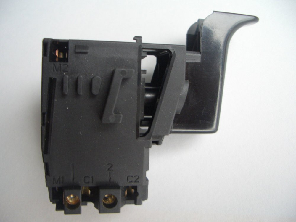

this is only for testing purposes to test the drill still works
this is for a bosch drill I let someone borrow it and it came back not working what im told is trigger smoked and bosch drills are renound for going faulty on there switches
what im wanting to do is bypass the switch just to make sure the drill is in working condition to buy a switch for it if not I will be buying a new drill otherwise id like to buy just the switch for it
the drill also has a variable speed trigger which this picture does not have on it closest i could find to my drill trigger
the drill is a bosch xcel pbh sds hammer drill
1 and 2 are the lives coming in from the plug 240v m1 and m2 are going to the drill itself
c1 and c2 are going to a supressor where a third wire goes to the drill
