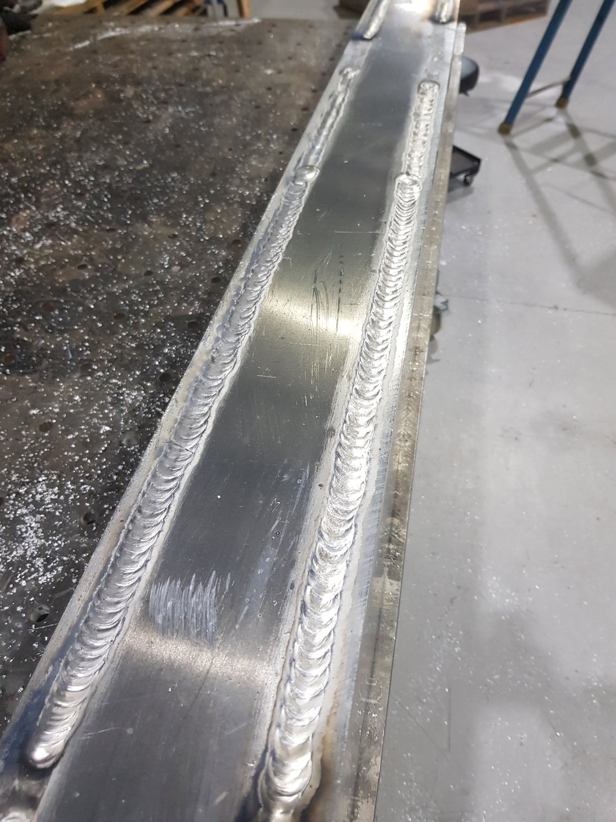

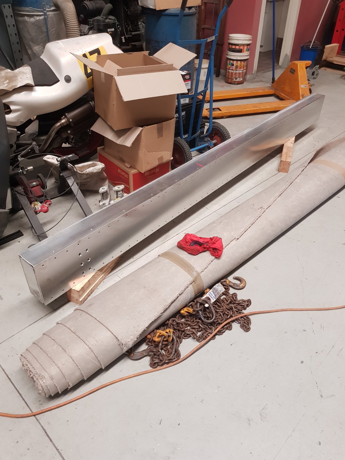

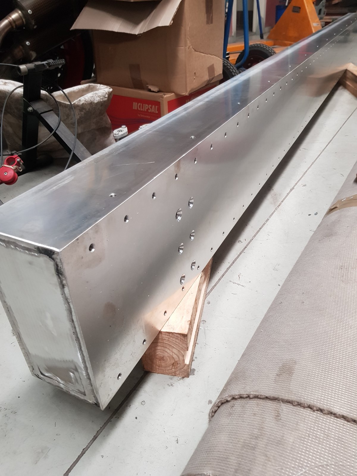

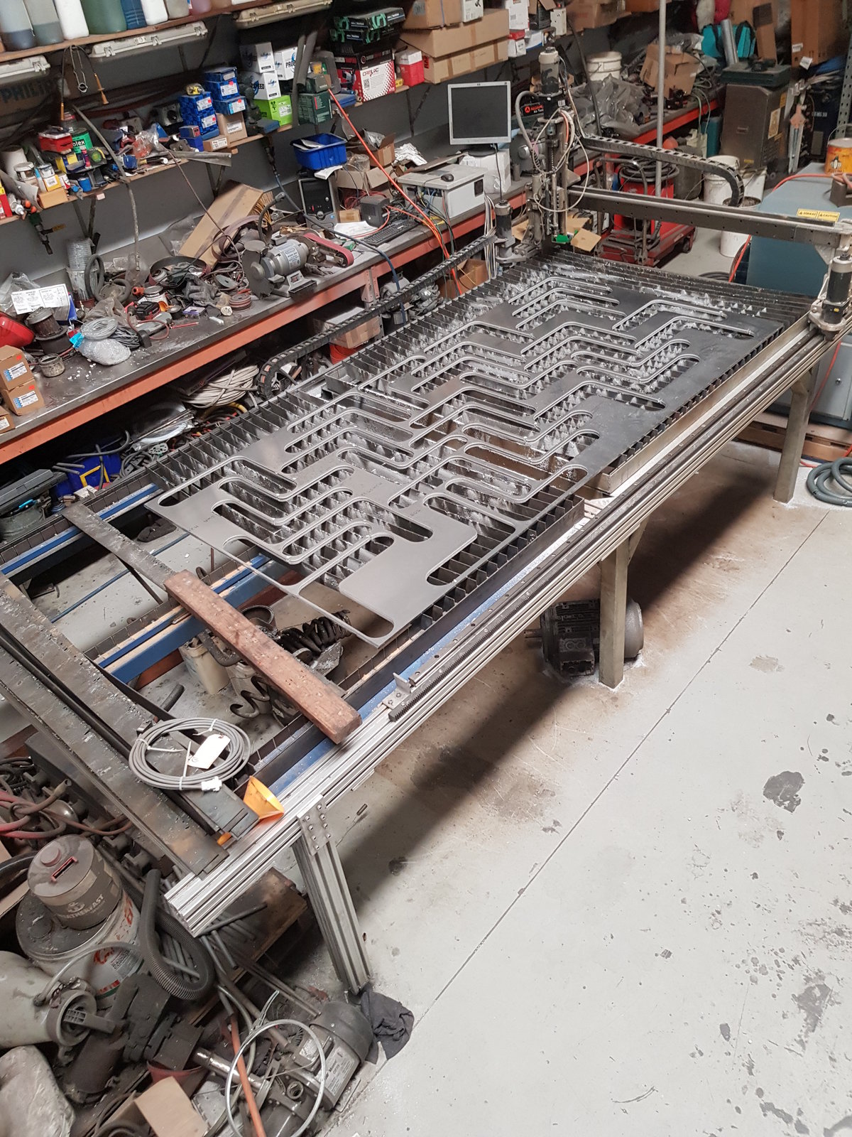

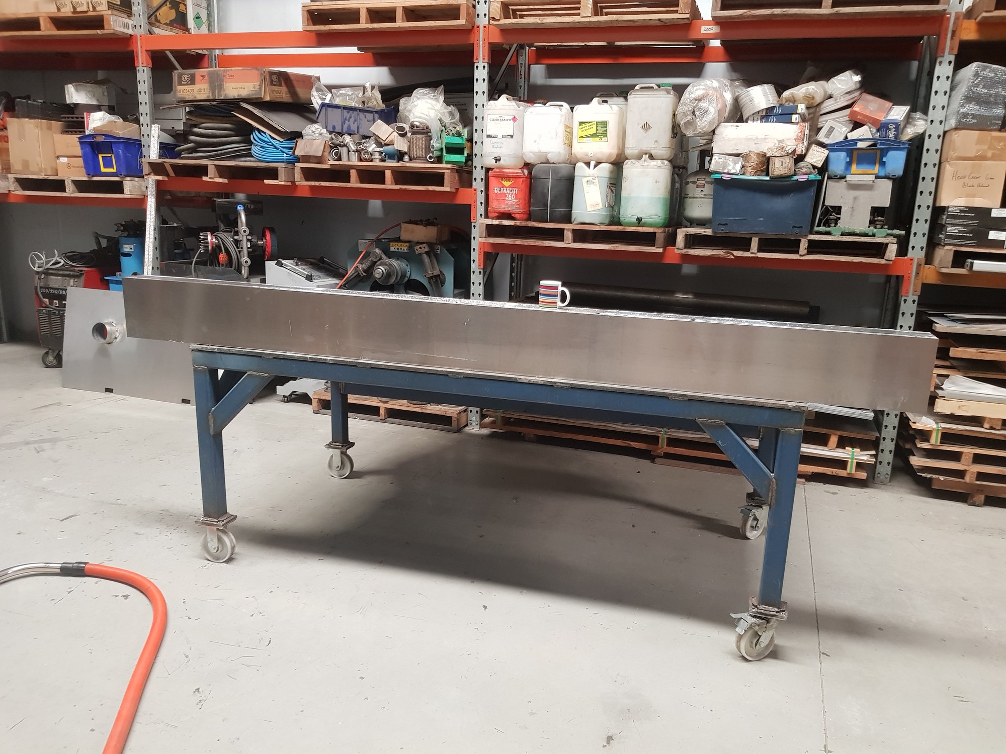

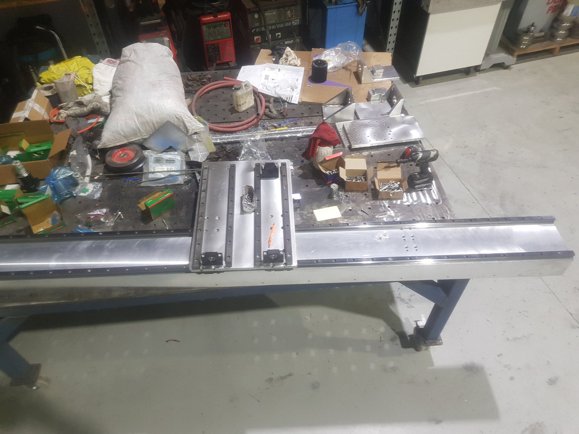

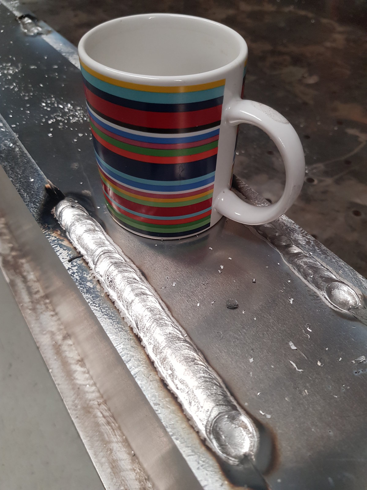

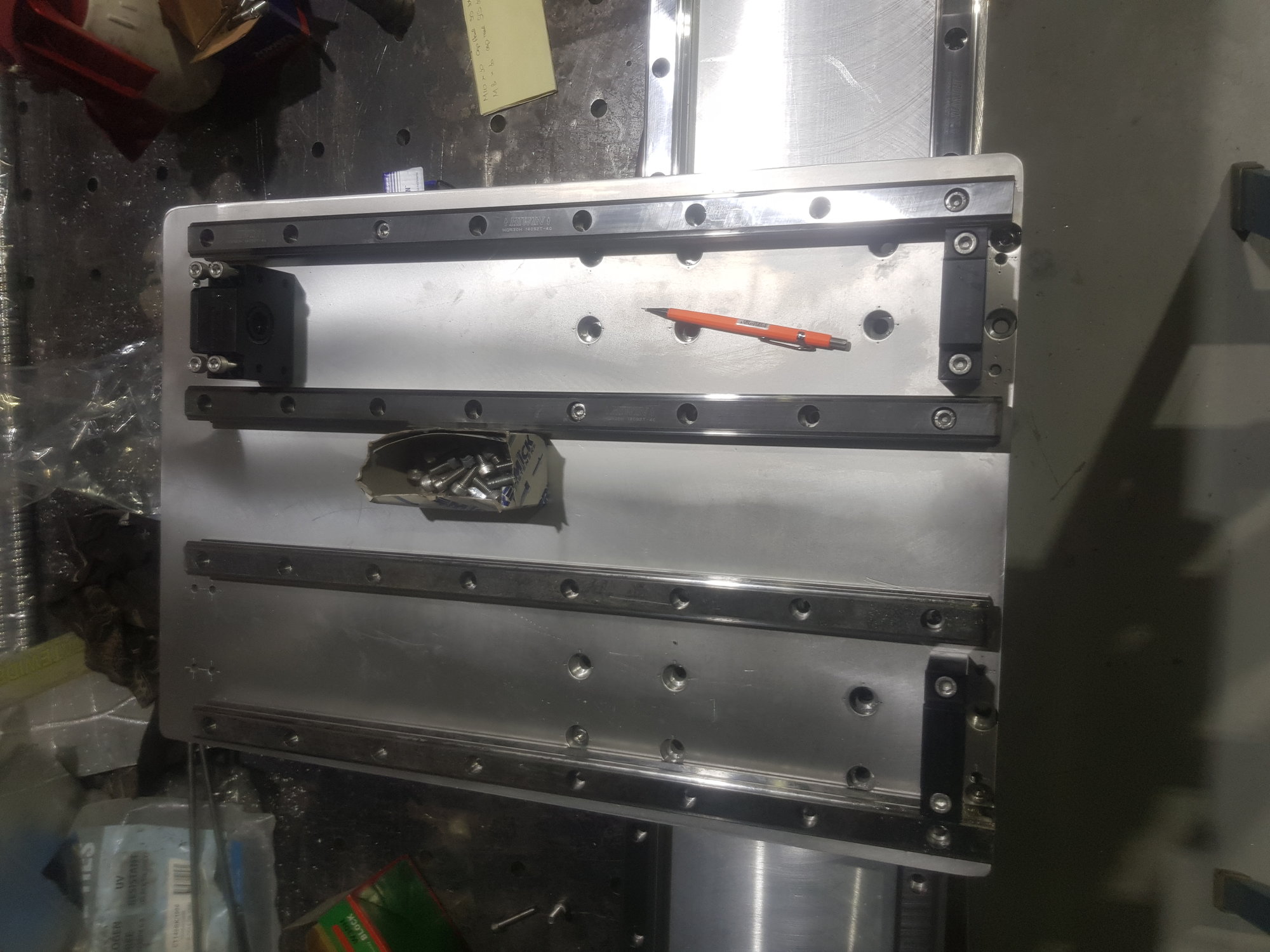

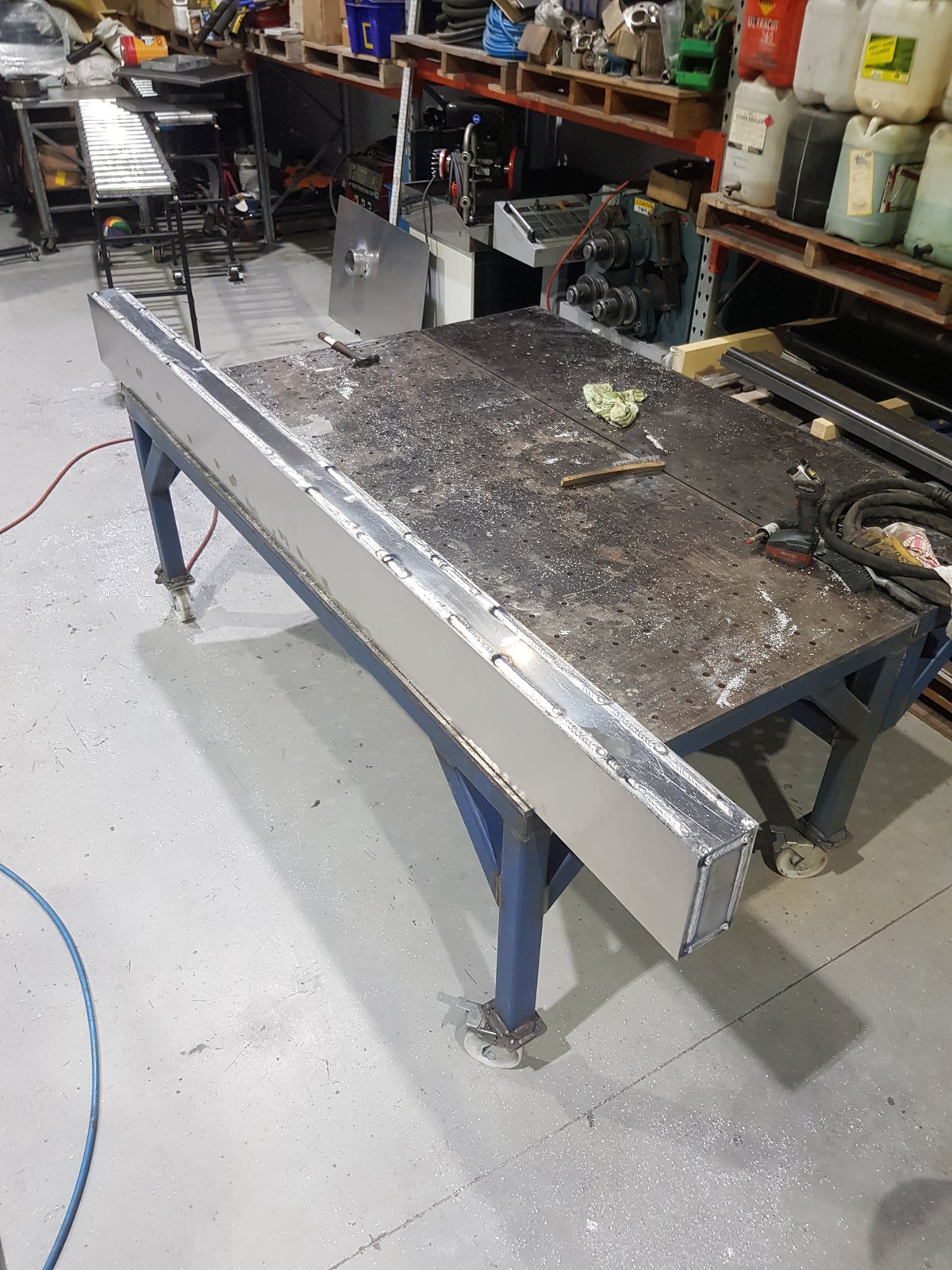

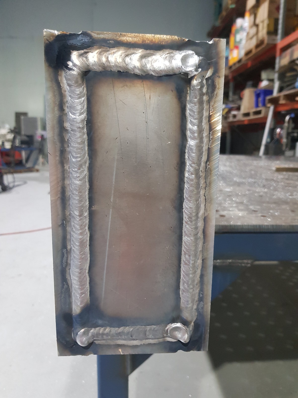

Have been contemplating this for a while now and would have been handy several times, so here goes. Stage one and then the addition (stage two) will be replaced by what I hope will be the last redevelopment. Table working length will now be 6.6m long and 2m wide. Will have a dual 'Z' axis with both plasma, penumatic scribe, and USB microscope for scananything on one. The second 'Z'axis (both 'Z' axis will be on the same 'Y' axis carriage) will have the machine spindle with the MQL system for routing and flat bed milling. Further to that there will be a rotary axis which will have the capability to rotate up to 400mm diameter and 8m long
. Lets hope I get this right
