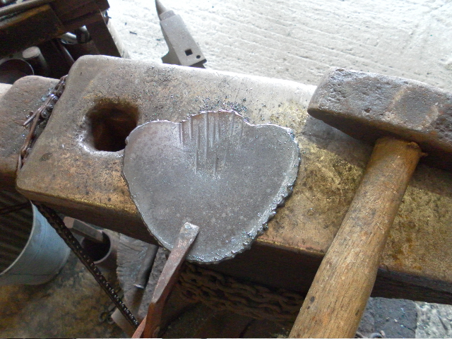

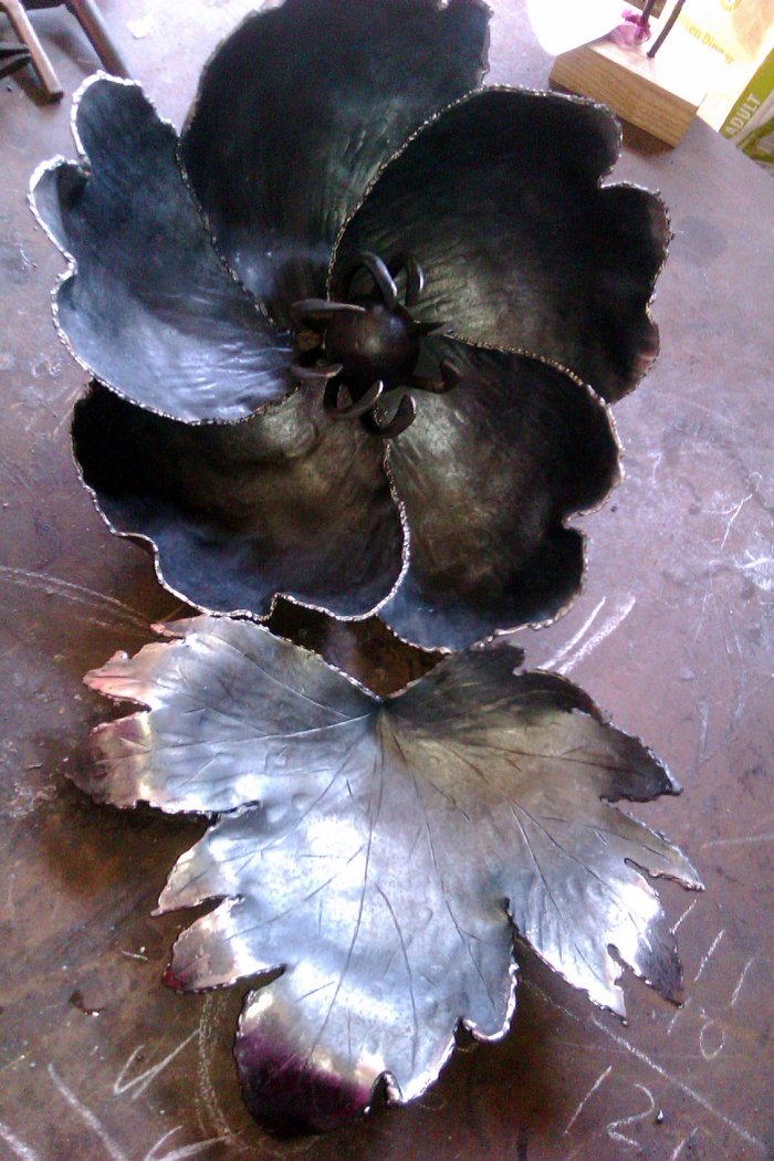

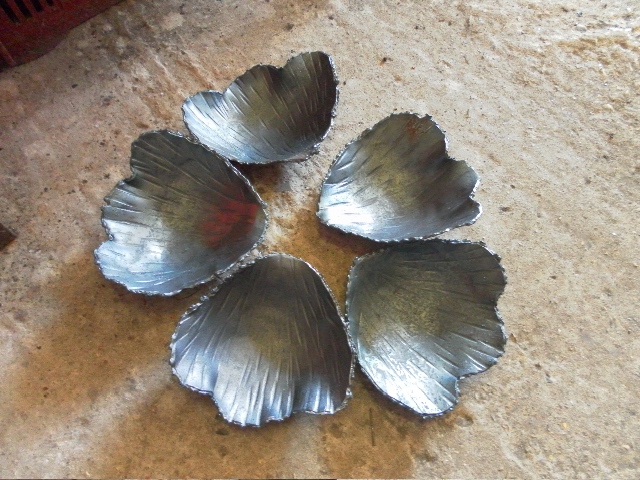

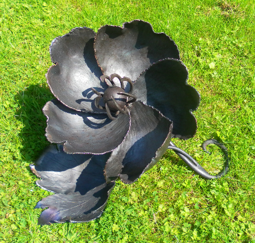

A recent project, a buttercup.

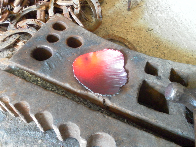

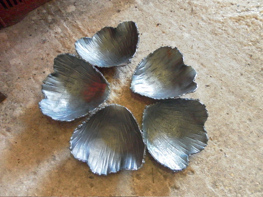

Petals and leaf made from oxy/fuel cut 2mm sheet, forged, centre is a steel ball, with some 6mm rod forged into stamens. Still got to make a stem for the leaf and weld it all together and finish it. Not decided yet on a finish. Thanks for looking
