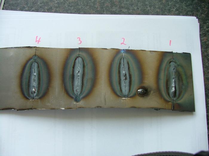

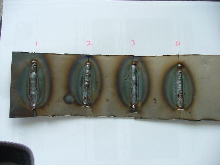

# 3 looks the biz of the bunch on the face side, not too hot with pene tho on the root side, it looks a thinnish piece of sheet, try using a copper backing plate, or better still, a ceramic tile!
Getting there though, good stuff.............no brown stuff either!
Evening weldequip, what gas do you think the lad is using??? From a previous post the lad mentions gas flow rate, not gas type, I just assumed ar/co2 was gas spec. Serious question tho, what shielding do you reckon is being used from your observations, interested mind asks?
Ah of course with the high profile, I now also note not a lot of spatter, another characteristic of using co2, last time I used yon stuff was many years ago and, I seem to remember the use of a heater was required also?
