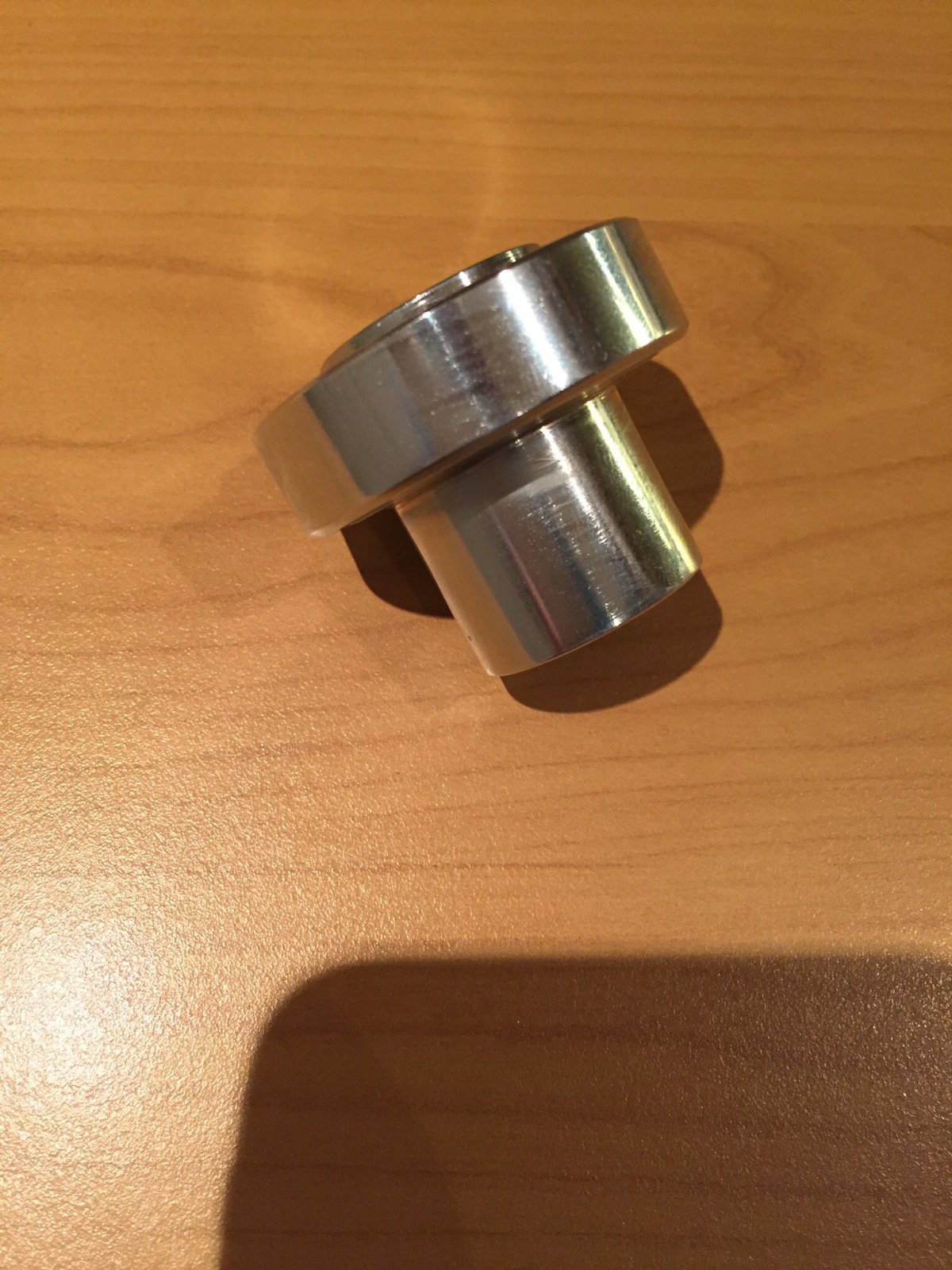

I started zinc plating some of the brackets, and terrible results. This is today's attempt, on one side there is a dull area in the centre implying no plating there and on the other side there's two serious burn marks. I've generally been getting such results recently, odd because I did my gearbox flange when I first got the kit and it came out perfect.
The part is dull as I haven't added brightener and the part has a rough finish.
My procedure went like this:
1. Sand blast part
2. Phosphoric acid dip to remove old zinc, until stopped bubbling
3. Pressure wash
4. Cold caustic soda 5 min
5. Pressure wash
6. Acid pickle 1 min
7. Pressure wash
8. Into zinc-nickel electroplating tank with water agitation, temp 22 C
9. Wait 10 minutes, check part, see burn marks, give up.
10. Rinse
I read somewhere on this forum of someone else saying that irregular parts gave them bad results.
I calculated the surface area and set the current to 0.07A per sq. inch, a bit low I know, as I wanted to be sure I wasn't getting bad results because of high current.
