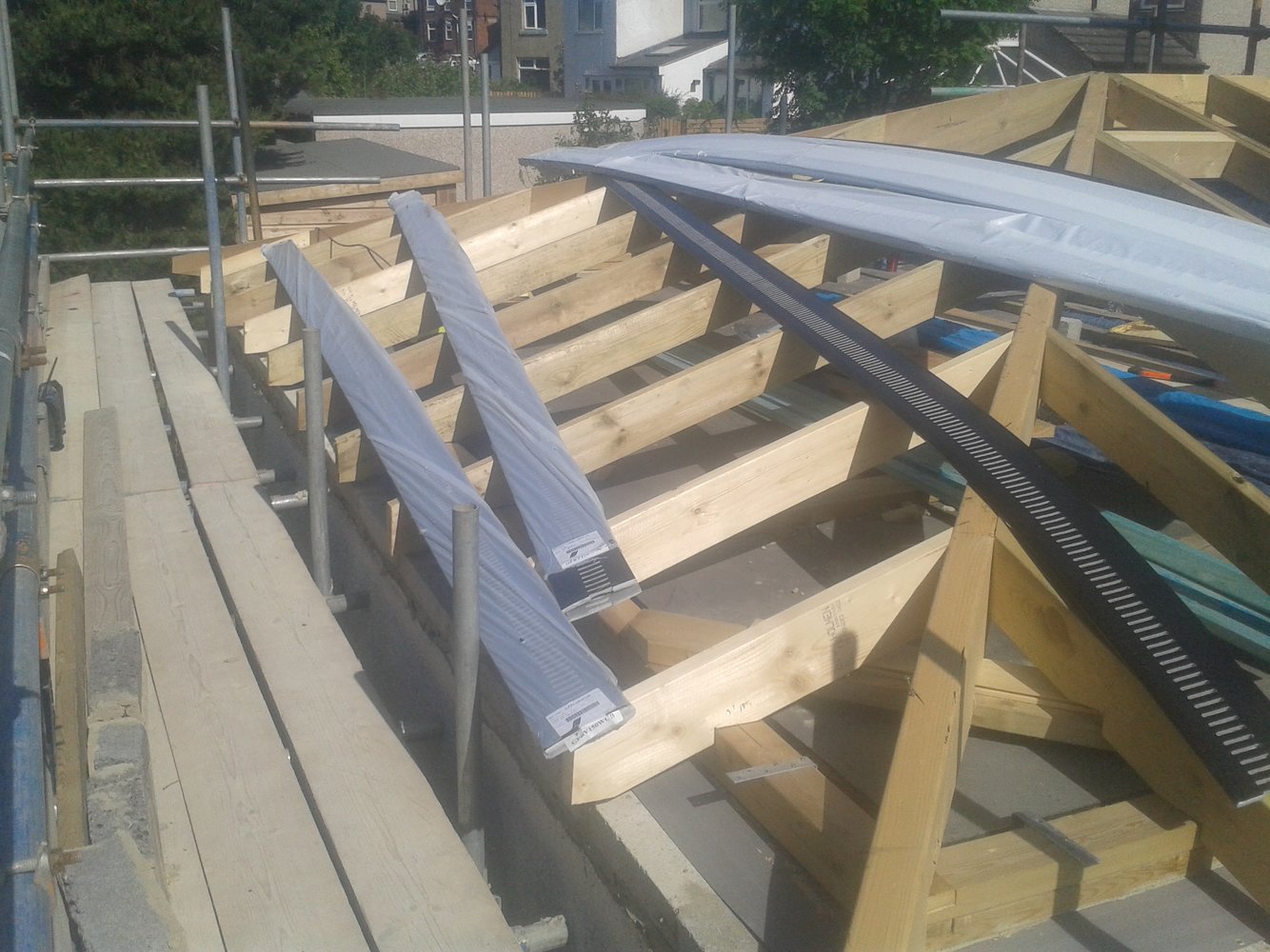

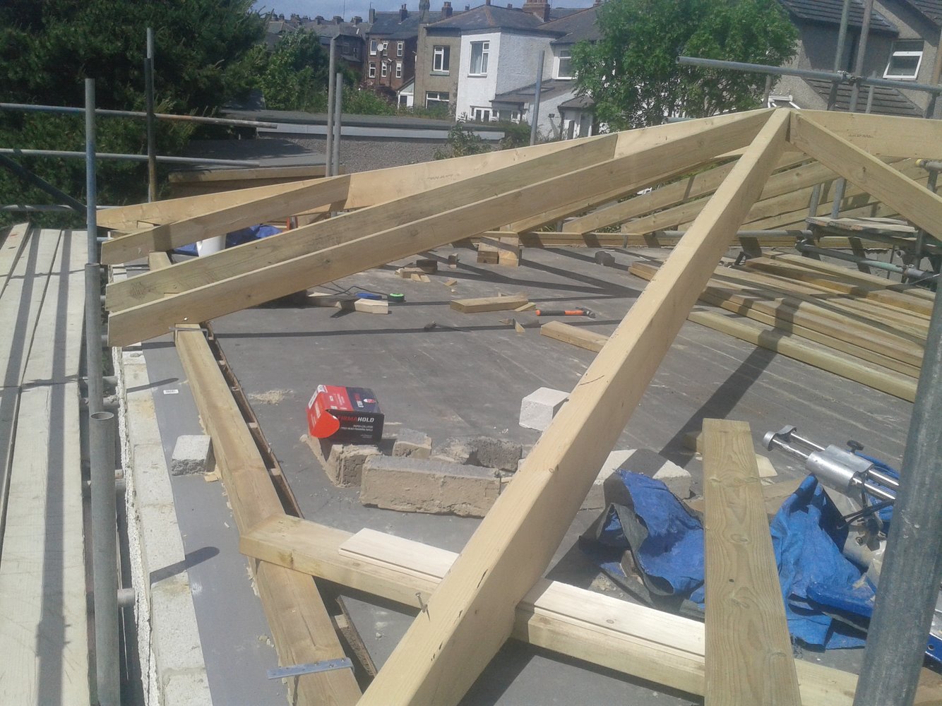

@brightspark picked up when I removed ceiling joists and was questioning how I stopped the roof spreading. I basically put the ceiling joists back (there's also other structures that stop my roof spreading).

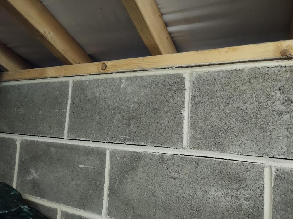

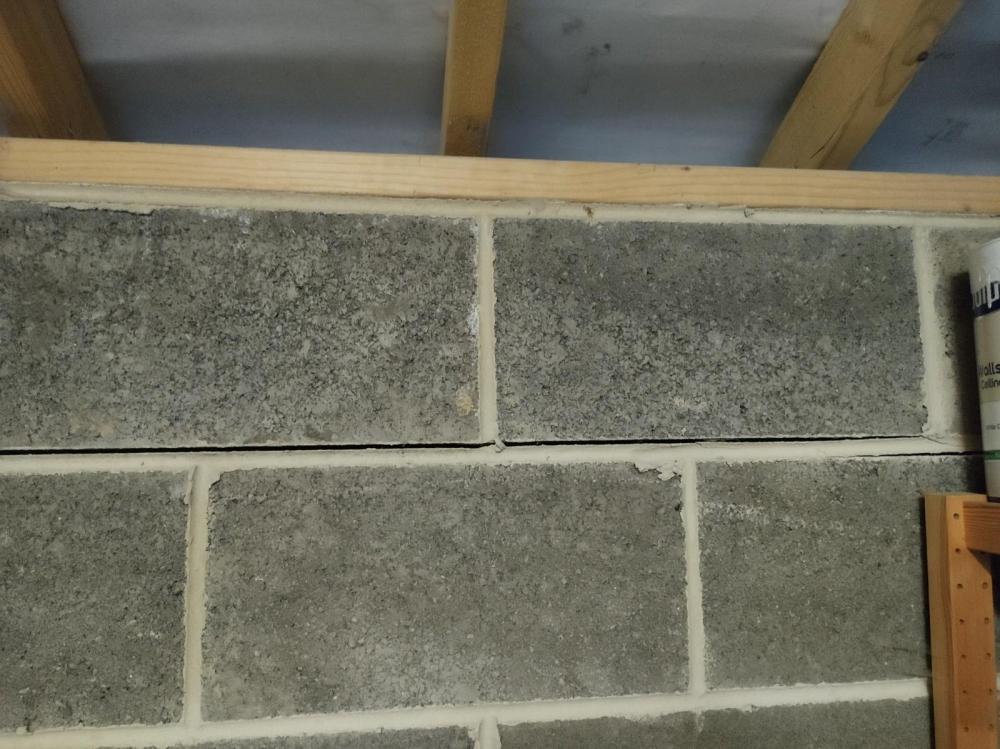

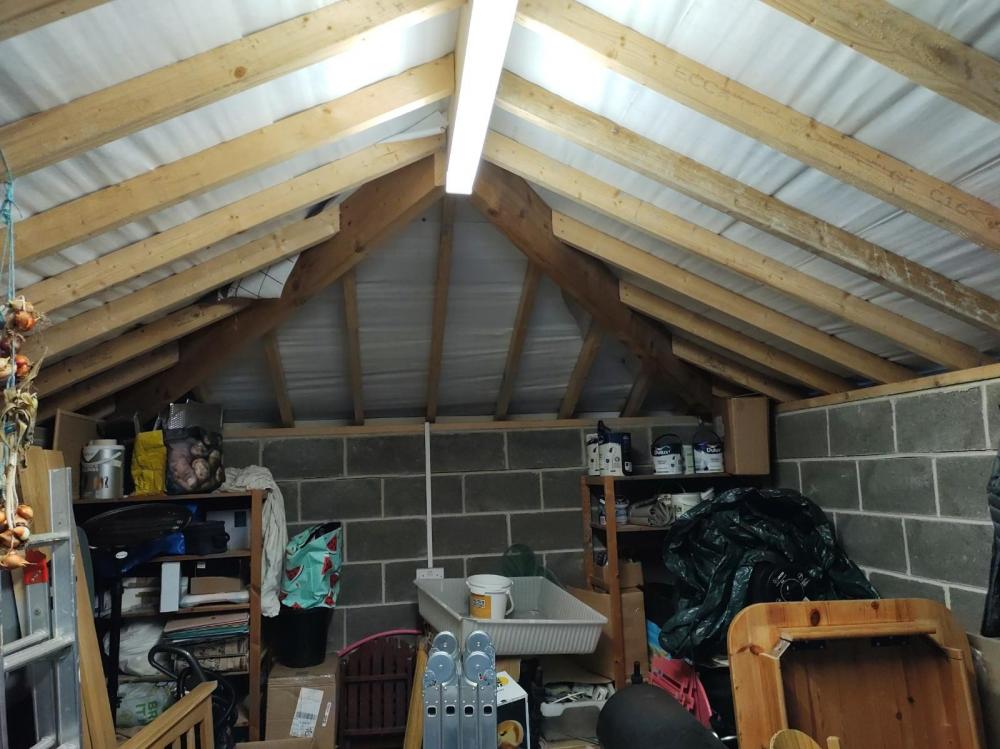

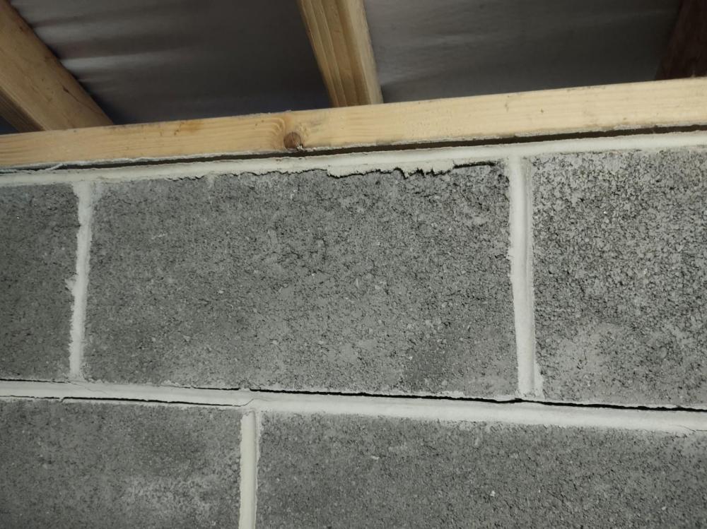

This though, from another public forum. Someone's garage. No ties so the roof is slumping and pushing out at least the top course.
