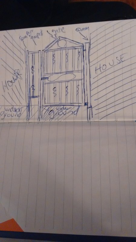

Between my house and next door is 1.3m and I've built my gate with 20mm box section 7ft high at its peak and is welded onto a 50mm box section post. The gate is 1m and have another piece made up with same box section with 250mm posts.
What I want to know, if I dig down 2 ft and fill in with post concrete will this be enough to hold the gate. You see, the 2 houses are old stone so don't want to go drilling holes into the walls in case I disturb them and bring damp through.
Another thing that concerns me, how will I be able to keep all this plumb if I cant attach it to the wall. Any suggestions?
