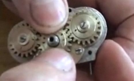

Yeah, he built it himself, he always does weird and wonderful engines, his last one was a W12 built out of 3 bike cylinder heads, 1400 supercharged bike engine, and he did a 2.0L V12 before that, along with a few screaming V/I6's to boot.
Ah ha I scrolled down, and here's his own translation
v-12 engine with compressed air injection,hand made using taditional methods:12 cm3 of displacement,the diameter of the cyllinder is 11,3 mm,the stroke of the pistons 10mm,it works with only 0,1kg/cm2.Is constructed with stainless steel,aluminum and bronze.Patelo dedicate this engine to his grandchildren:Sara,Carmen,Jose and Pablo.This engine is for education,exhibitons,etc.,that is the reason to work with compressed air, to avoid contamination.He has made the plans and all parts, except the screws.The engine is not for sale.Thanks to everybody for the comments and sorry for my bad English.
