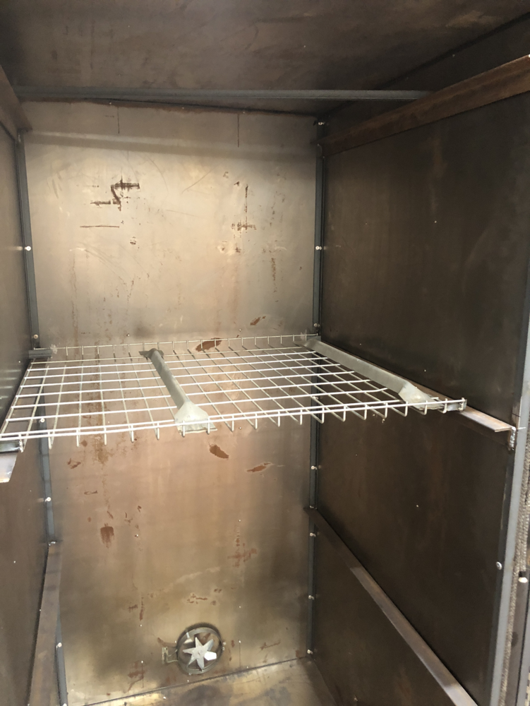

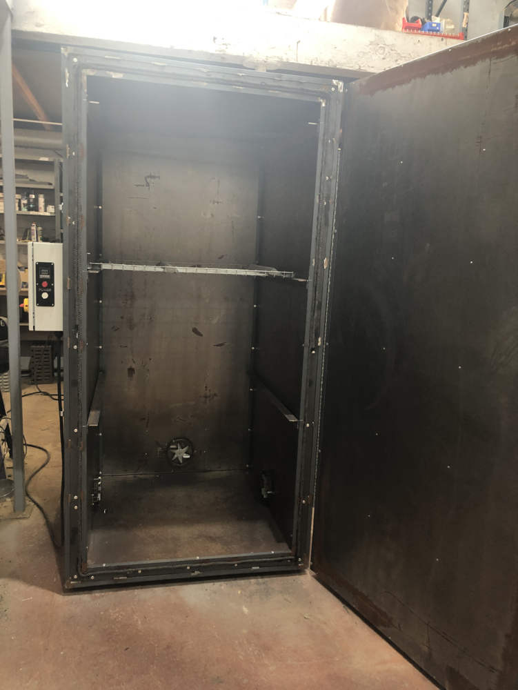

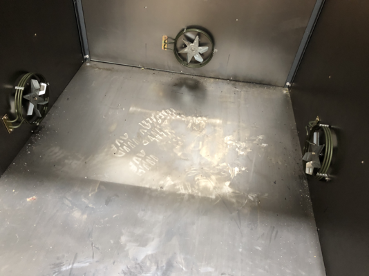

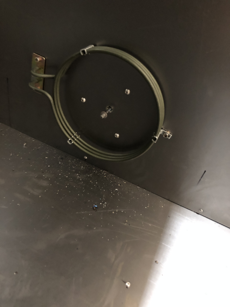

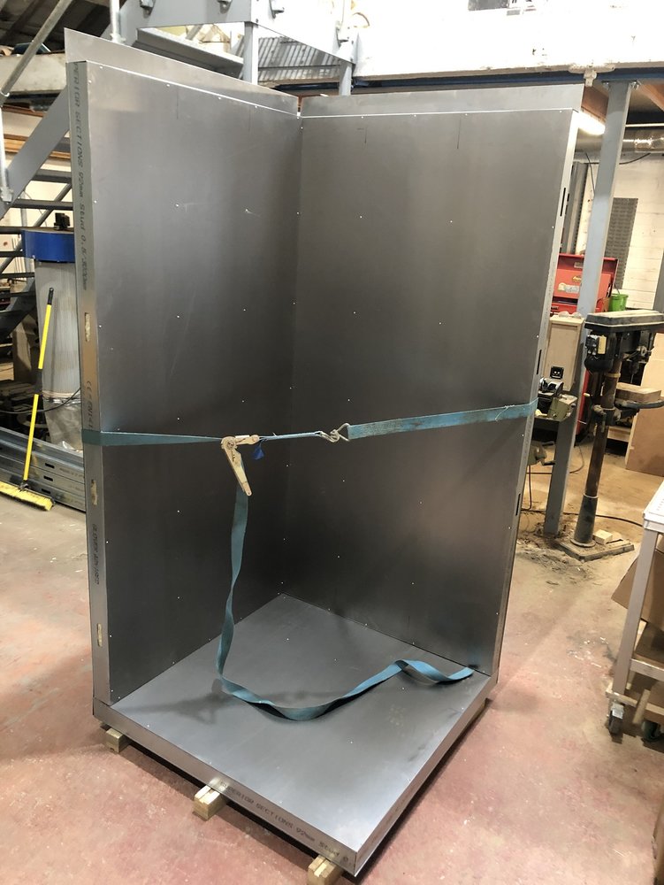

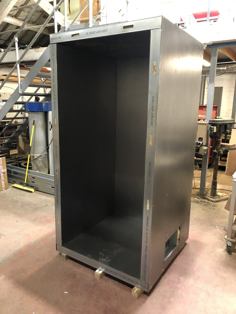

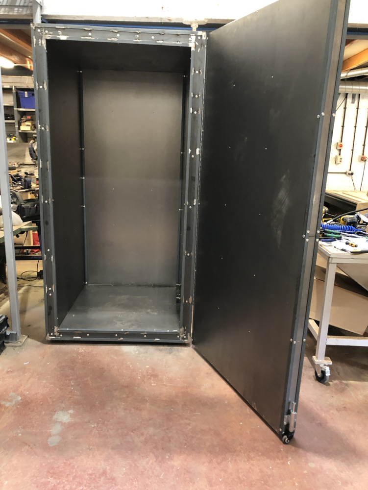

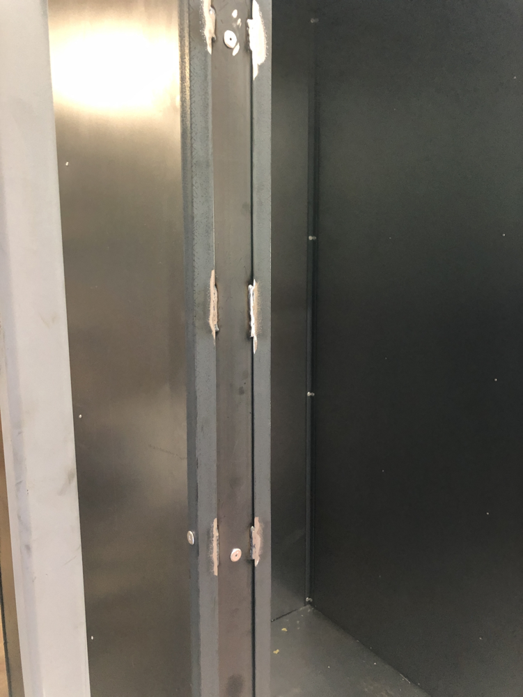

This is slowly moving towards completion.

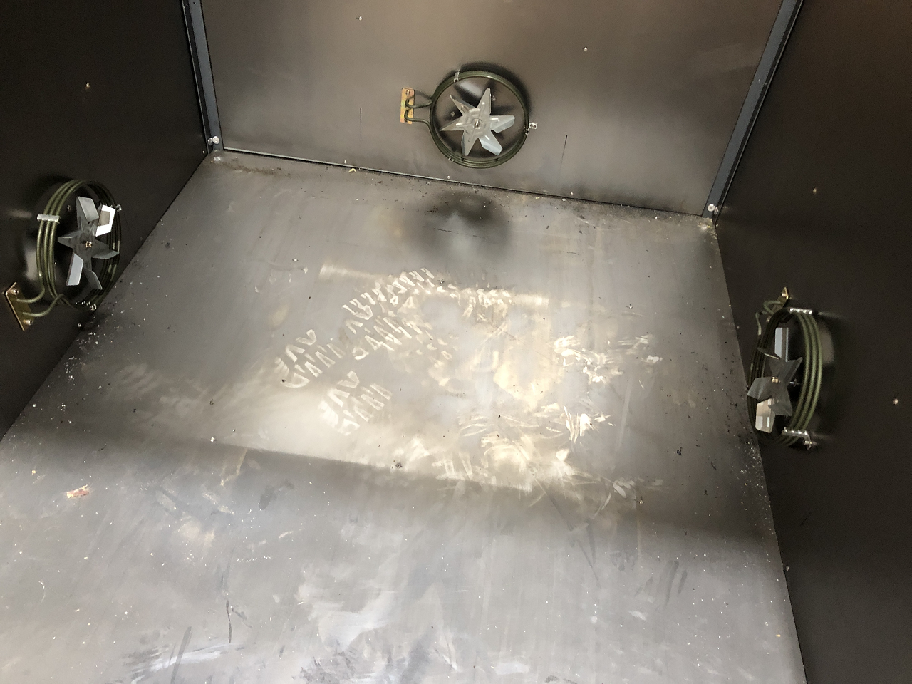

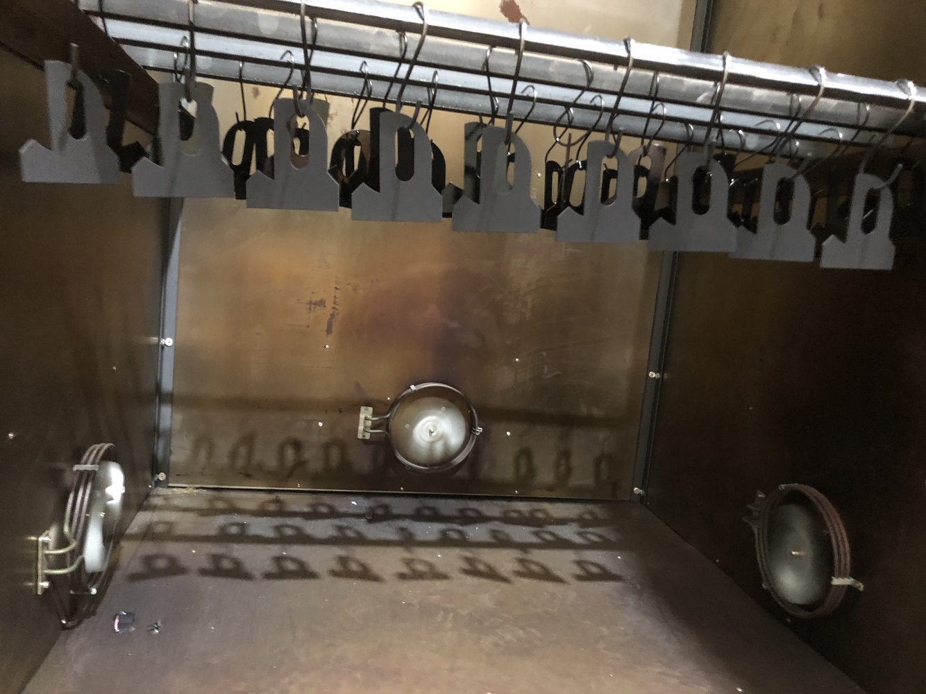

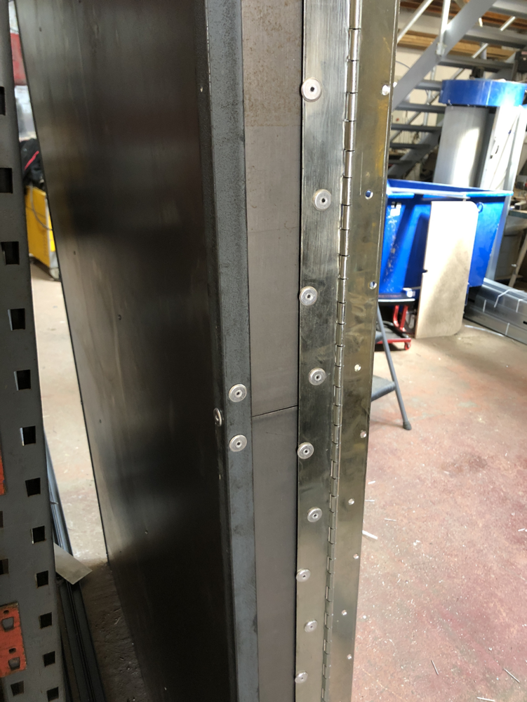

I have mounted the door latches and handle, installed the two other elements and fans. The fire rope is now stuck around the door frame with high temp sealant.

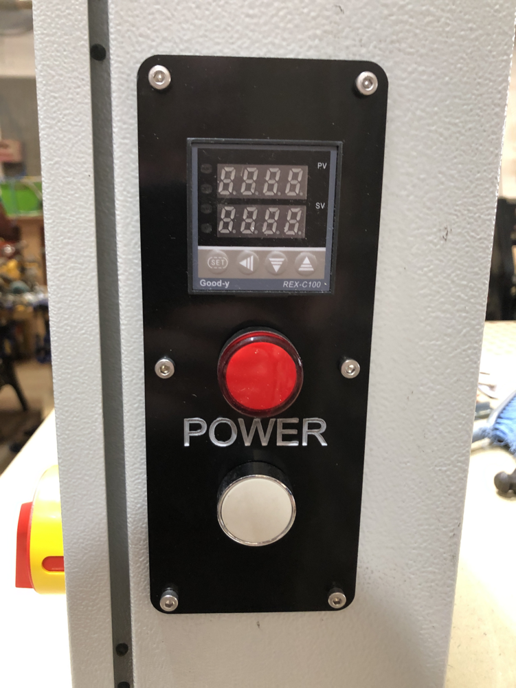

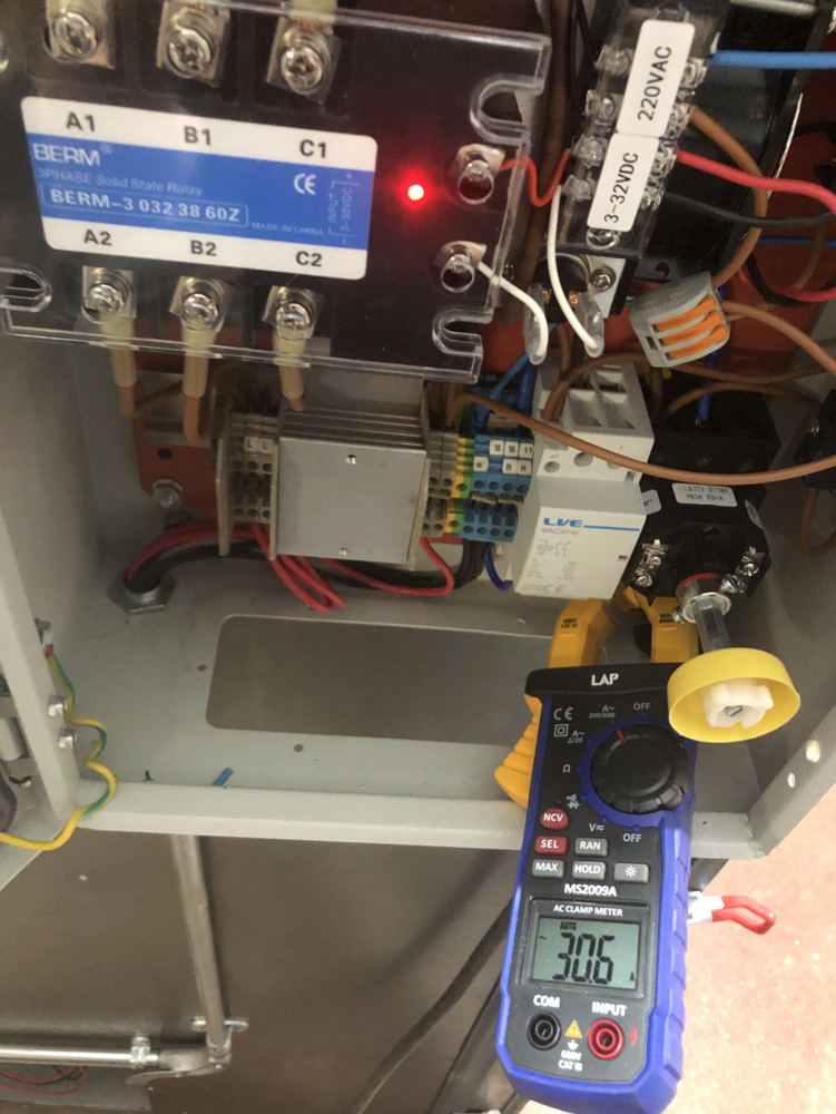

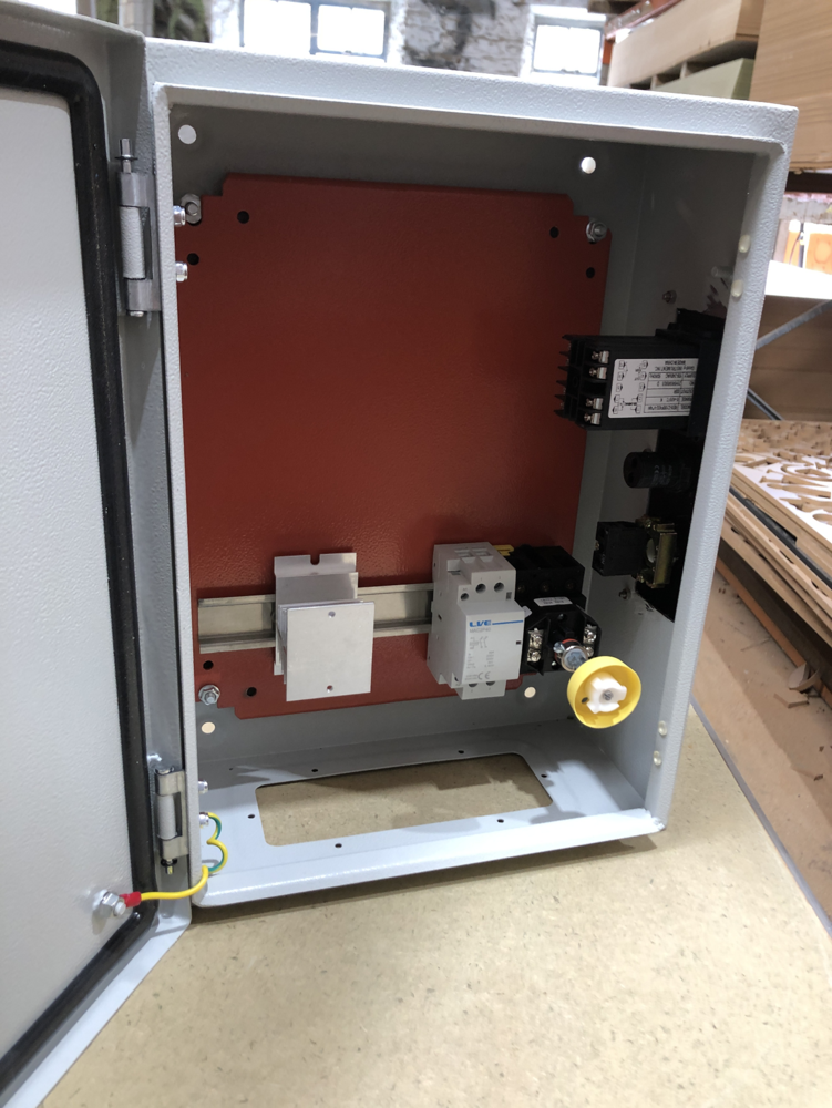

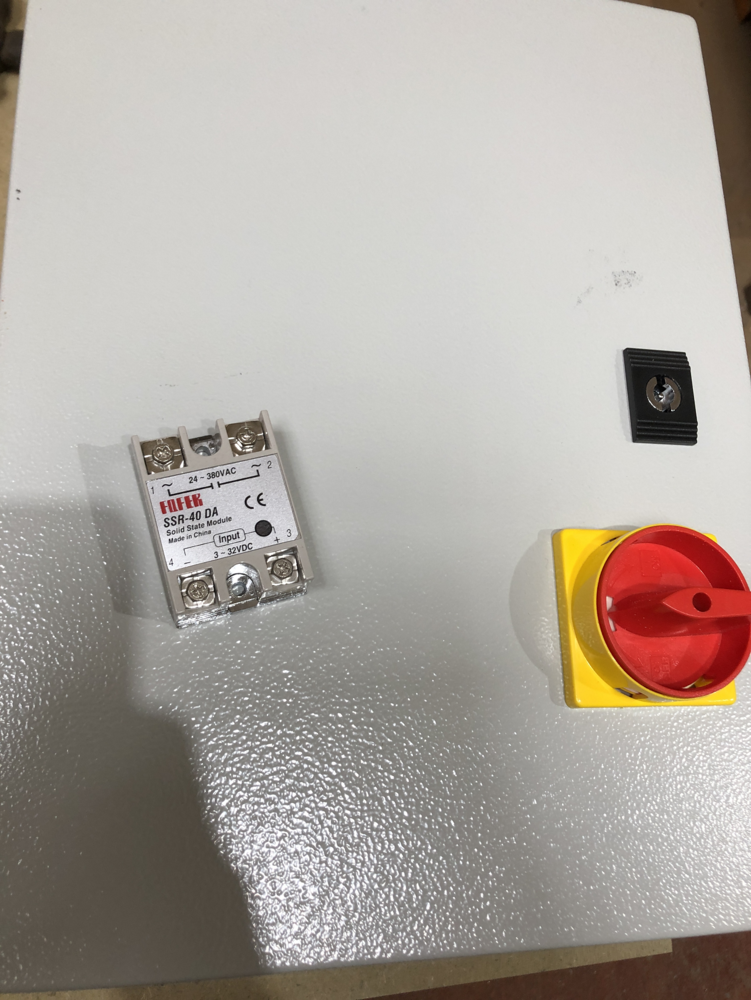

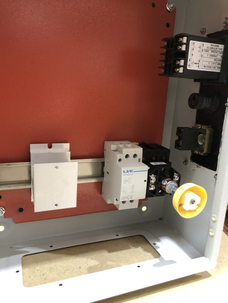

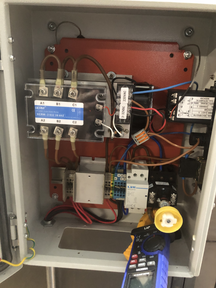

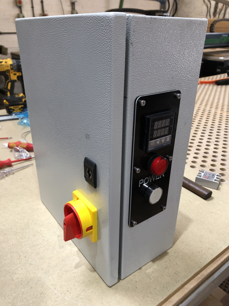

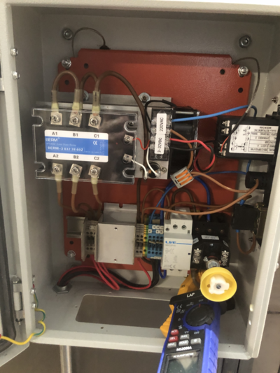

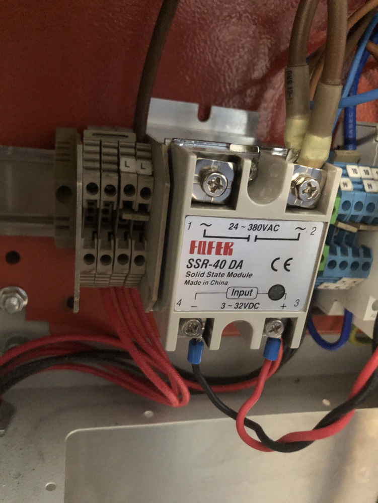

I'm now looking at the control gear. I have a metal enclosure, PID controller and SSR plus a contactor and switch gear.

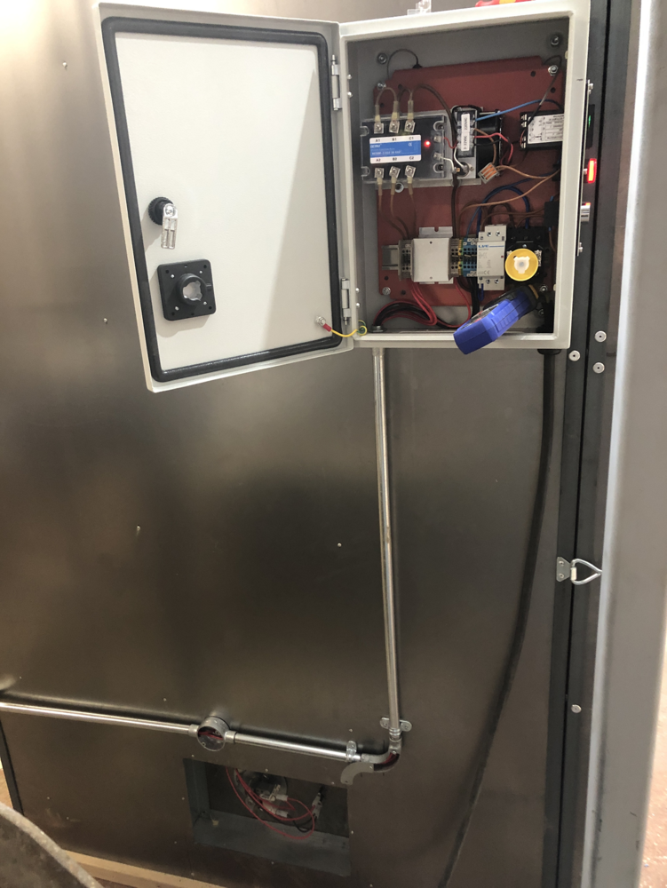

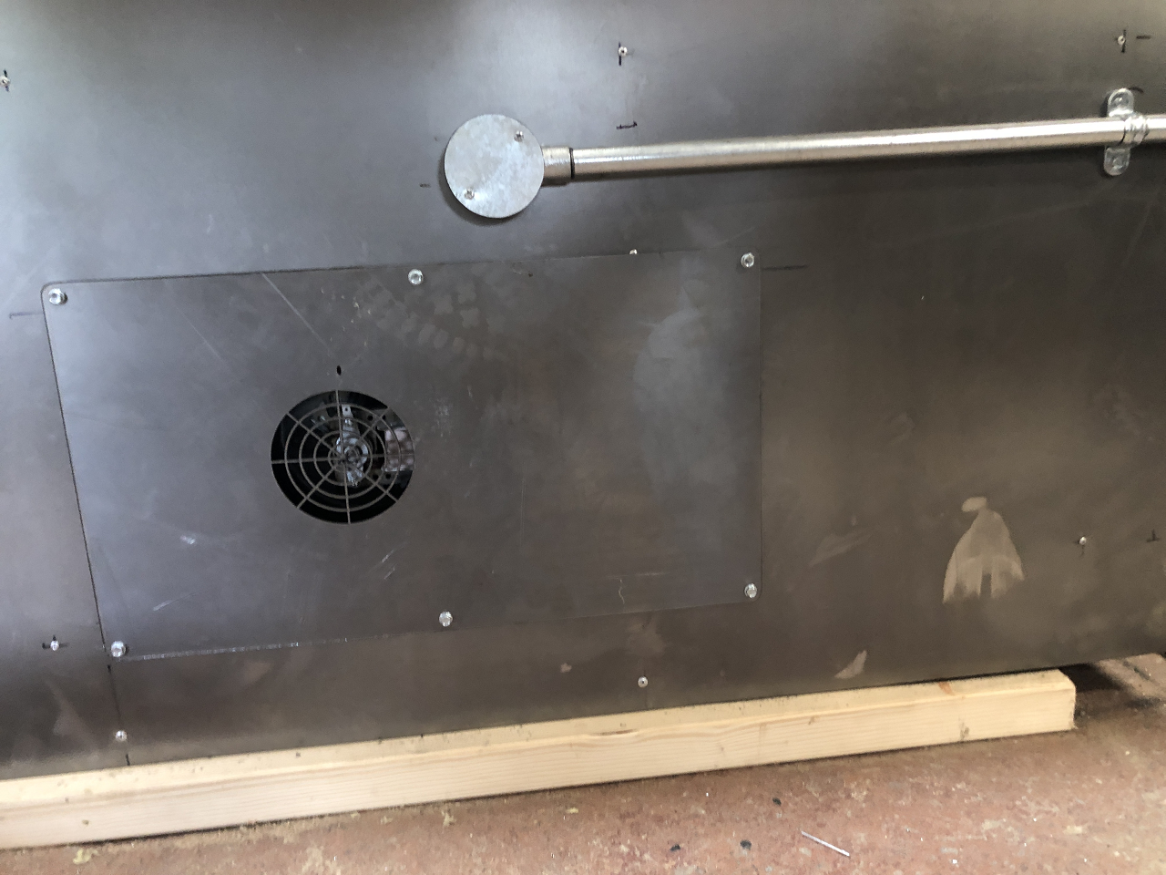

I just need to figure out what conduit to run on the outside of the oven to take power to the three elements.
Plastic would probably be fine but without jury rigging the elements I can't be sure.
Going to look a small metal conduit now.

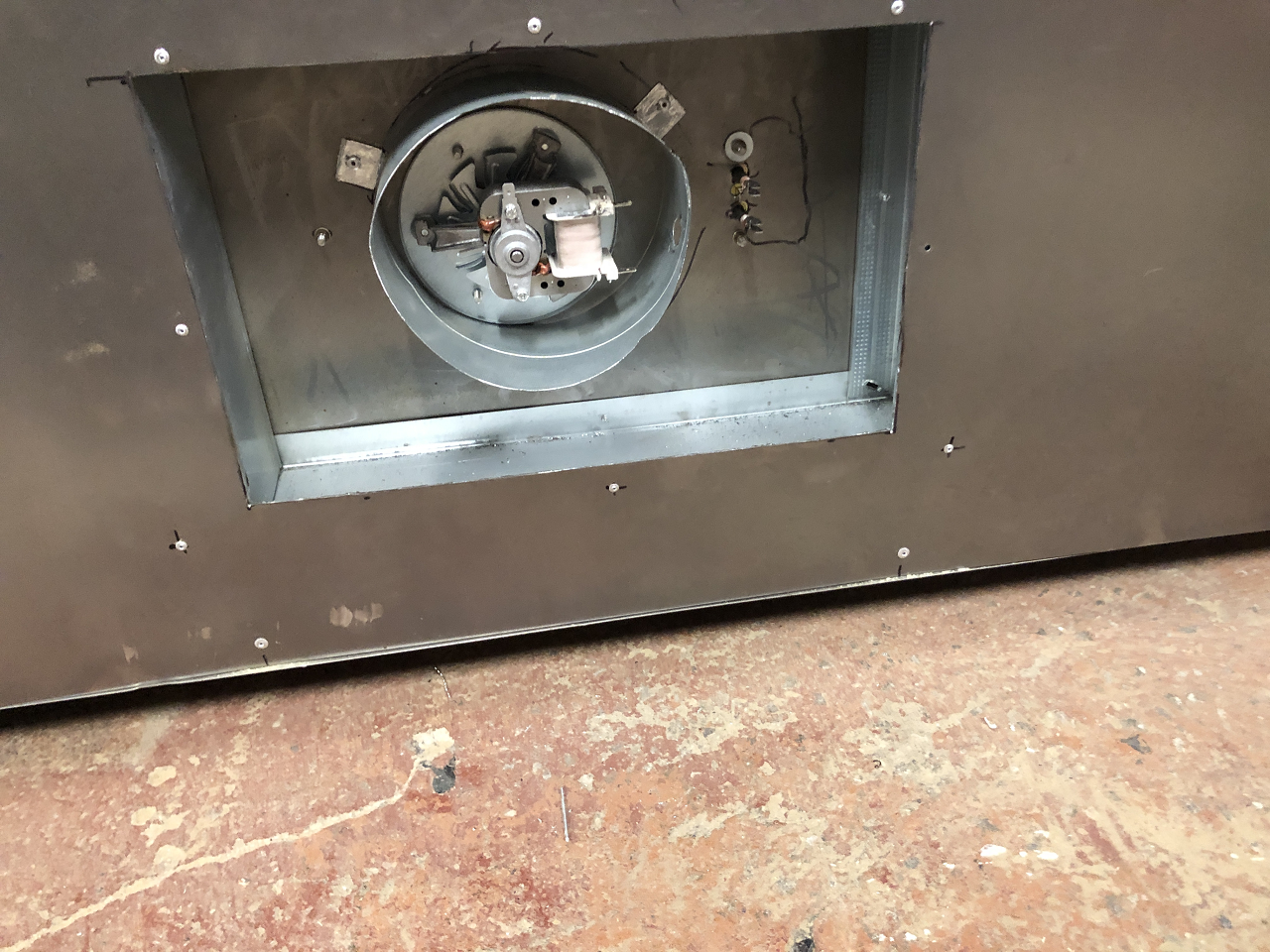

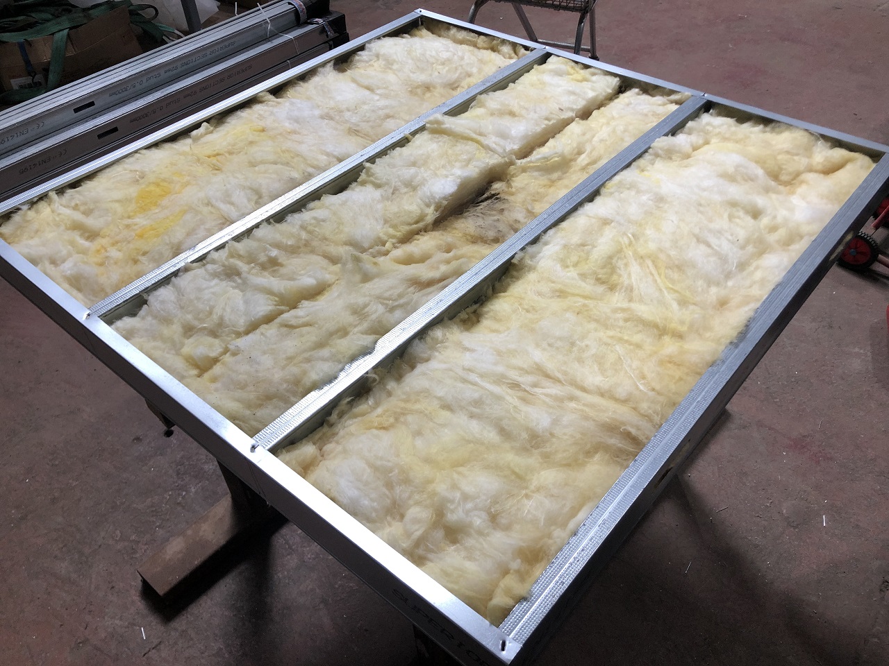

The fan motors have a shroud made from a bit of spiral duct, this means I can pack the enclosure with insulation once the wiring is done.
