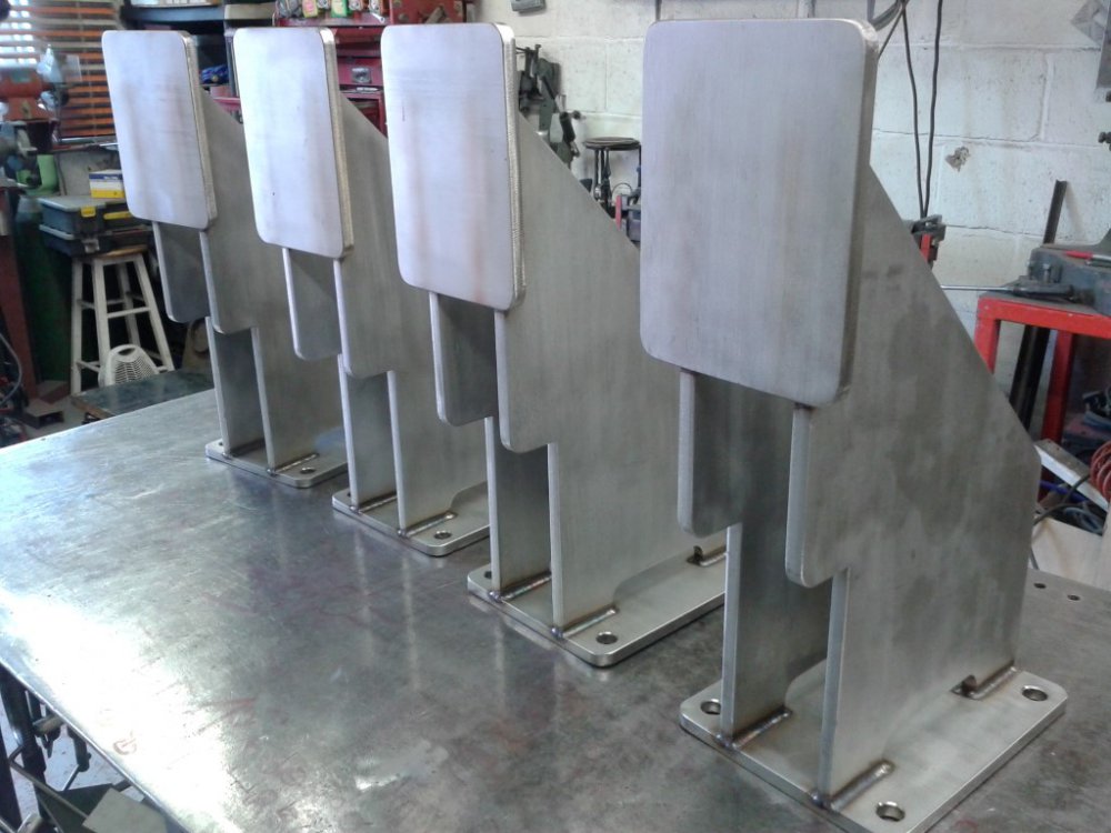

I think there may already be a picture of these on here somewhere, its a job that comes up from time to time, buffers to restrict the movement of a mobile but heavy machine.

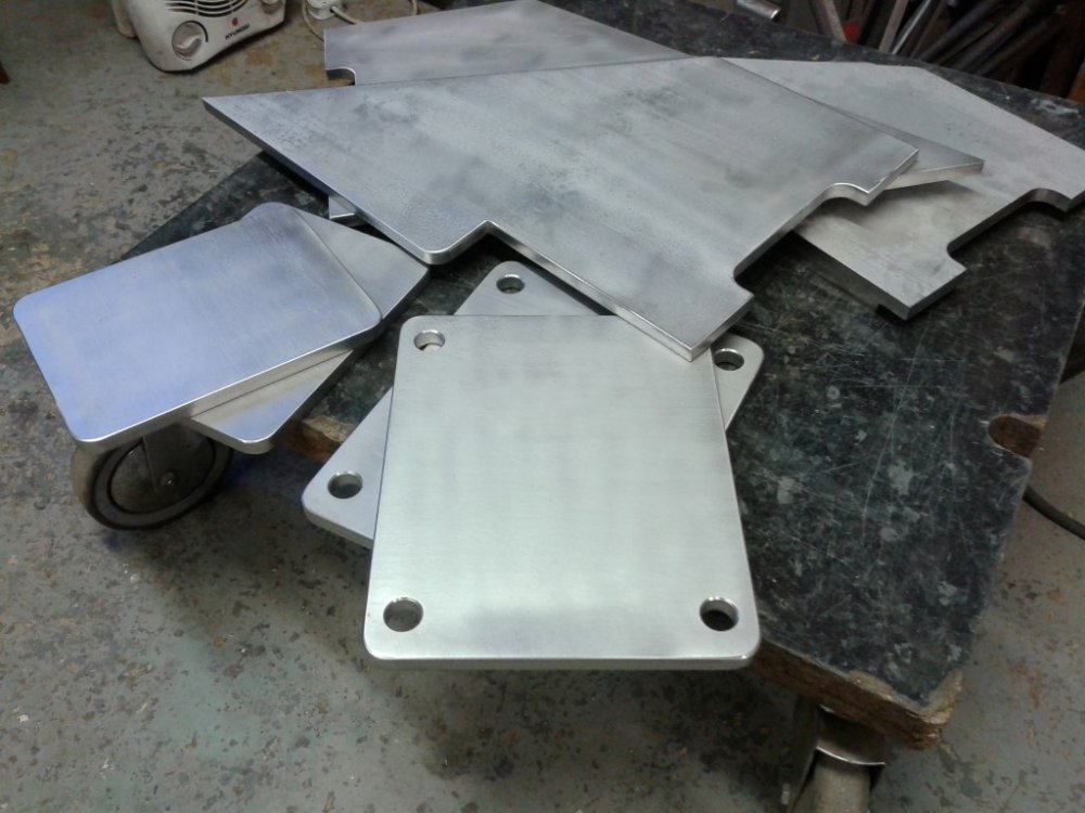

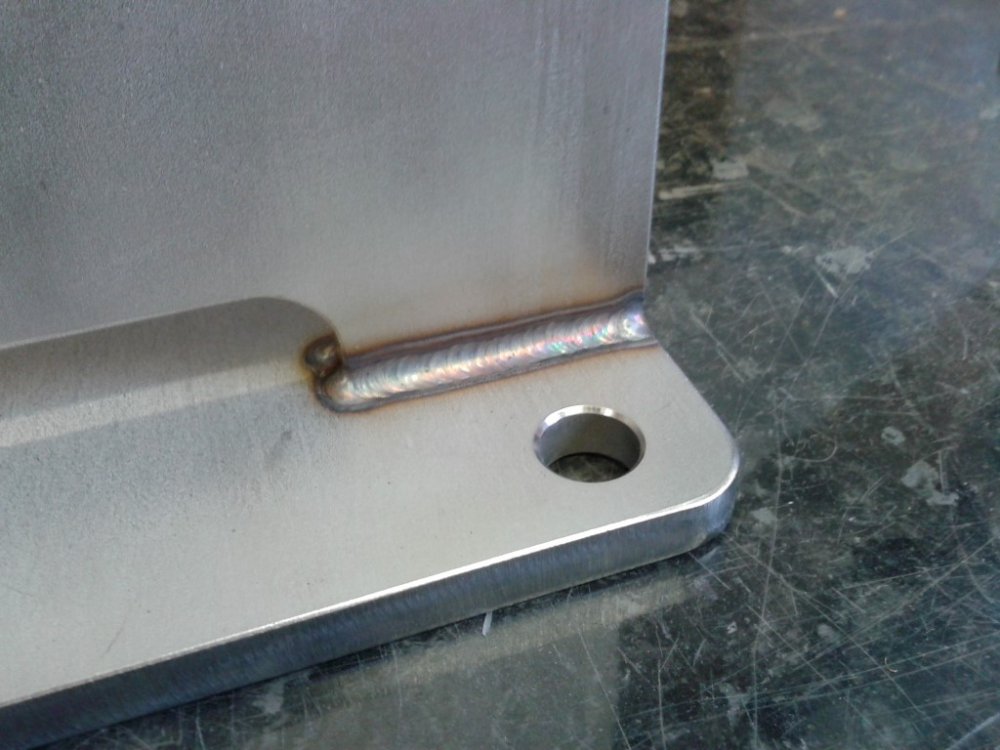

12mm laser cut stainless plates, here they have had a clean up, sharp edges removed and holes deburred

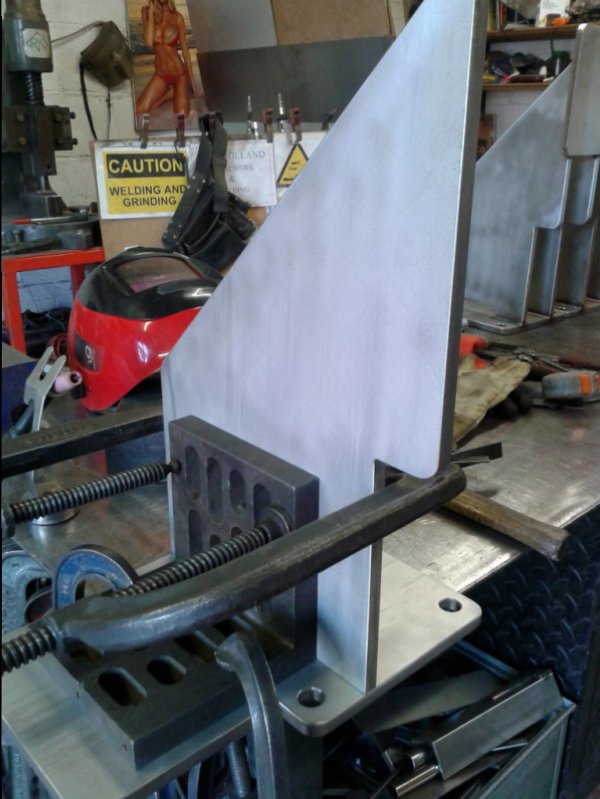

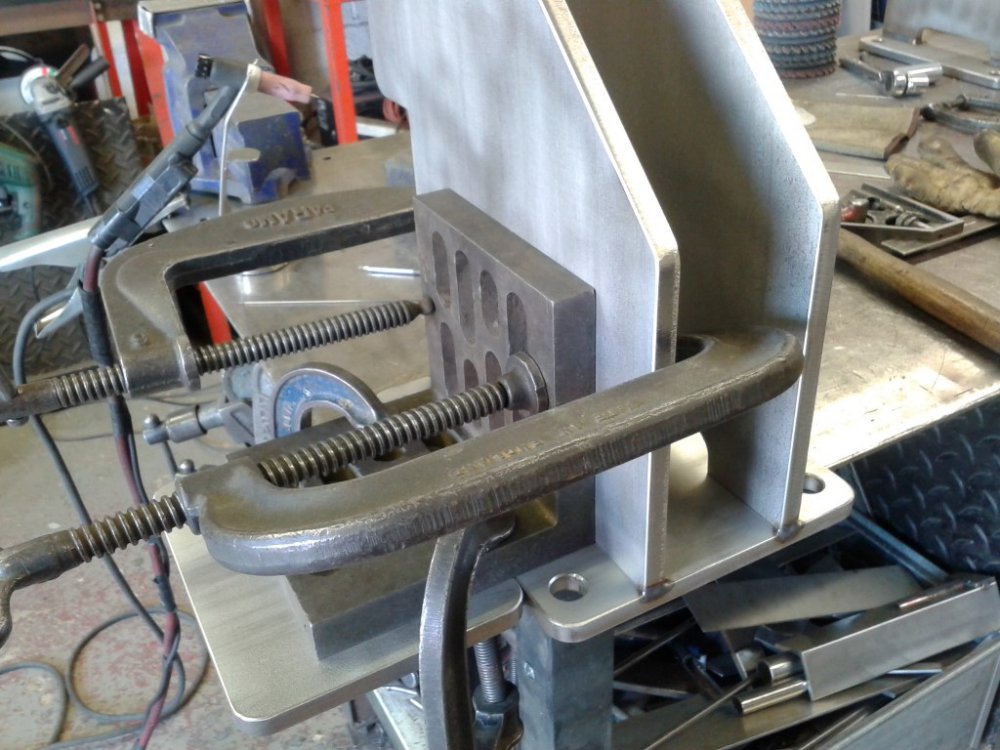

Fabbing them up, the angle plate and a couple of clamps make it easy,

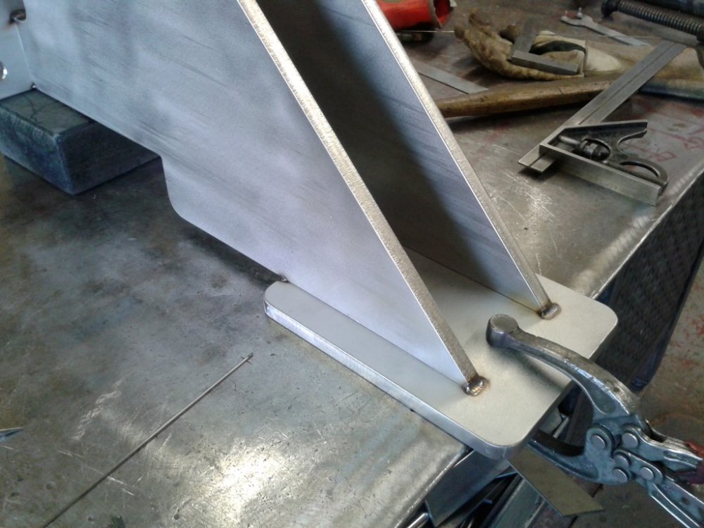

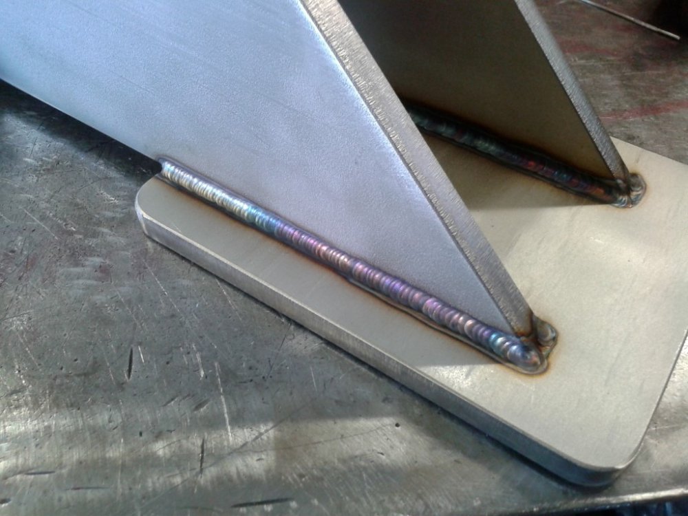

A couple of the welds

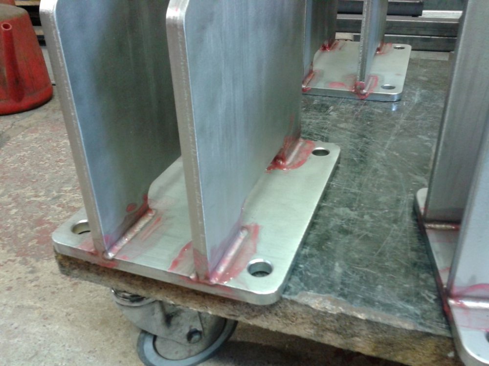

Ready for cleaning
Noxious chemicals in use here, makes light work of cleaning though
And what it does to the weld

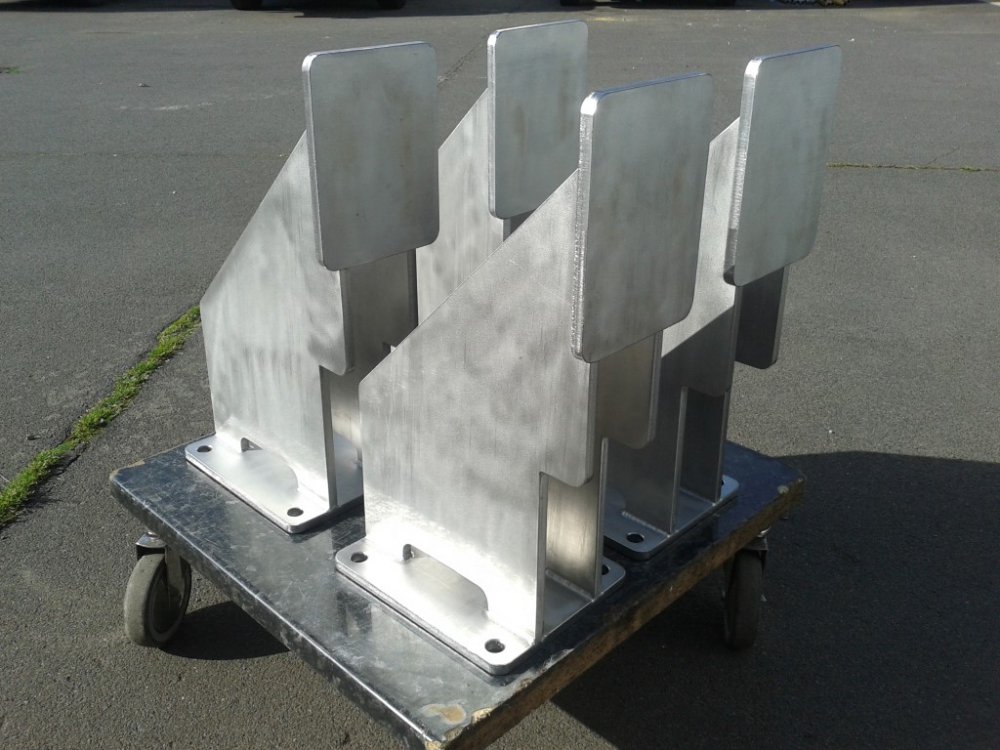

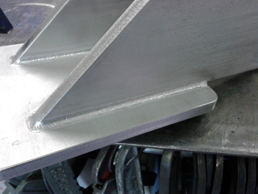

Ready to go, just the invoice to do and the jobs a good un
