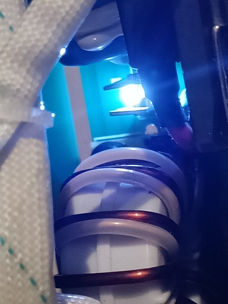

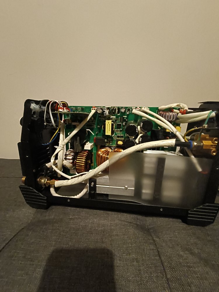

Hi, this is my second as the first was faulty for different reasons.
This one worked fine the first time I used it.
Today, the second time I went to use it the moment I turned power on to the machine there is an immediate buzz( continuous )and the air stays on to the hose indefinitely. Depressing the trigger has no effect.
The buzz is an arc pictured inside.
I cannot blow through the solenoid with no power and it's only when the power is turned on the airflow begins so I don't think it's been ceased open.
I'm not sure if a relay is stuck, energising the solenoid, hence the arc.
It's a few weeks old however I'd rather understand what the issue is rather than exchange the unit.
With the handset disconnected the issue remains so it's not a stuck trigger.
