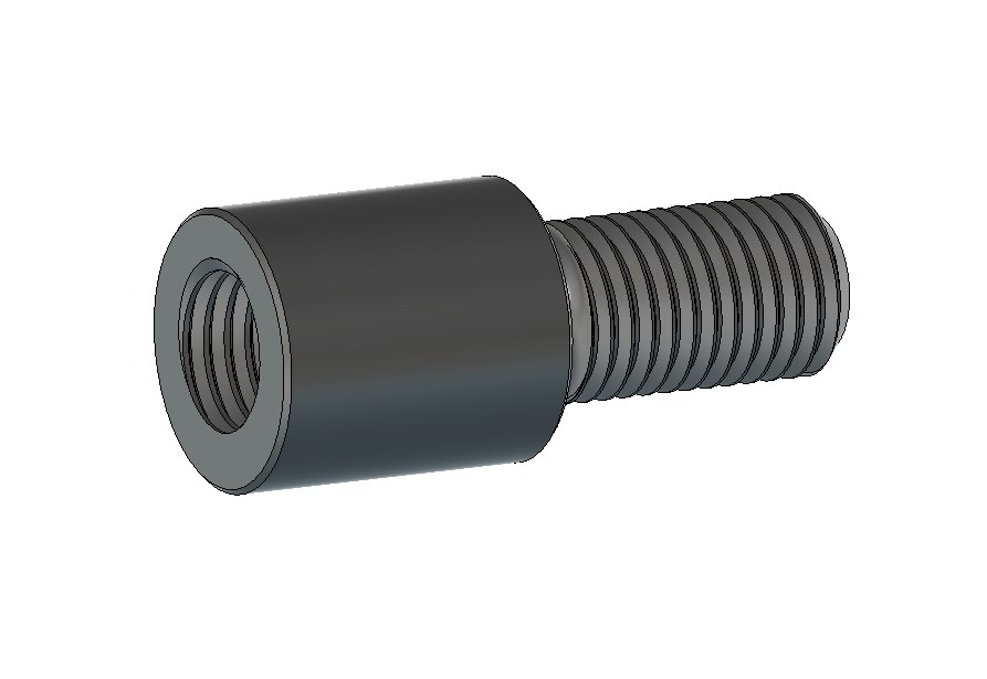

All that needs is a spacer the length added by the adaptor on top of the quill/spindle, easy peasyDoes the chuck have no stub end on it? Just whip up a male imperial to female m16 adapter. Only issue might be that the drawbar is then too long.
