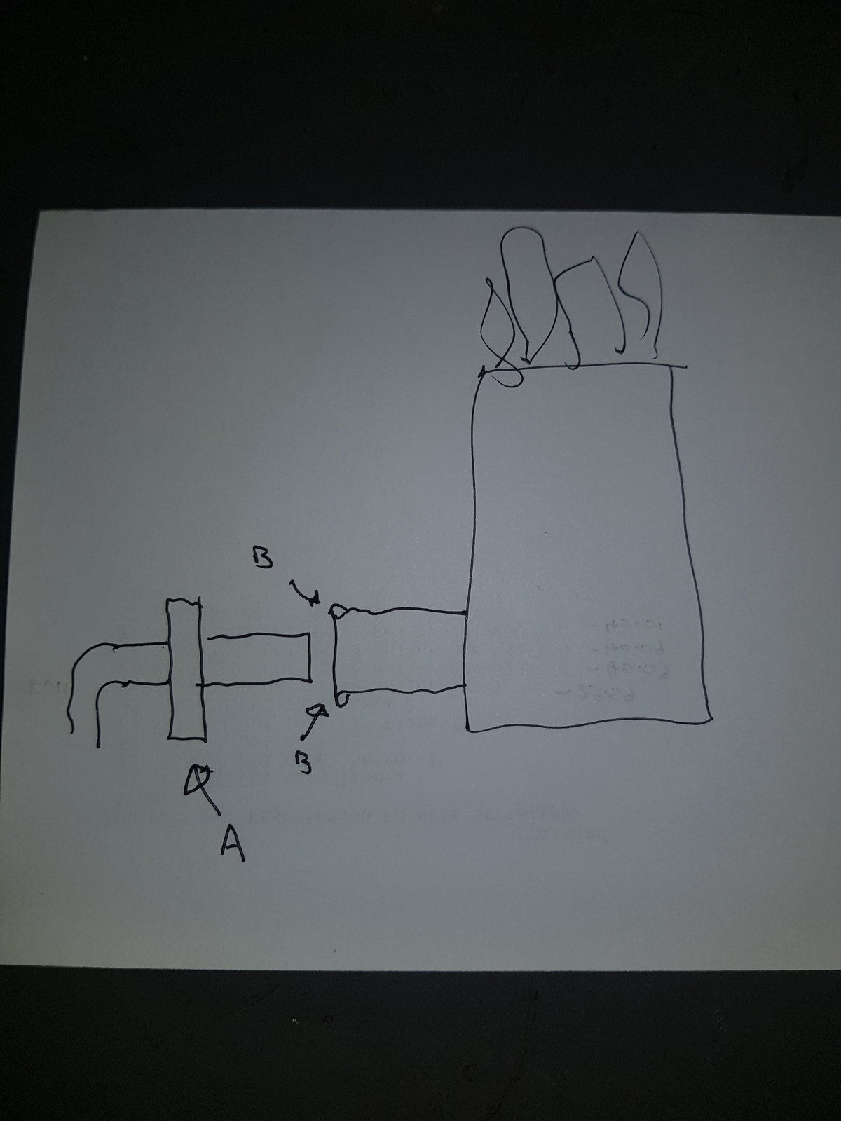

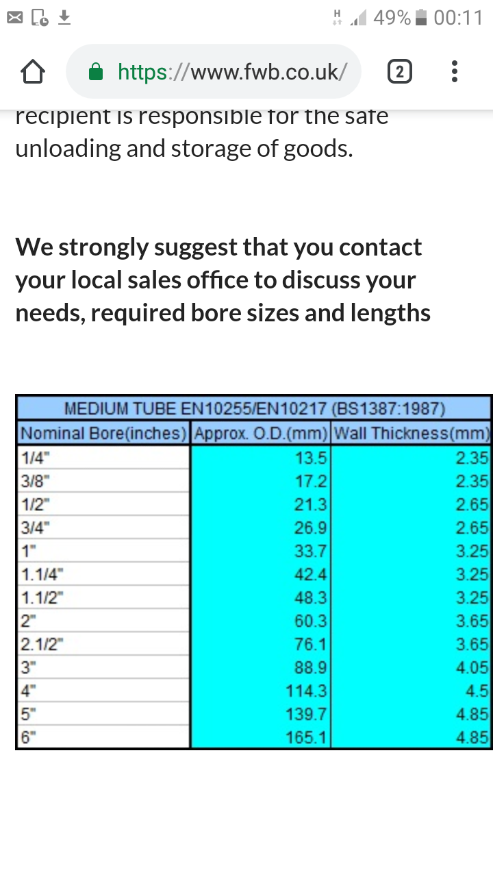

So i need, probably, a mild steel pipe to fit within another stainless one.
Its hard to find pipe in all diameters off the shelf, so i thought "why not use bsp plumbing pipe"
So, i reckon the ID of a 2.5" (2 1/2") stainless pipe should be 2.5 inches, right?
ie 63.5mm
So then if i want another pipe to slide into it, with minimal gap, but be able to be removed by hand, i want an OD a little less than 63.5mm?
The major diameter of 2" bsp thread is 59.614mm - so about a 4mm gap (as the pipe will sit on one 'face' so all the slack will be in the same place, on the opposite face)
2 1/4" bsp major dia is given as 65.710mm so thats too large.
But...
My actual question is -
Am i right in trying to work it out like this? Can i really assume diameters of the pipe from thread data. Or am i wasting my time, and the only way to be sure is to go and buy some?
For background - this is for the burner on my furnace. I want the burner tube to slide into another tube, but be able to remove it without too much bother.
