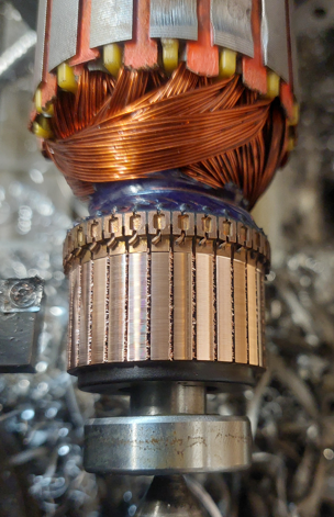

So I took a gamble on a used Clarke Planer Thicknessers being sold as spares/repairs.
Tried switching it on, and the motor tried to run with lots of noise briefly before the over current tripped.

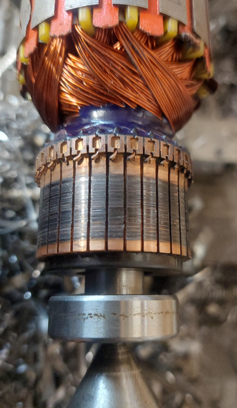

Stripped the motor out, and lots of sparking was evident.
Brushes didn't look too bad, but the commutator was pretty black looking, so dismantled the motor.
I was expecting it to have been burnt out, but it visually looked and smelt fine, with the copper/resin looking good, so chucked the armature in the lathe, took a skim off it, and rebuilt it, but it made no difference.
(this was before I went around cleaned the swarf out the slots)
I have priced a new motor, but at £200, I'd be as well buying a complete new machine!
So I'm now wondering what would actually cause the excess current draw/sparking?

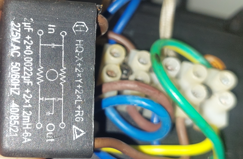

There is a filter fitted, and I've not disconnected anything to check for continuity yet, but could the filter cause the problem?
I could probably fit a different motor, but I'd need to work out it's speed first, as there are no markings on it.
