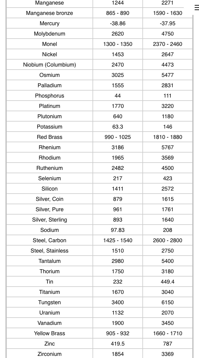

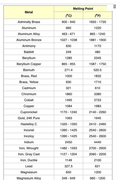

Right what i'd like to know can i fuse some bronze brazing rods on Ali
The Ali in 10mm thick,i'm looking at cutting/grooving out a notch/slit and filling it with brazing rod ie bronze,again this is just for looks i'd like the look of that brass/bronze effect on Ali with both all buffed/polished up.
Going by the temps bronze melts at 840F, while Ali is 1221F i'm thinking if i heat the rod and the ali up it'll drip and flow into the Ali and perhaps not fall out,make any sense
I've got quite few lengths or self fluxing rods to play with but only one shot at this bit of Ali
Forget it,or is it possible?
