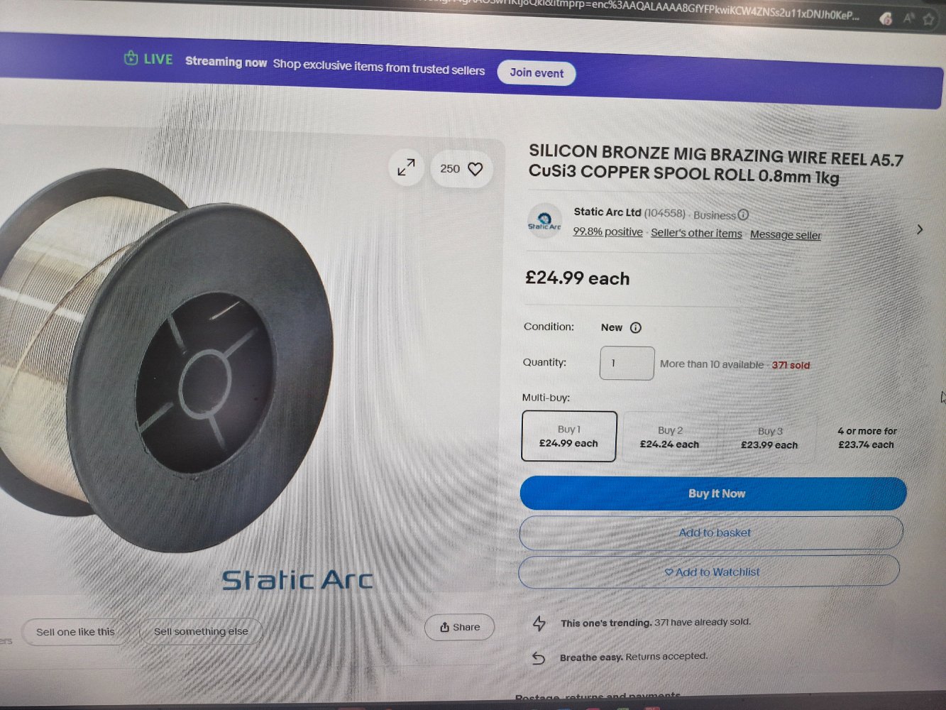

The MOT manual has an absolute prohibition on brazed repairs unless they are replicating how the OEM built the vehicle.I ordered a spool of this to try:
Is this OK for jacking point / cill repairs? I am thinking of my 1989 Merc Cosworth if this is worth using for better corrosion resistance.
Does this wire also require pure Argon gas?

/\ that's true for thin panels which is a legitimate use, but the thread started by talking about sills and jacking points - which limits the use of braze somewhat...
Yes. Specifically for bonding of high strength steels where the fusion of a welding process would cause molecular damage to the heat sensitive high strength steel. In those cases OEM design has (presumablyseems its the new old way
) assessed the forces acting in those areas and concluded that the bonding produced by braze reaches acceptable limits. So any aftermarket repair should use a process similar to the OEM design. I take that to mean fusion welding for mild steels and more controlled heat processes for higher strength steels...
