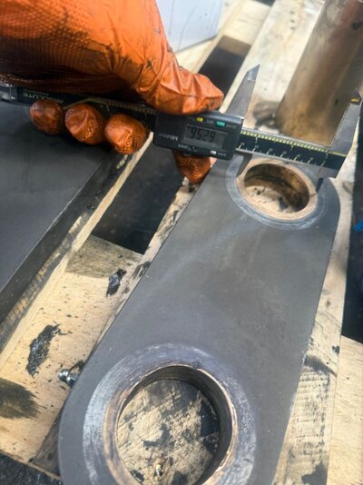

You are spot on. The pin is well hammered. I have put it in a four jaw and got it back to round bit I am also making a new pin. I will try and photo it all when finished but i only got the second slug of Bronze at 6pm and I feel under the weather today..Without the pins that go in the bush, it may be difficult to make things fit well. Given the wear in the bush, it would be wise to check that the pin is not also worn, or similarly out of round. A bush which is sized to, and has to pass over, the unworn part of the pin will be loose on a worn part.
Any sloppiness in the connection is going to lead to premature failure. That sloppines could be between the pin and ID of the bush or the OD of the bush and the hole. Hence the bushes would normally go in the link with a slight press fit and then be bored insitu on a mill.
A simple 50 ID 60 OD item is a bit risky if anything other than a short term fix is required.
...they have a long term contract to supply the product this machine produces.
Trace in on cardboard for now.Thats the plan. But i am not good at drawing. LolView attachment 523325

That looks like it should be sub 10 minutes to model and detail up on paper.I finished and got a rough diagram now.That was one mega long weekend. LolView attachment 523423View attachment 523424View attachment 523425
