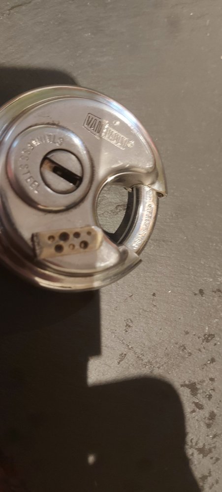

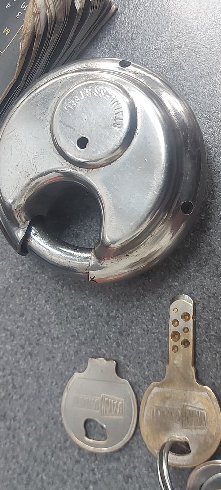

Pin punch, or small drill.What's in that hole on the back picture? Looks exactly inline to just shove the key out from the back with a pin punch.
The dimples on the key can hold the remains quiet well.Have you tried banging it down on something hard, a vise is ideal - not over the keyhole obviously!! It works more often than not.
That is there to extract the key.What's in that hole on the back picture? Looks exactly inline to just shove the key out from the back with a pin punch.
