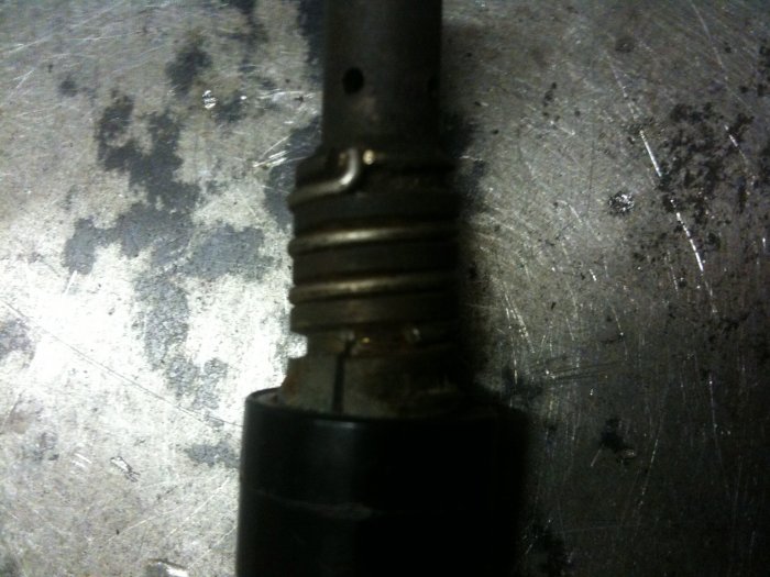

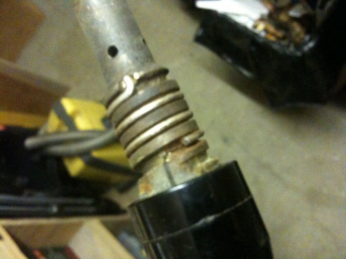

My mig has suddenly started producing very sooty welds, upping the gas made no difference. Taken the torch apart and found the probable culprit... Can anyone confirm please?
The metal is cracked just below that metal coil and also the black plastic at the bottom is split, drawing in air i think.
If this does need replacing, does the whole torch need binning, and also a good place to purchase said item.
Thanks all! (and a happy new year
left to right, 1st - gas @ 10 lpm, 2nd - gas @ 14 lpm and trying a dodgy overlapping technique, 3rd - gas @ 7 lpm, 4th - gas back @ 10 lpm.
