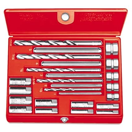

Best way I find for removing a seized bleed nipple is to heat the immediate area up then apply ice to the actual nipple. These things shear off too easy.Well I talked that up didn't I, just snapped one of in a sheard off bleed nipple.
MIG and a nut sorted it in the end.
