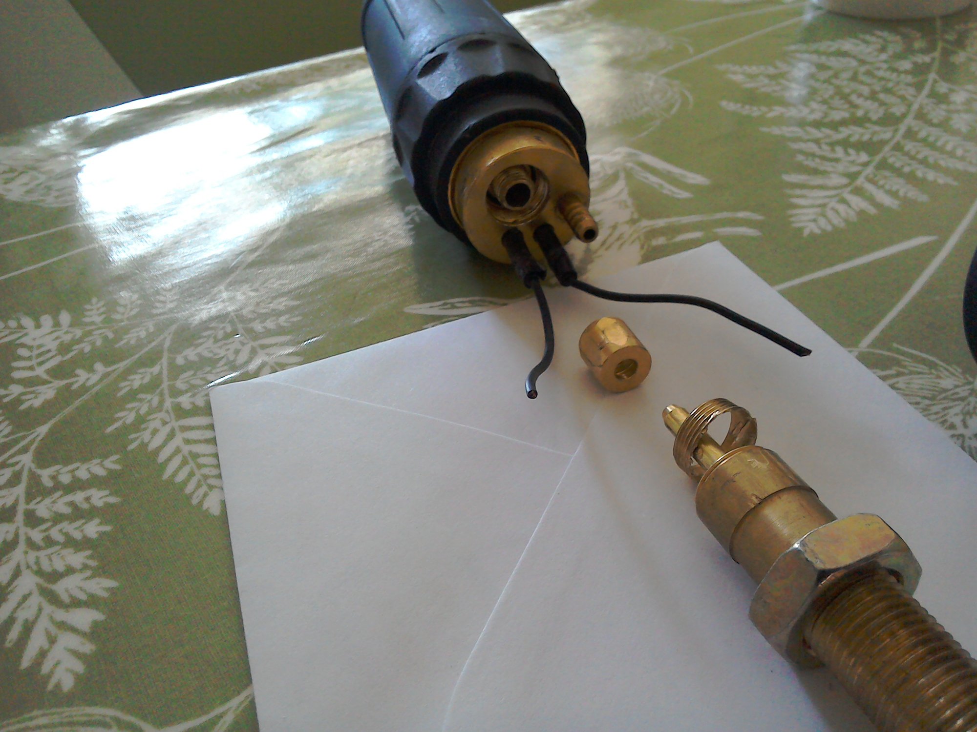

It is a Euro connection on that mate already. The part he shows holds the guide between the torch and the rollers.I would just buy a new Euro torch socket, will cost about £20

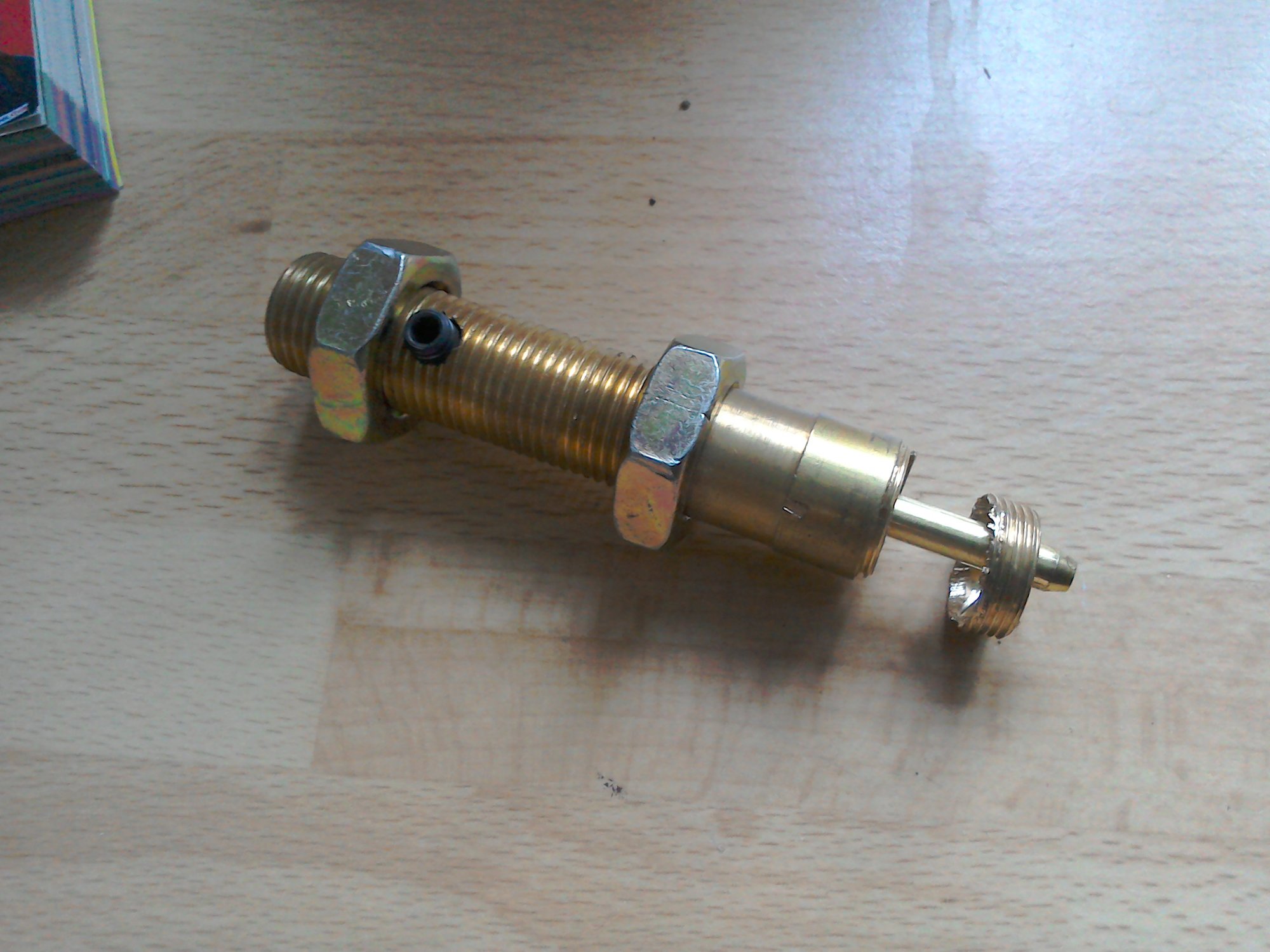

Like @TechnicAl said you could probably fathom that to work with something else if you cannot get the part. I can see now from your other pic that threaded part is very thin walled and I dare say it doesn’t need to be. If it was mine id turn a new one and leave more meat on that part.
, my point is it may be difficult to find an exact match as the machine is a few years old and the wires have been tugged so a £20 socket will fix the problem in one hitGet a generic euro socket as said above.they come with the broken part included.there are slight differences with them all but nothing a drill and spanner wouldn't sort
