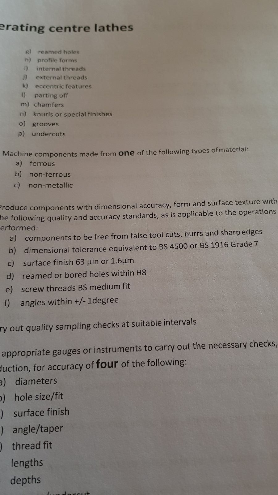

S swedge Member Messages 149 Sep 25, 2018 #1 So I'm doing an engineering apprenticeship atm being tailored to manual machinist Does anyone have any information about these BS numbers? 20180925_171428.jpg 180.3 KB · Views: 107
bigegg Scream Not Working Because Space Make Deaf Messages 9,725 Location Leeds, West Yorkshire Sep 25, 2018 #2 bs4500 was withdrawn about 1990 according to google. (and a copy costs £170!!!) BS1916 appears to be current, and costs £224!!! https://shop.bsigroup.com/ProductDetail?pid=000000000030192612 apart from that, its something to do with how undersized or oversized a hole or shaft have to be for a particular purpose. You probably knew all this - I didn't. I just looked it up.
bigegg Scream Not Working Because Space Make Deaf Messages 9,725 Location Leeds, West Yorkshire Sep 25, 2018 #4 it looks like it. I would arsume that your college has a copy in the library, though?

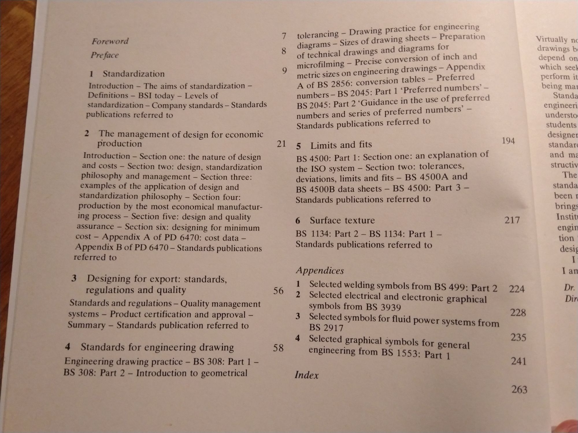

Tangledfeet Knurling is my Nemesis. Messages 3,244 Location Top of a hill above St Andrews, Fife Sep 25, 2018 #9 I had this book as an apprentice thirty years ago and bought it again, used, several years ago.

Tangledfeet Knurling is my Nemesis. Messages 3,244 Location Top of a hill above St Andrews, Fife Sep 26, 2018 #13 swedge said: Thanks I'll speak to the guy from college who visits me How much was the book? Click to expand... You can buy them from around a fiver - link.
