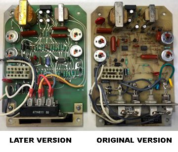

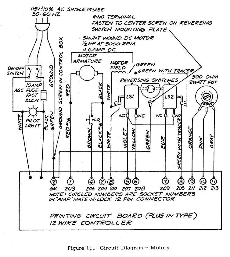

Hello all. Need some help with my Bridgeport original power feed please.
It was working fine except leaking a little, so I took the motor off to replace the seal.
On turning it back on it seemed ok, ran it left and right to the stops a couple of times until it had a little wobbly and then started pulsing at low speeds, ok at max speed / rapid, then it blew a fuse.
I stripped the motor again and found that I must have trapped the green wire which rubbed on the armature shaft and cause a short.
I've now fixed that, and am running the motor out of the gearbox but am still having the pulsing issue and it still keeps blowing fuses, can't find any other problems and it's driving me mad.
Can anyone help please?
The electrical box with the micro switches is clean enough, all the wiring looks ok, motor turns free by hand.
