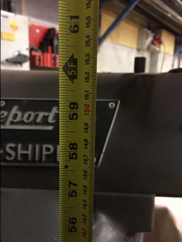

scottmk1 Member Messages 1,975 Location Scotland Apr 6, 2015 #1 Hi, I am meant to be collecting a bridgeport mill tomorrow, I know the overall dimensions of it but does anyone know the height of the top side of the ram where the eyebolt screws into? cheers Scott
Spark plug Member Messages 4,036 Location Durham, England Apr 6, 2015 #2 Just measured mine, it's about exactly 5' from the bottom of the base to the top of the ram. image.jpg 52.4 KB · Views: 78
scottmk1 Member Messages 1,975 Location Scotland Apr 6, 2015 #3 That's great cheers. It might just squeeze under the garage door then!
Spark plug Member Messages 4,036 Location Durham, England Apr 6, 2015 #4 The ram isn't difficult to remove if the head is off, it's only 4 bolts securing it to the spider underneath.

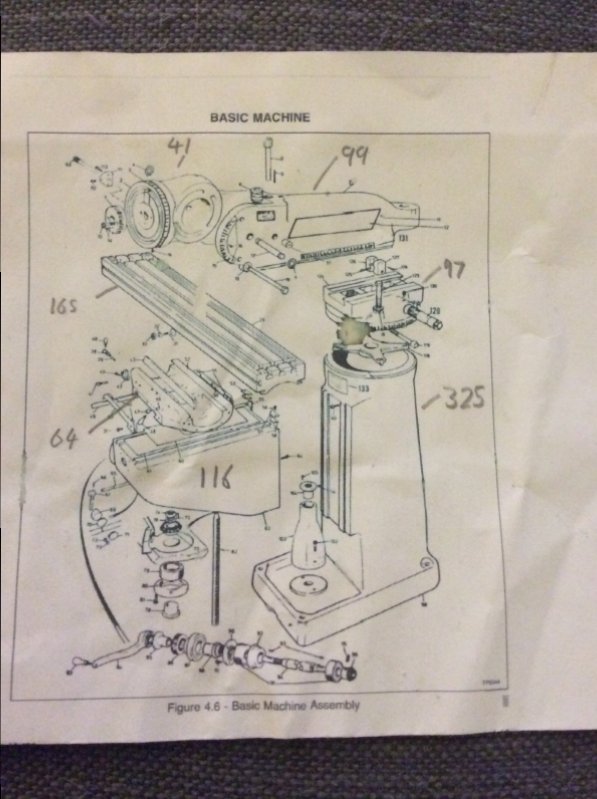

scottmk1 Member Messages 1,975 Location Scotland Apr 6, 2015 #5 Yep that's what I'm going to have to do. What sort of weight is in the head & ram?
MattH Member Messages 4,515 Location Cornwall Apr 6, 2015 #6 Weights are hand written on the diagram below and are in Kgs.
