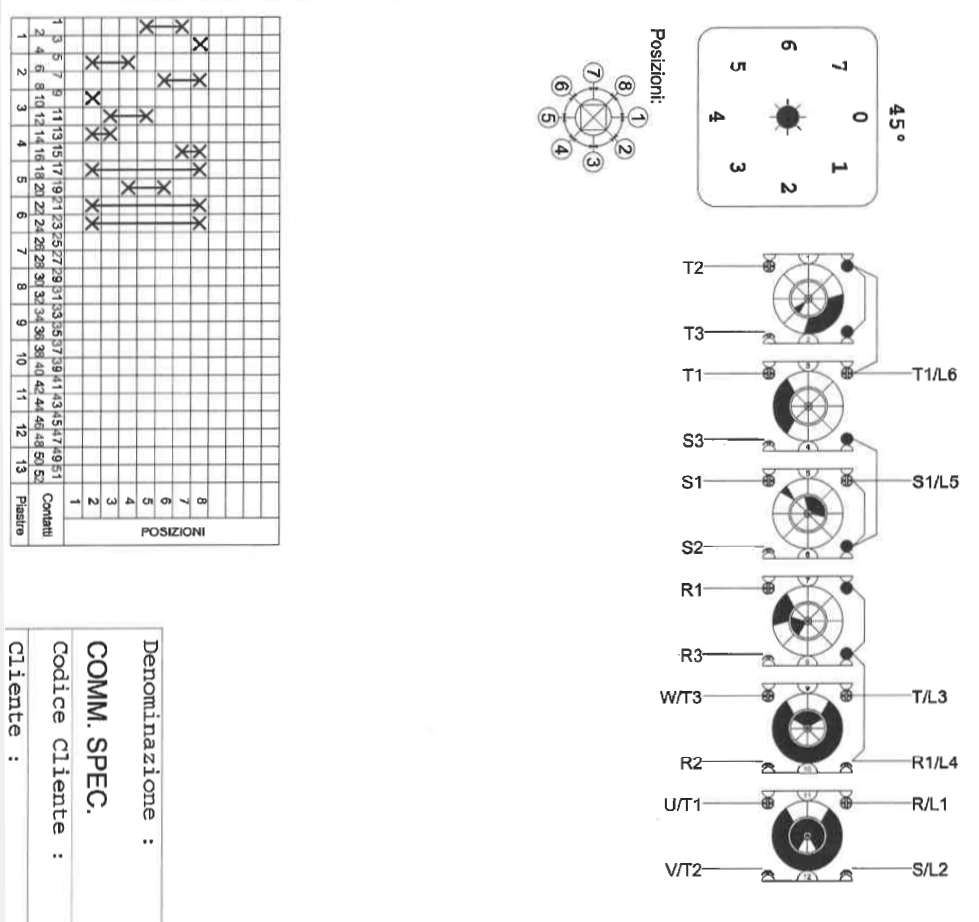

I can't cope with the interpretation of the connection diagram of the Bremas 5665 switch (0--7) - it's about determining which contacts are closed in a given position.
For me, the way of depicting the position of the switch cams (i.e. closed contacts) is not very clear...
For gear no. 1 (the weakest) the contacts connect:
5-6
9-10
13-14
(and contacts 17-18, 21-22, 23-24, but they connect in all positions except "zero")
So which contact is T1, T2, T3, etc. how to interpret the black, painted markers in the subsequent sections of the switch?
Regards!
