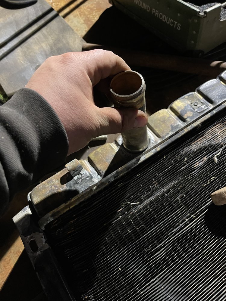

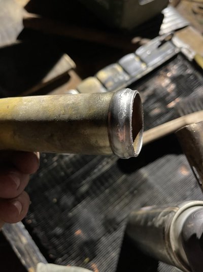

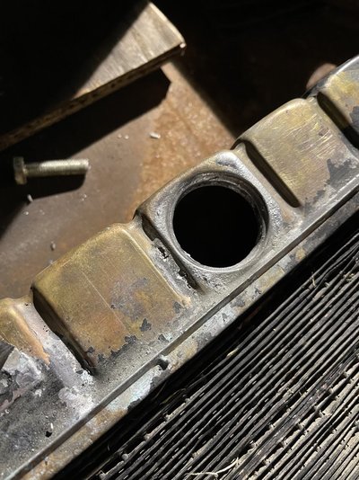

scrupulously clean the surfaces as well . i just soldered a new filler cap on my rad on the mobile compressor last year and soldered a leak on the coreWas always doing landrover rads that had damage. Ain’t mending rads these days with the disposable junkI've repaired a few brass rads (land rover series) soft solder and laco was successful
[/QUOTED]
With stupid plastic top caps " progress"
I investigated a fatal accident on the isle of whight where bakers fluid (ammonium chloride) was involvedTinmans solder and Bakers fluid, in a previous life I had a job for a little while I where used to make pre production radiators amongst other things, all forklift / digger / tractor related
If you are not set up for it I would just take it to a rad repair company, it will likely be cheaper
