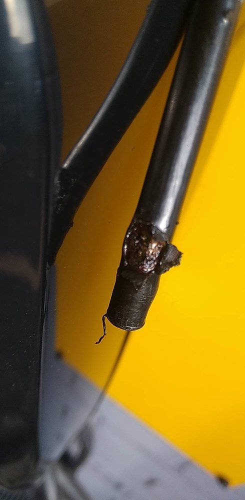

I test cars 4 days a week normally do 7 tests per day .
I tested a 8 year old VW polo yesterday .
Failed on a couple of tyres but a very tidy car .
Went on to the roller brake test , burst a pipe .
**** happens , all the visible pipes were plastic coated originals in very good condition .
A pipe had failed behind a exhaust heat shield .
The pipe was mint except for one small rusty hole .
No rubbing or chafing just this in the middle of a pipe run .
This is why i advise on under trays on older vehicles .
Proves the value of a test under controlled conditions .
