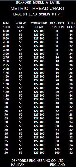

Hello everyone
I know some have already written a little on this but still un sure
I have bought a compound gear for my Boxford AUD with norton type gearbox but cannot find any reference to how to set gear box for metric pitches
All help will be much appreciated
Chris
