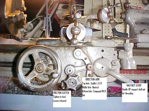

Can anyone offer any advice on the operation of the power cross feed on a Boxford lathe. It has to do with the 3-position selection jobbie, and the twisty wheel thing, but i'm not quite sure how its meant to work.
I think the twisty wheel is a clutch, but the selector seems to do nothing in two positions, and is engaged in the other.... Any advance on that? Plus does anyone know the proper names of the parts i'm referring to?
