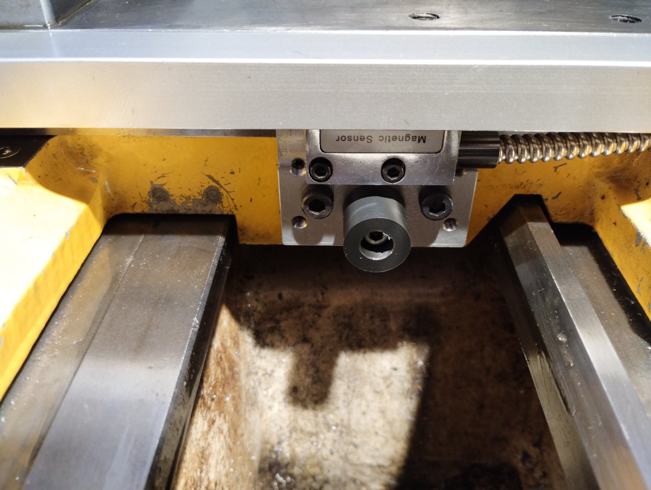

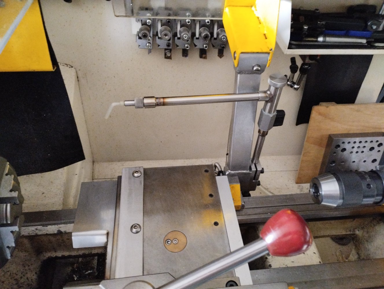

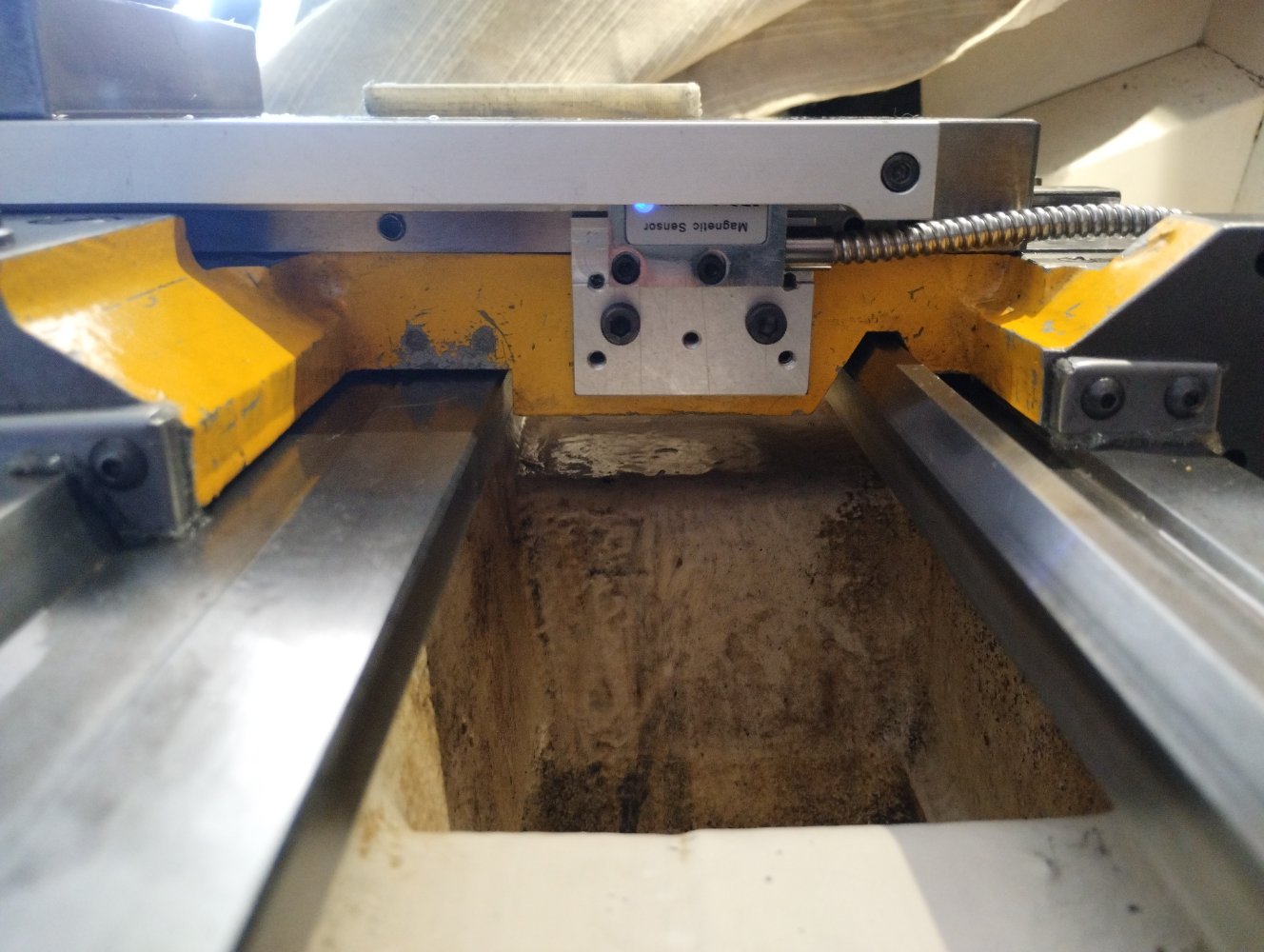

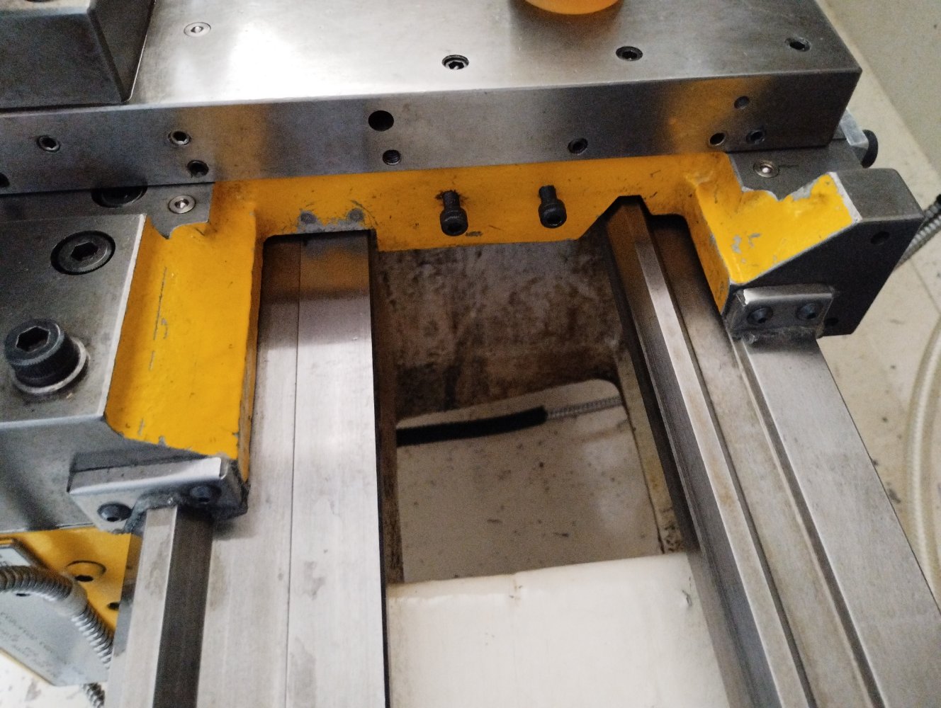

As it currently utilises the travelling steady mounting holes I decided to move the dro scale from the front of the saddle to the rear.

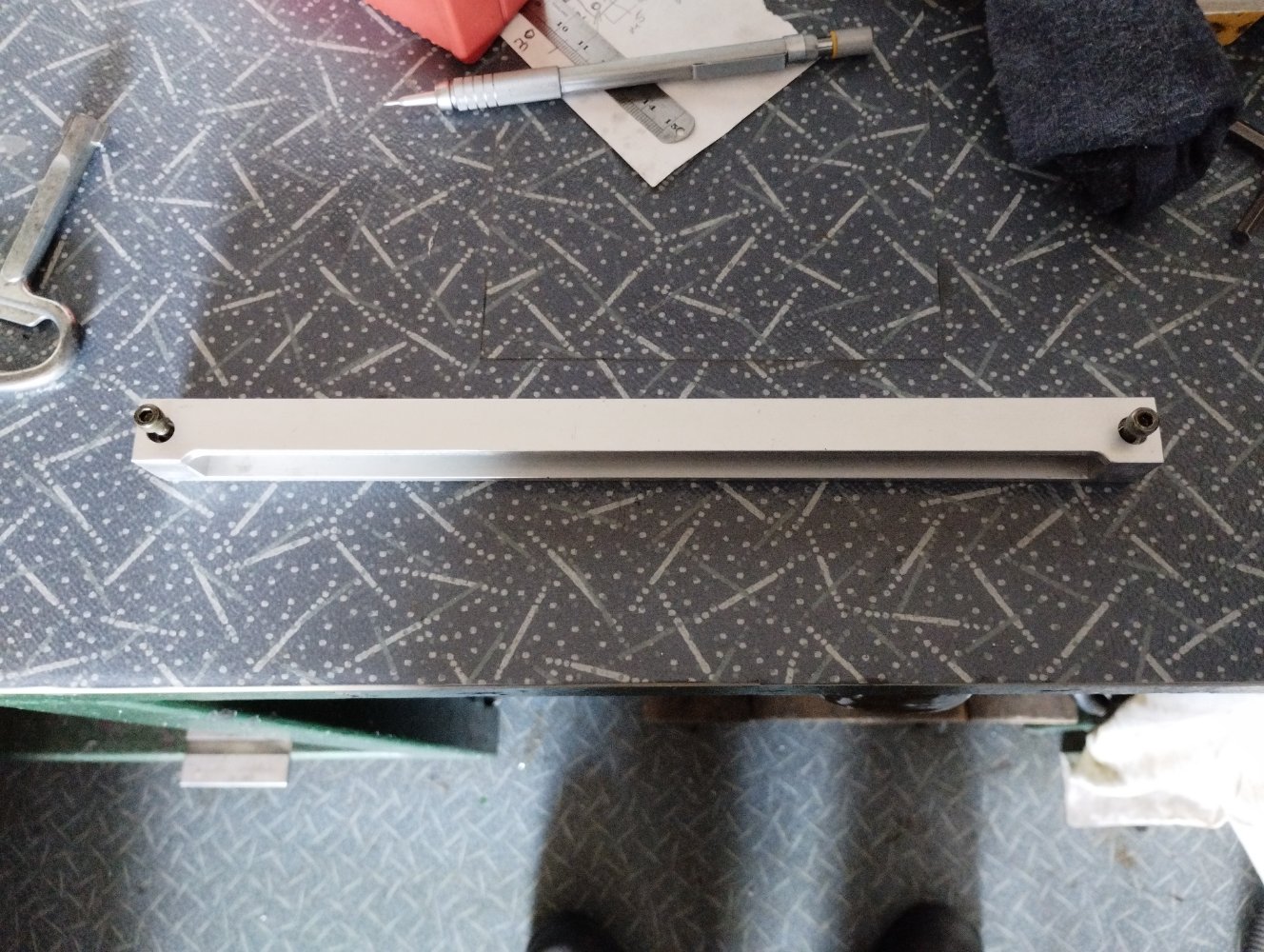

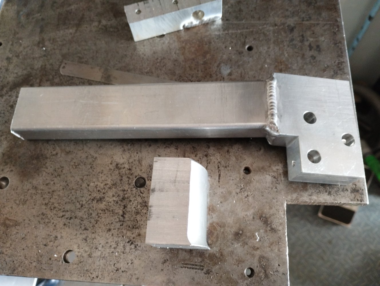

As I had a piece of aluminium channel in the "stock rack" it was used as the magnetic tape mount. Couple of end pieces made up and then drilled for the mounting holes.

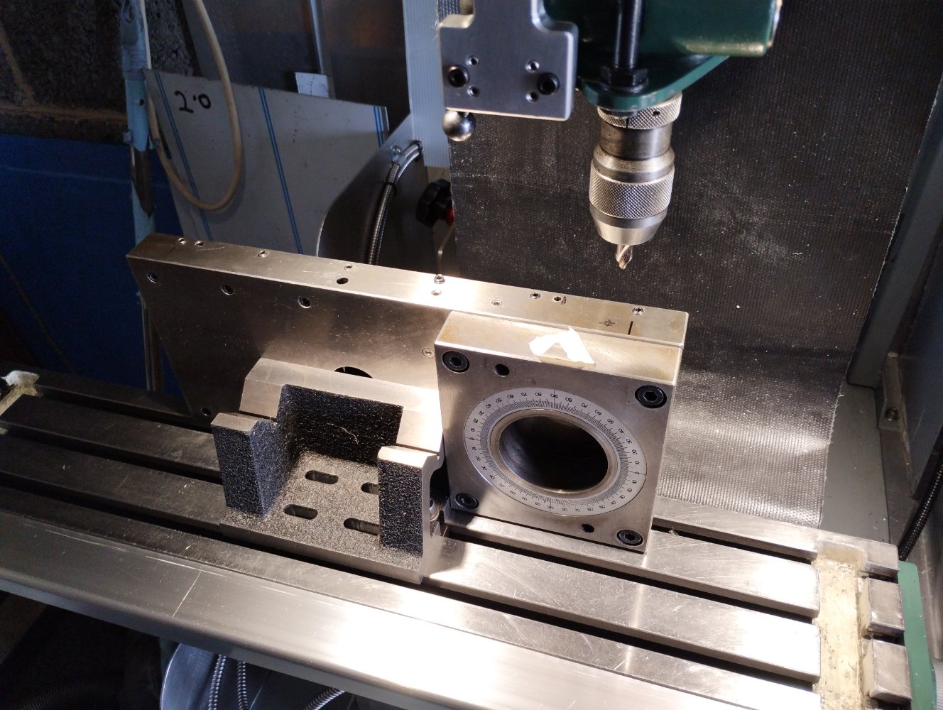

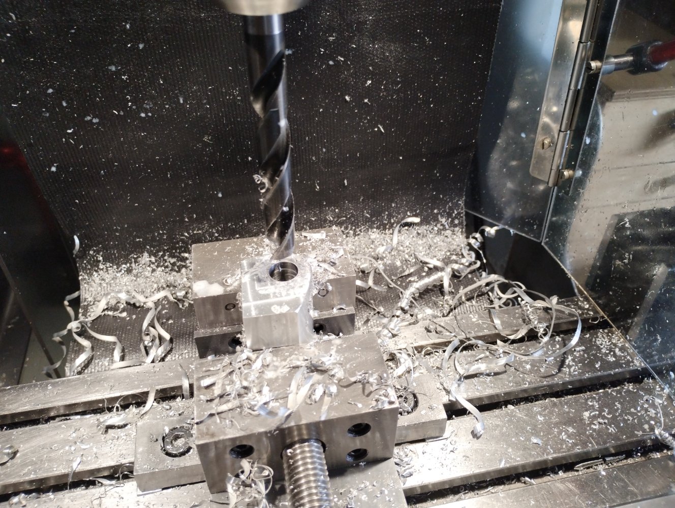

Cross-slide removed, drilled and tapped to mount it.

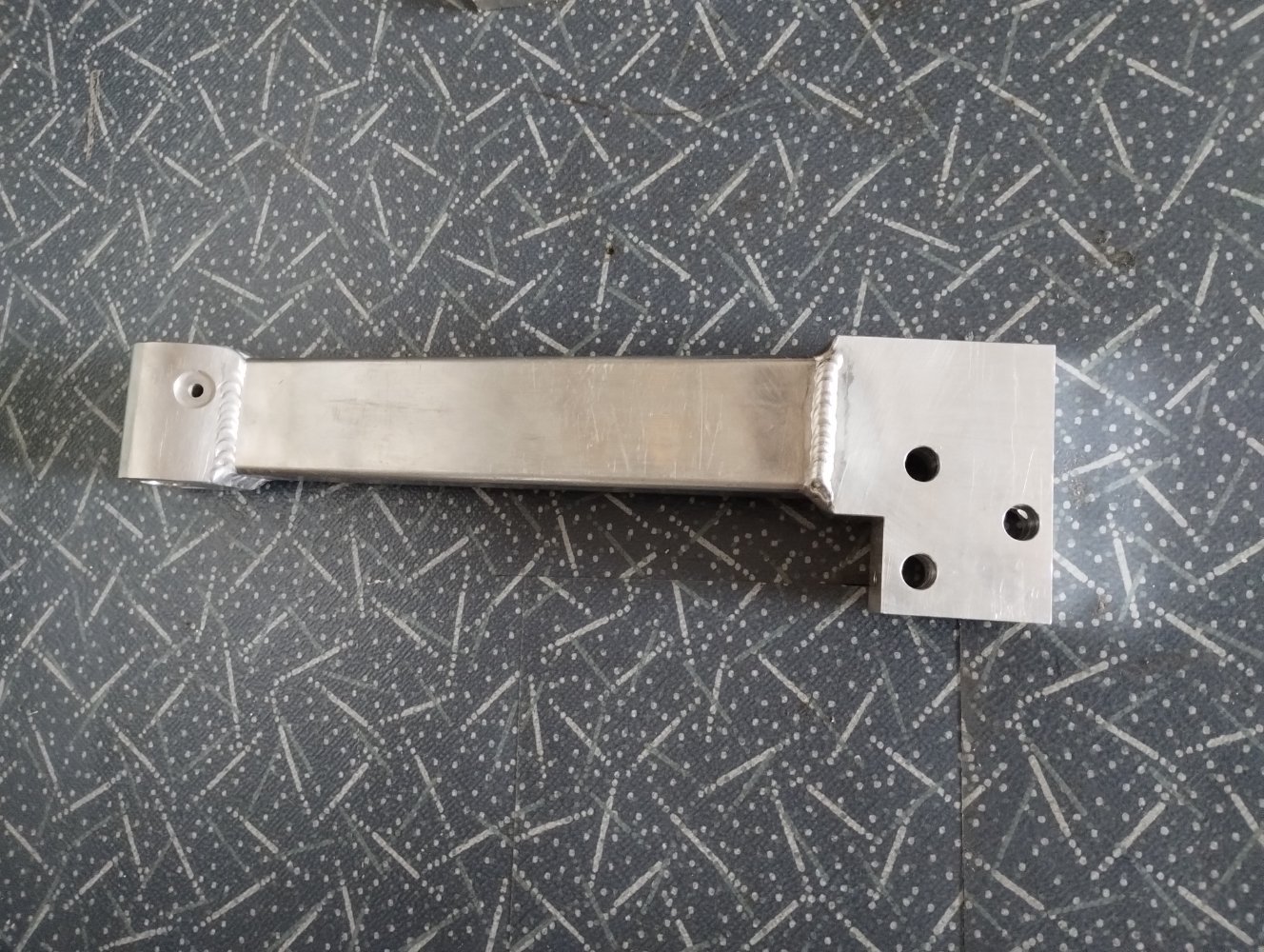

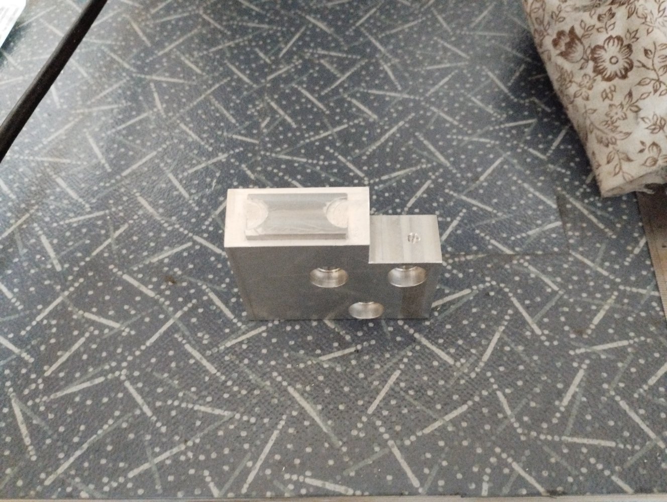

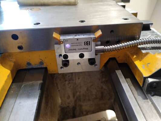

Saddle drilled and tapped for the reader head bracket.

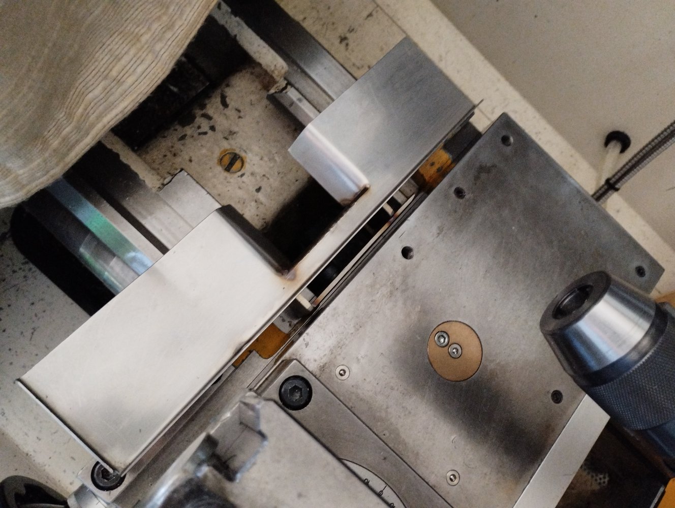

Clearances worked out for the mount dimensions. Adjuster screws added as I couldn't be arsed to remover the saddle and mill the mounting surface!

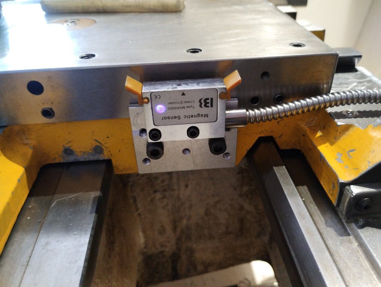

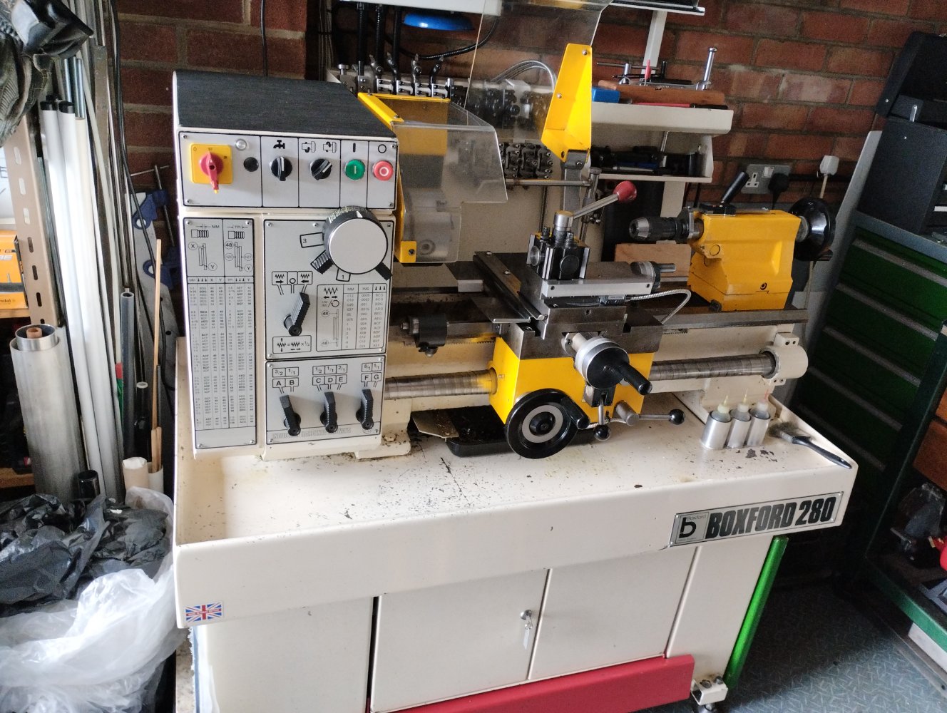

Tape removed from the front of the table restuck into the new mounting and fitted.

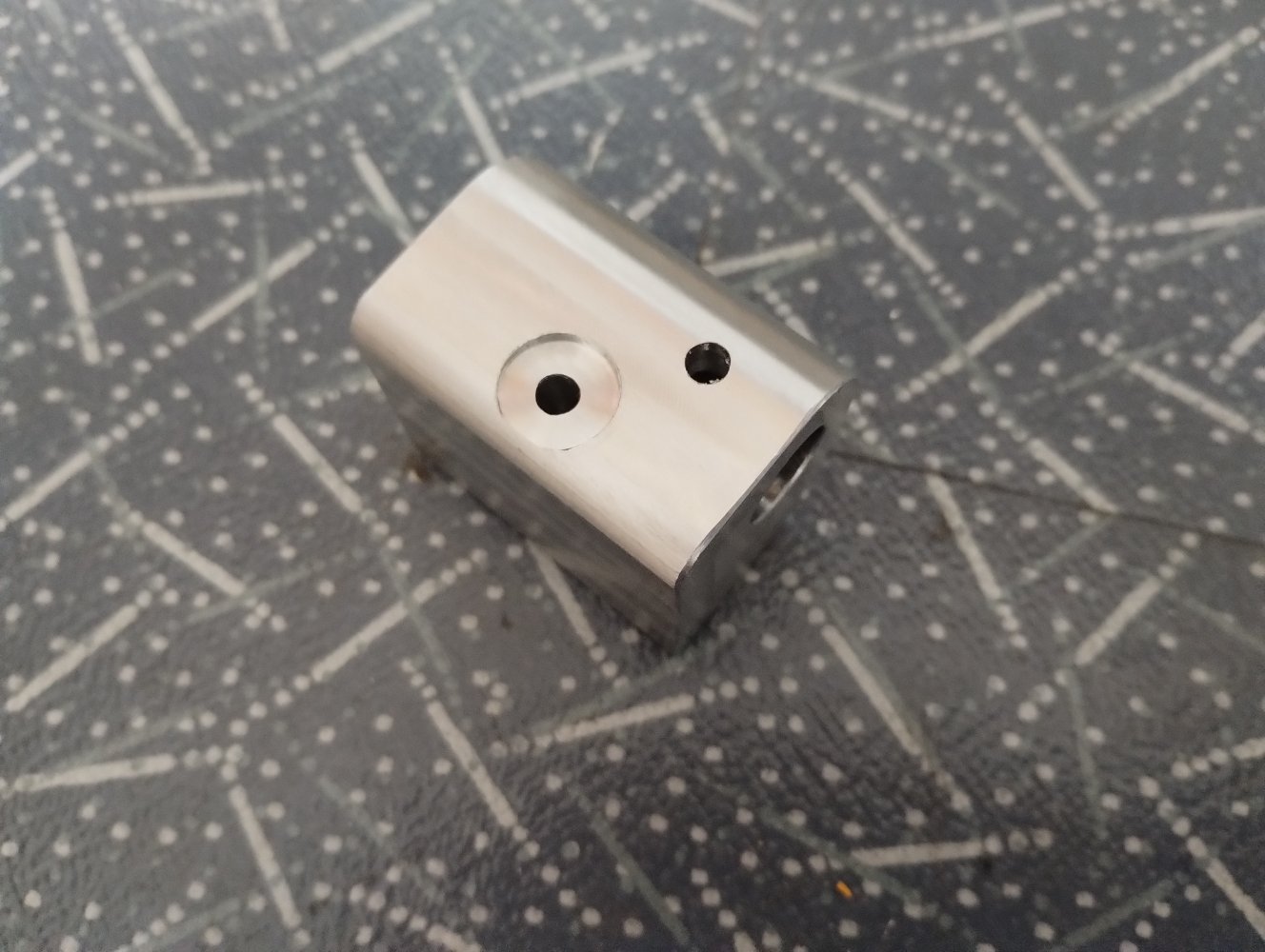

I know you are all thinking what's that spare hole in the middle for!
A bump stop for the tailstock.
