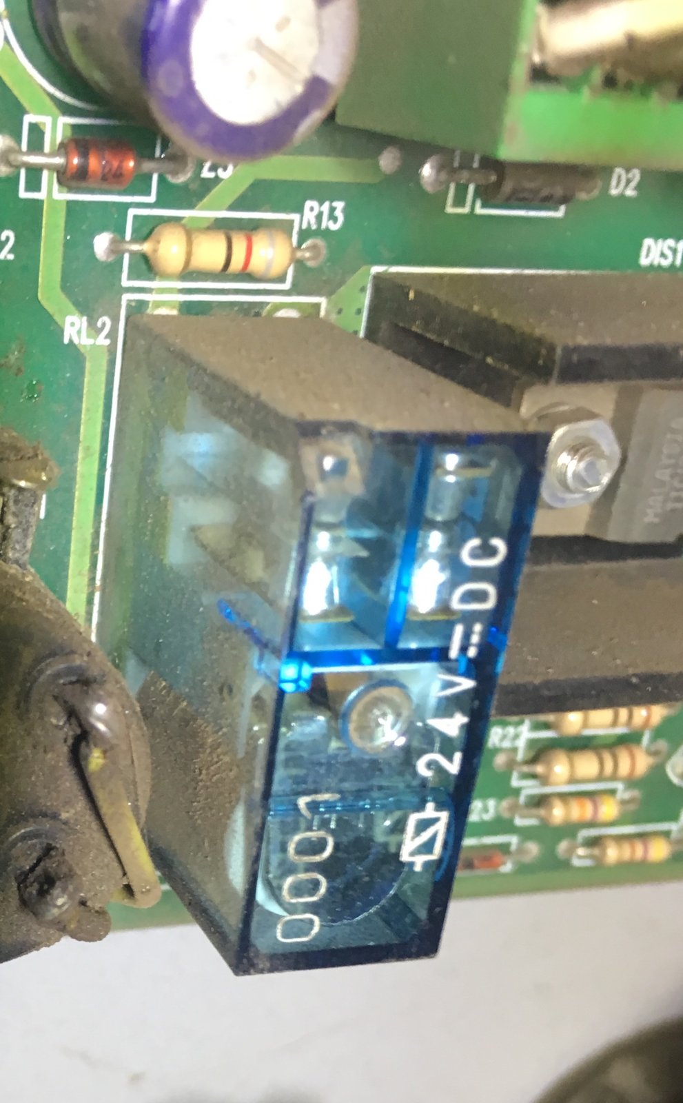

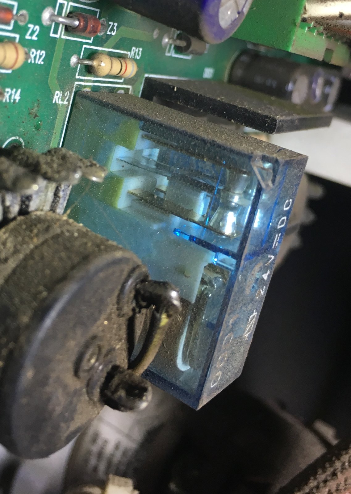

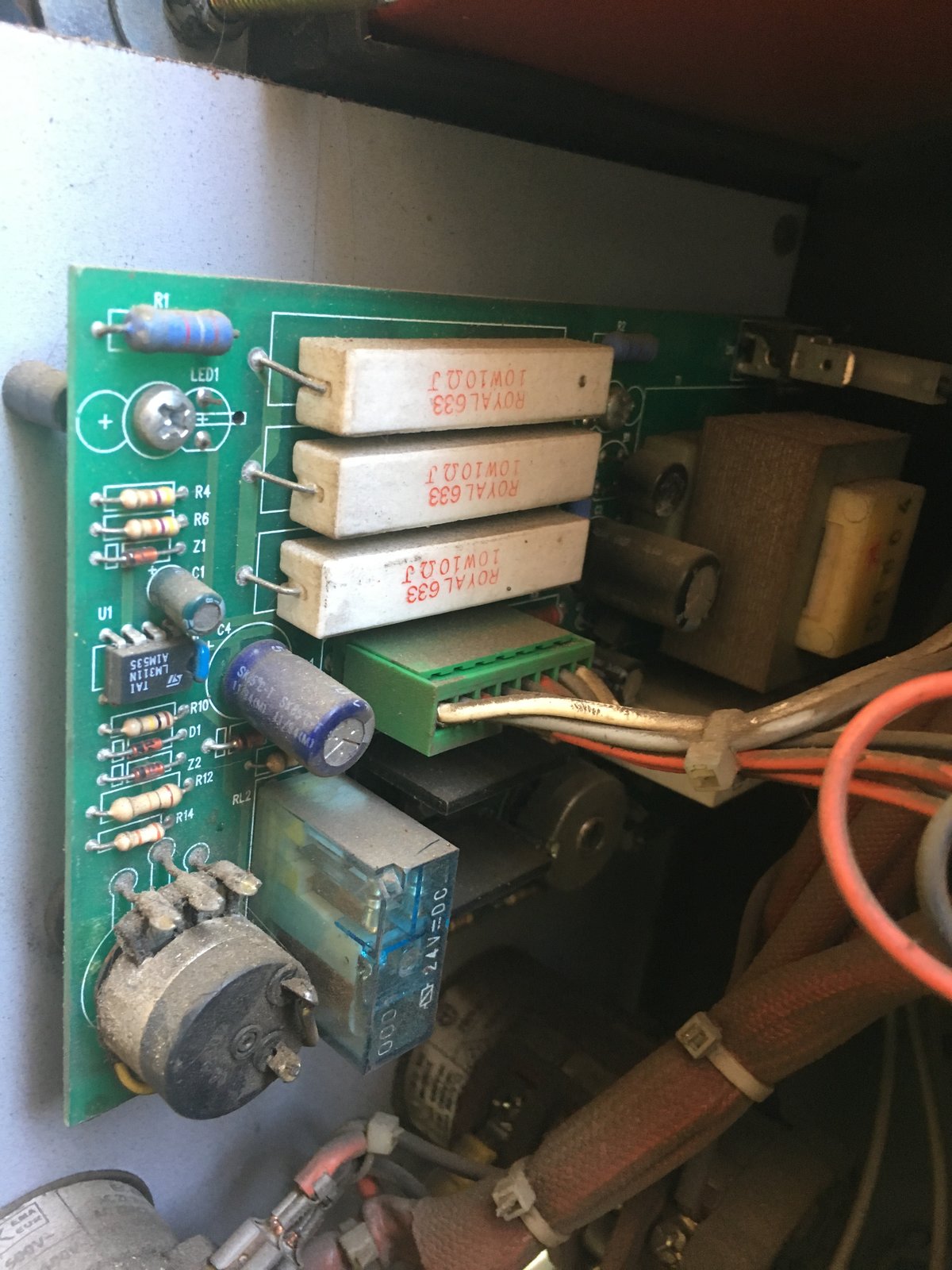

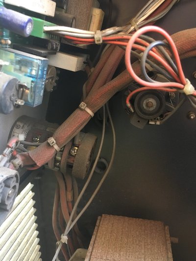

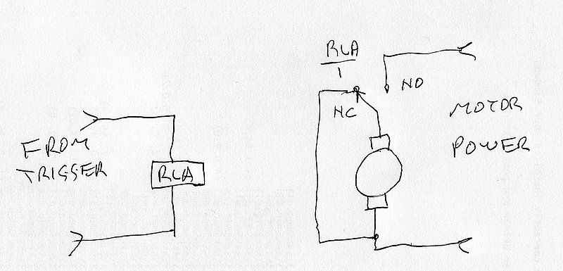

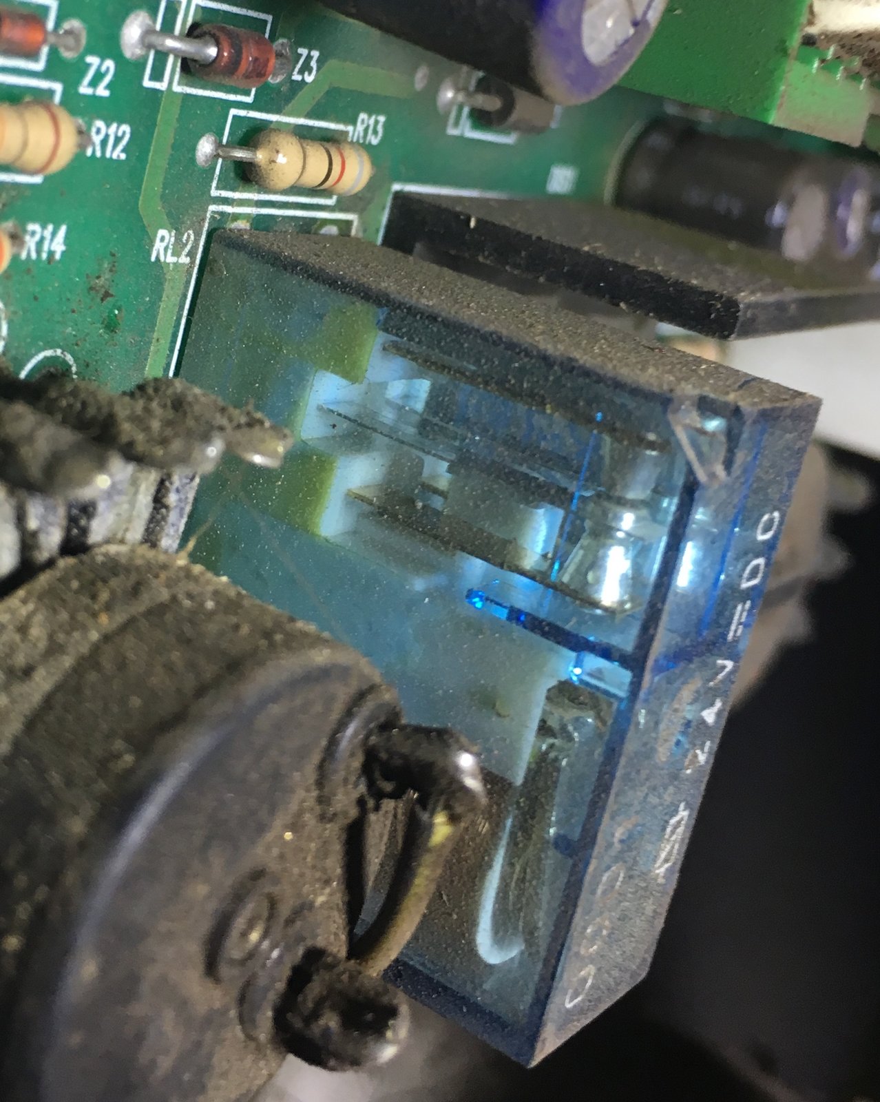

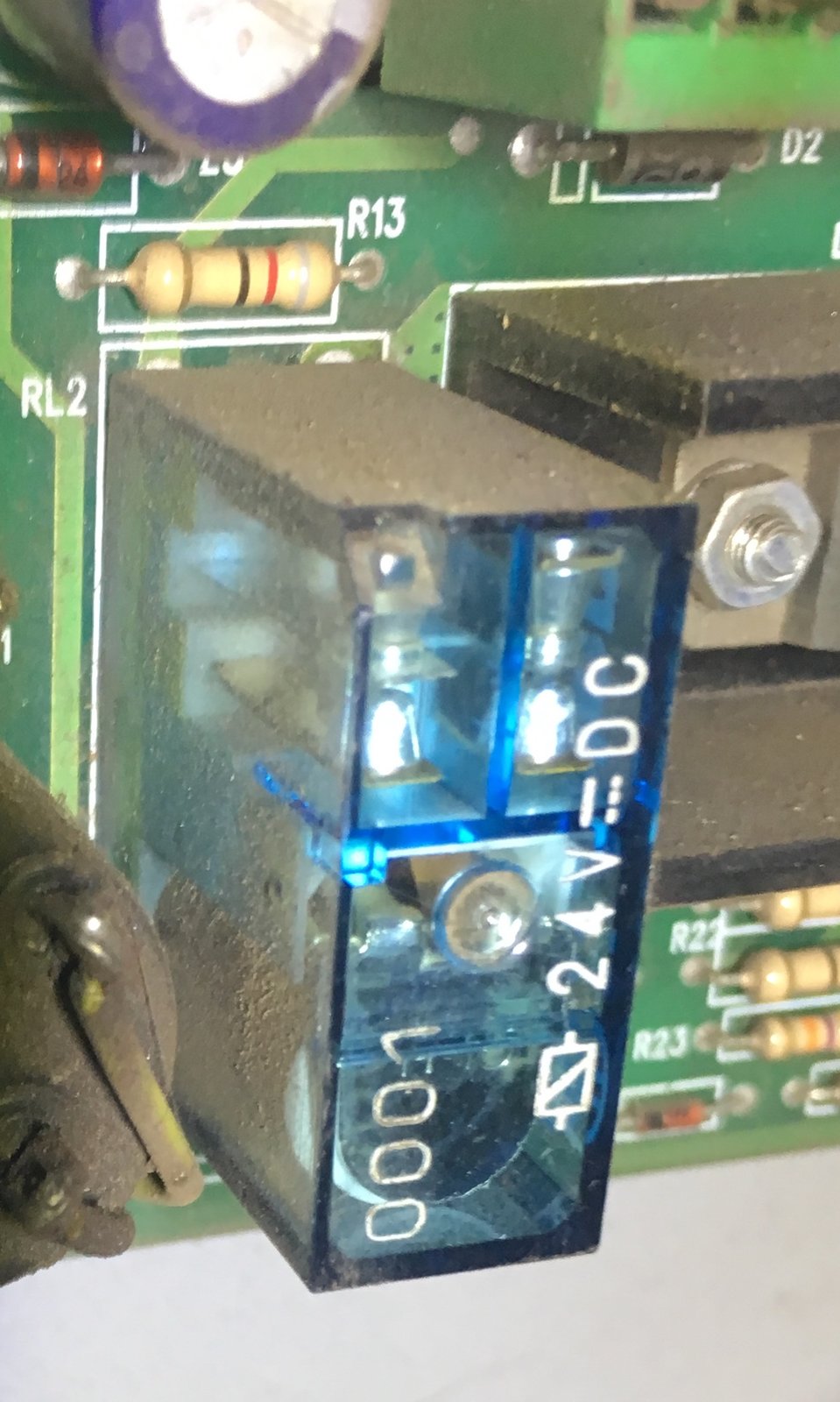

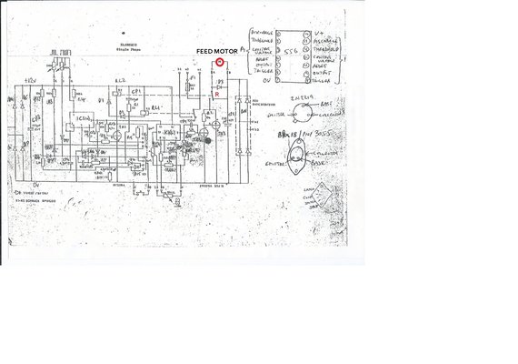

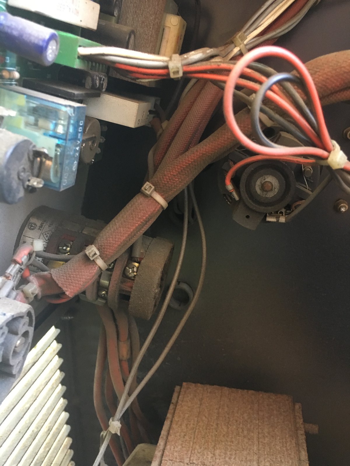

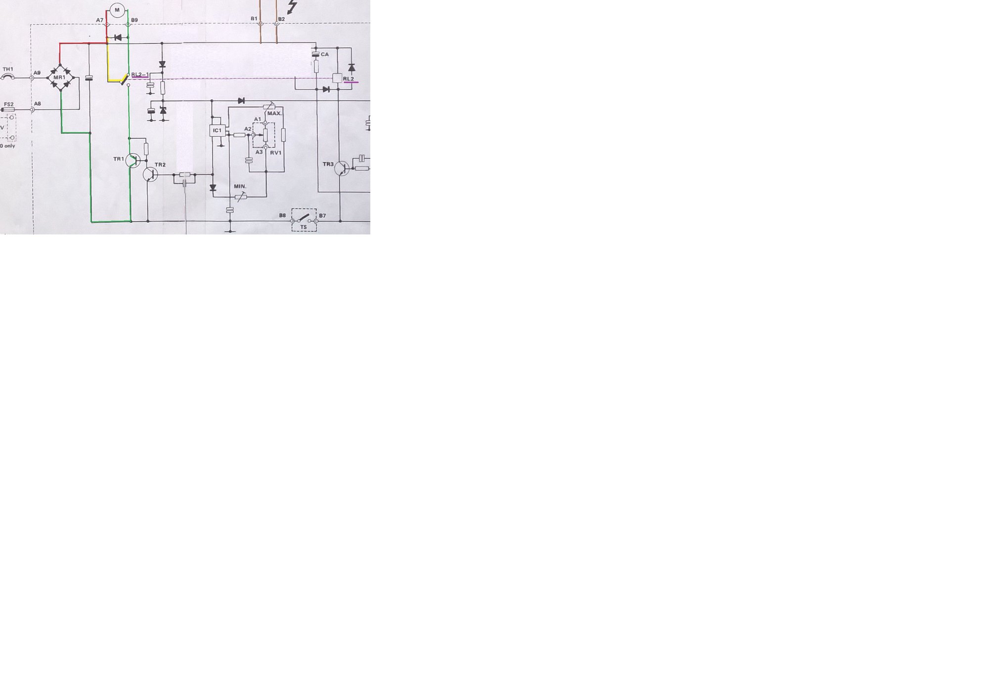

I bought a mig off a member on here a little while back. Wonderful tool and I was very aware of this issue on the day I bought it and I can live with it easy enough. However if someone can help me eliminate this little niggle I’d be very happy. The wire feed motor over runs slightly when the trigger is released. We are talking a fraction of a second and it’s difficult to see unless you weld. However when you release the trigger welding that over run causes the wire to stick in the pool every time
I have to move the torch away on release. So is the motor brake knackered? Is there a doobrifurkle thingamewhatsit that I need to look at. Anyone else experienced and hopefully fixed the same issue.

...Anyway i found using small reels and screwing down the rollers half a turn stopped the inertia a tad and it helped no end
