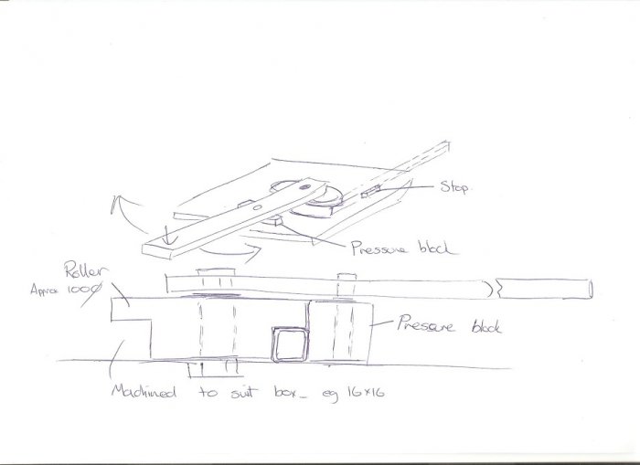

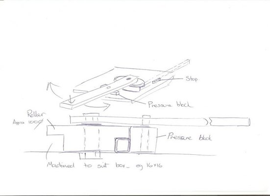

Made a hand bender for 16*16 box before, repeatability wasn't a problem, small drag marks on the outside was the only downside. Quick flick with a pad and they were gone.
I can do a quick sketch when I'm on the lappy in an hour or so if you like.
Roller was about 100mm diameter, but bigger the radius, easier it is to bend.
Machined out to keep the box in shape, about 1mm gap
The 'pressure block' pin needs to be pretty strong to stop it twisting, and a bit of thick oil/grease helps prevent/lessen the drag marks.
A little downward pressure on the handle helps, and it needs to be done in a smooth action.
Bent up many hundreds on the one we made, all quite tight tolerance too.
A backstop can be set, but you will need to clamp the end so it doesnt drag through as you bend.
