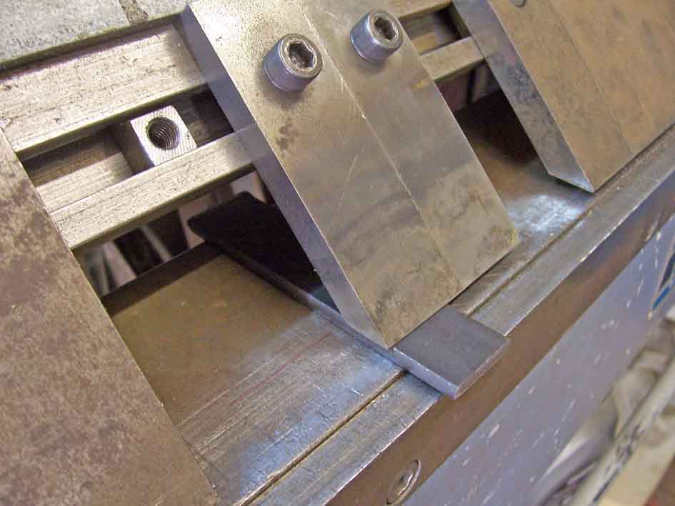

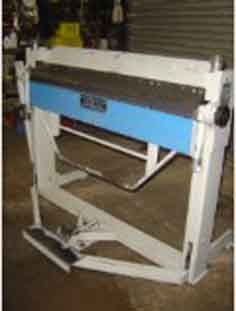

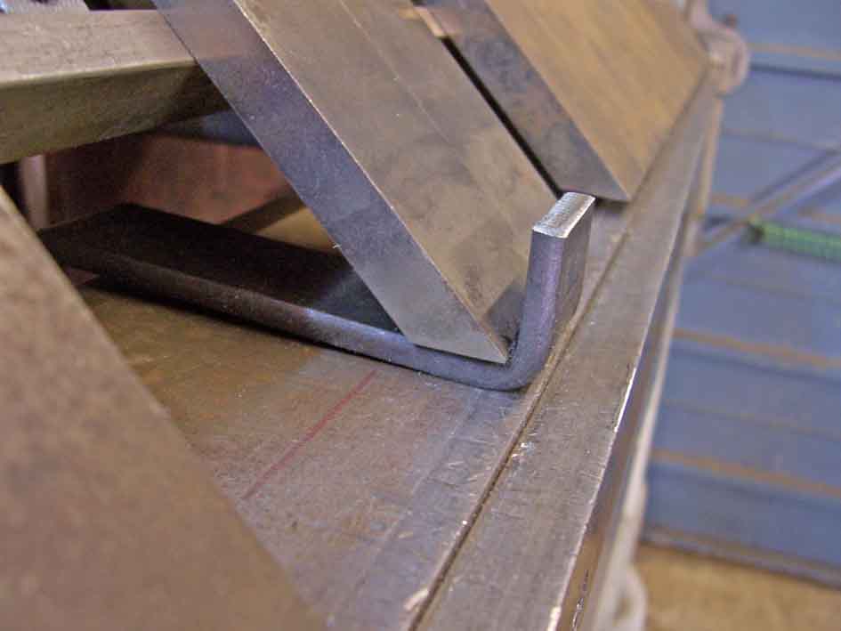

I searched for ages for a small box & pan.
I went to look at the more promising ones. I would take a strip of 1.5mm mild, 1mm stainless, and 1.5mm ally if it was rated at 16g.
Most failed the test. Some folded, but with a 1mm rad at the ends and 4 or 5 in the middle.
But everything comes to he that waits, and sure enough I heard of a bloke that had what turned out to be a gem.
It wins in every way. It's 1260 (49-1/2") wide rated at 16g and it really does do it. Rather than counter balance weights on arms
that take up loads of room behind it has spring with hydraulic damping mounted vertically on the end.
Another huge plus is the sheet clamping action is worked with your foot, leaving both hands free to position the sheet.
Takes up so little floor space that all I had to do was move the mouse traps over and it fitted in.
Better than an Edwards.
This one I found for sale on Google. Google "Sahinler Box and pan"
