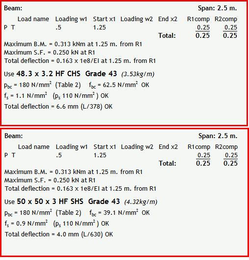

Does anyone know if tube is stronger than box section if used for supporting a load across a gap?
If for example I had some 50mmx50mm box 3mm thick, and some scaffold bar 49mm x 3mm thick which would be the strongest?
Im building a trestle table 8ft wide and looking for the horizontal bridge.
Cheers
