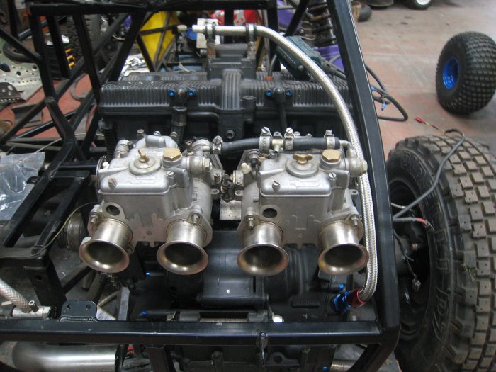

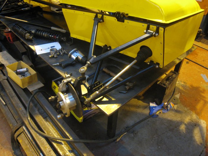

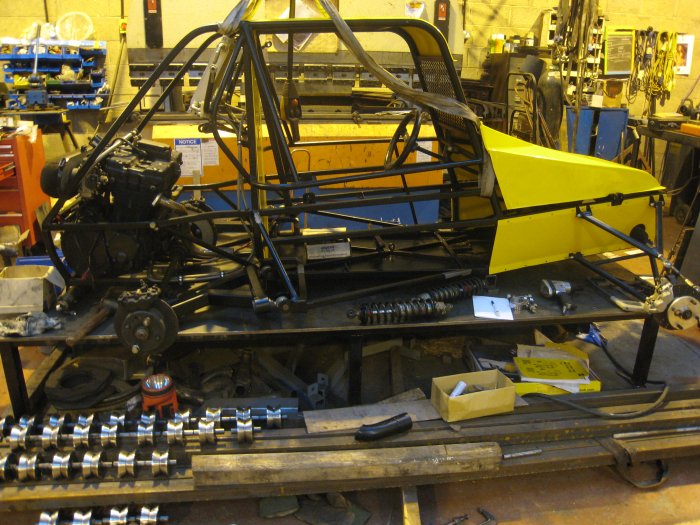

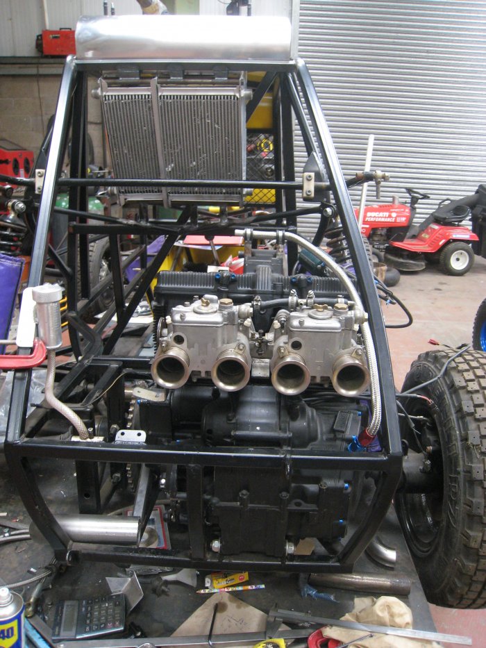

12.9 grade M10 allen bolt more than adequate pivoting on an oilite bush there will be two boses either side of the lever within the channel. The handbrake is only used for taking off from the start line e.g. keeping everything tight driveshafts and chain to prevent snach before launch the brakes will very rarley be used you scrub off speed sliding it through the bends p.s. remember Autocross is run in a field if the brakes fail just put it sideways.Nice shifter, I'm not an engineer but is a bolt a suitable pivot for the base of the brake lever - unsupported between bracket and handle?
Bandit motor should see 200hp with about 8psi. BUT that would be a bit crazy in a little buggy...
