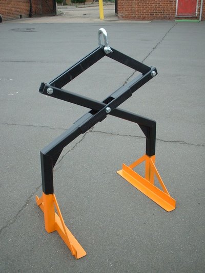

Todays little job, design and make a box lifter for a commercial vehicle spares warehouse, used with a crane, the clamps close on the box as the crane is raised and open when it comes back down to the ground, It will only be used for loads of up to 40kg, I tested it to 100kg, the customer has his own in house testing facility for LOLER compliance and will do the final certification.
