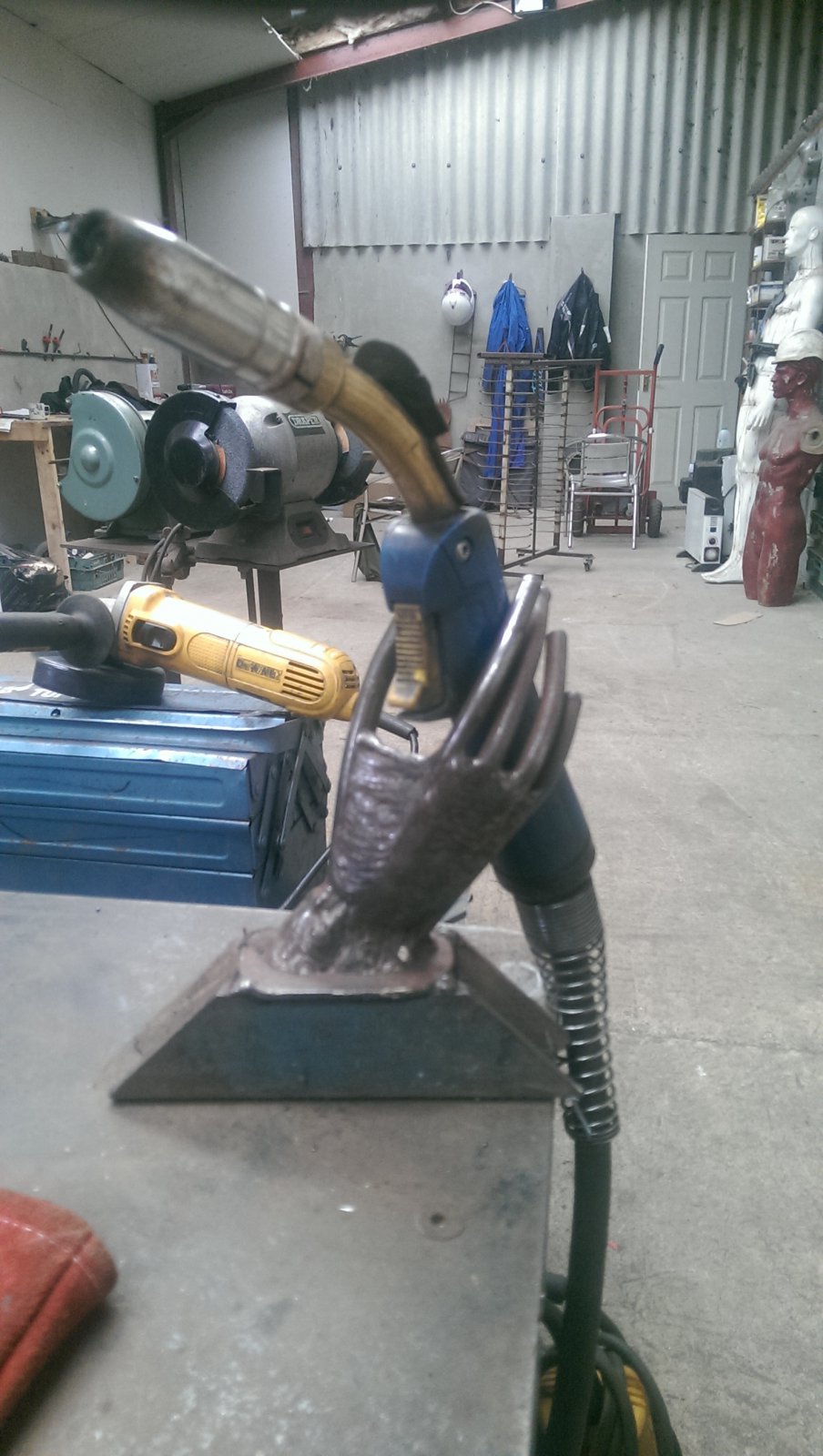

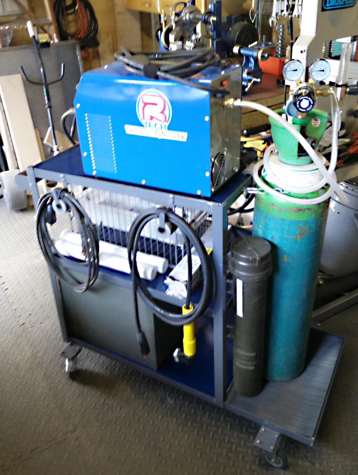

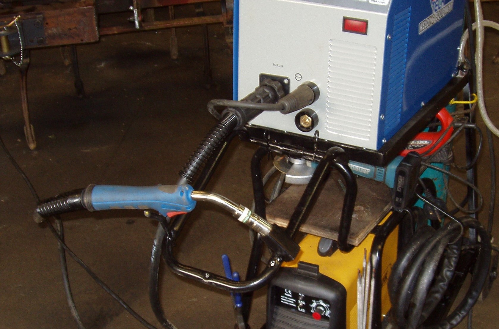

Hi is anyone ever made a spring loaded clamp / arm to hold the earth , mig torch and power cables to keep them from trailing the ground or do most folk just wrap them around the welder any pics would be appreciated .

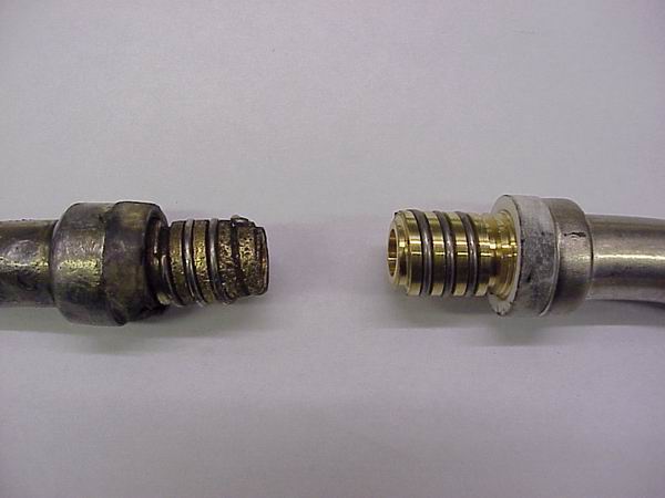

I wouldn't advise the "holster" style holder as the weight of the torch & harness hang on the shroud retaining spring area and can lead to this....
New one on the right

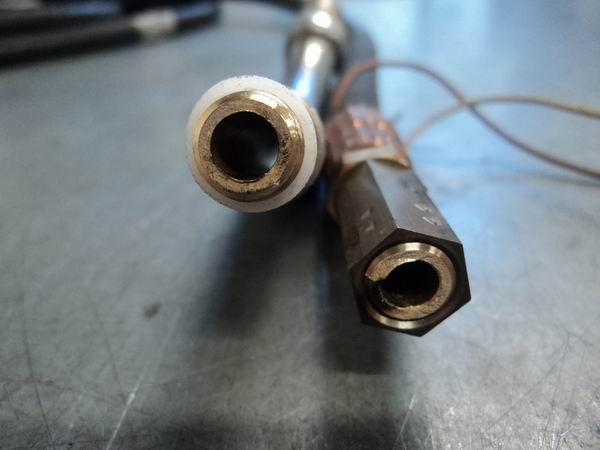

Or even worse....
When hung while hot the shroud gradually pulls to one side, then splatter enters between the spring and the insulator and gradually gets worse.Snapped I can understand but what's with the pitting on the brass bit the spring sits on?
If I'm missing the obvious it has been a 17 hour day.

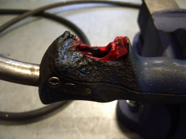

Probably ok for light Diy use but you won't believe the amount of damage production welders can do to a new torch a few weeks.
I had to repair the damage.
