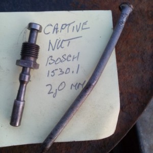

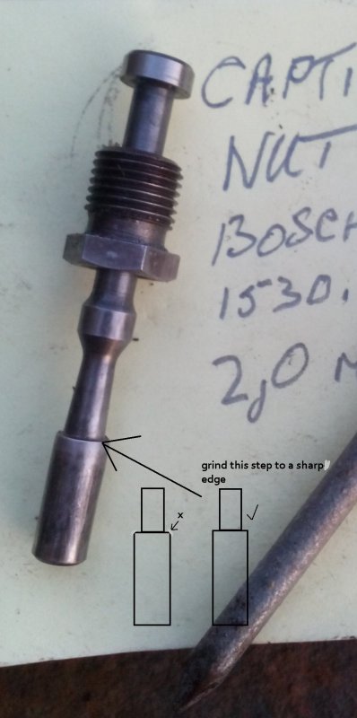

]Thanks Mike will give it a goAs a temp fix till you get one you could grind the corner back to a sharp edge where arrowed. That's what I did until I got a replacement (my Makita one did not have the captive nut)
Will do ThanksFenman, I have a Bosch nibbler (not sure of the model) but when i replaced the die pin it didn't come with a nut, but it was an extremely tight fit through the nut, worth checking.
Big thumbs up tapped it with BFH and out it came can now order new oneFenman, I have a Bosch nibbler (not sure of the model) but when i replaced the die pin it didn't come with a nut, but it was an extremely tight fit through the nut, worth checking.
tried it Mike still not cutting thanks anywayAs a temp fix till you get one you could grind the corner back to a sharp edge where arrowed. That's what I did until I got a replacement (my Makita one did not have the captive nut)
