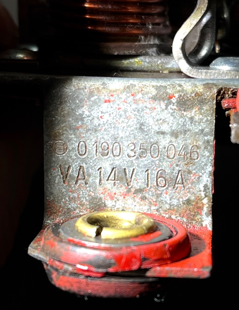

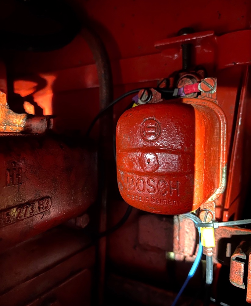

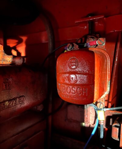

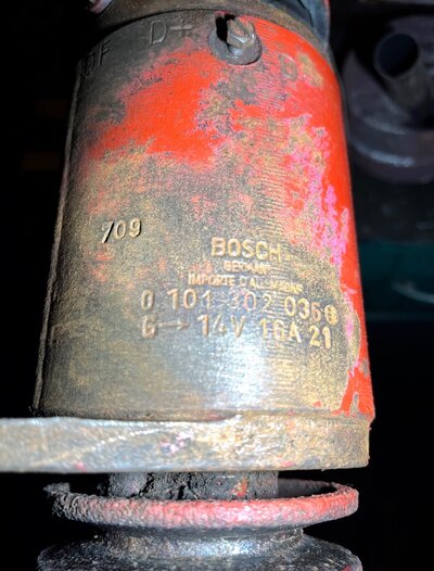

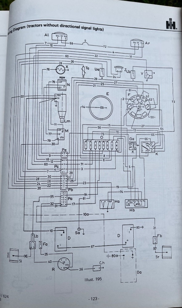

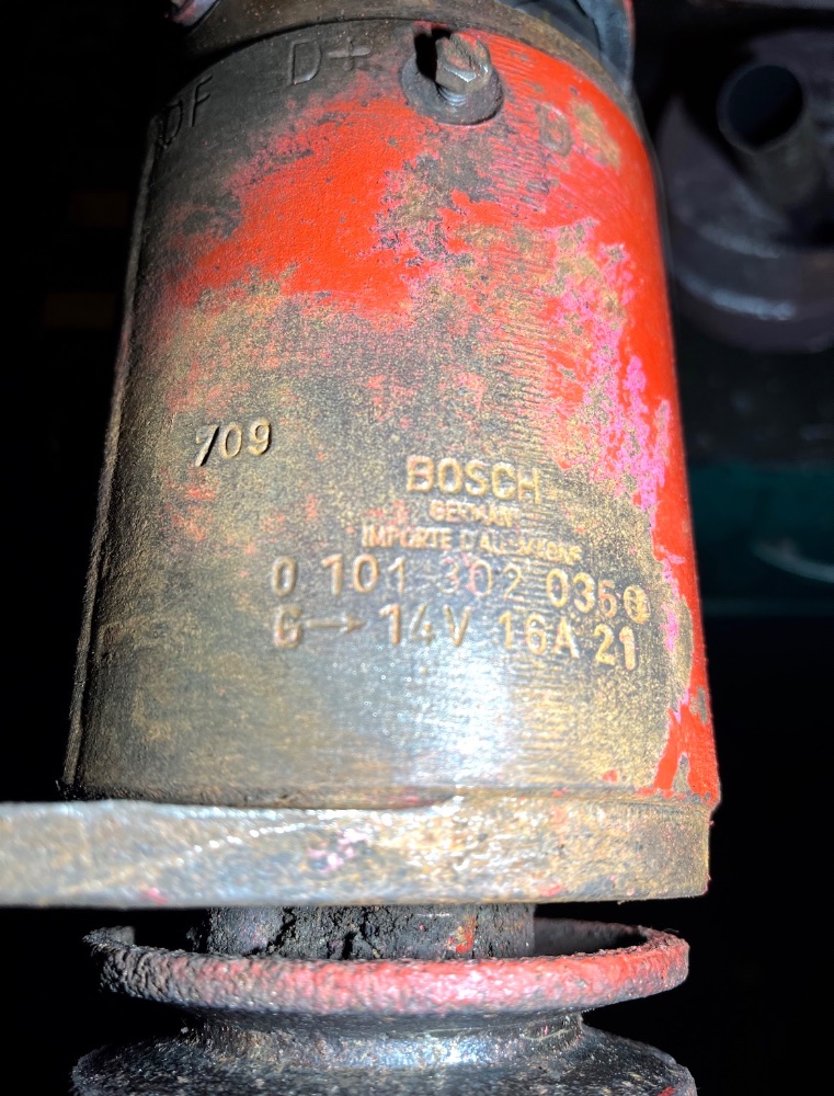

I have a 1968 International tractor. I rewired it a while back,for basic functions. The battery hadn’t charged for years.
The dynamo was stripped, cleaned and bearings renewed. The brushes have plenty of life on them and the commutator looks in good condition. I polarised it before refitting.

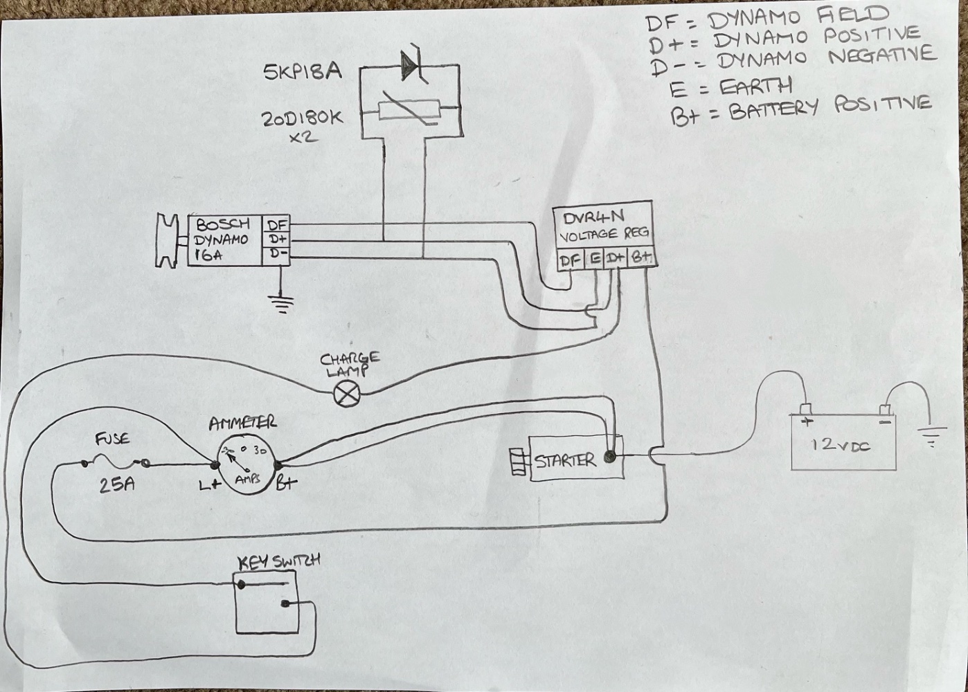

I’m struggling to get this new regulator to work. The battery is now overcharging.

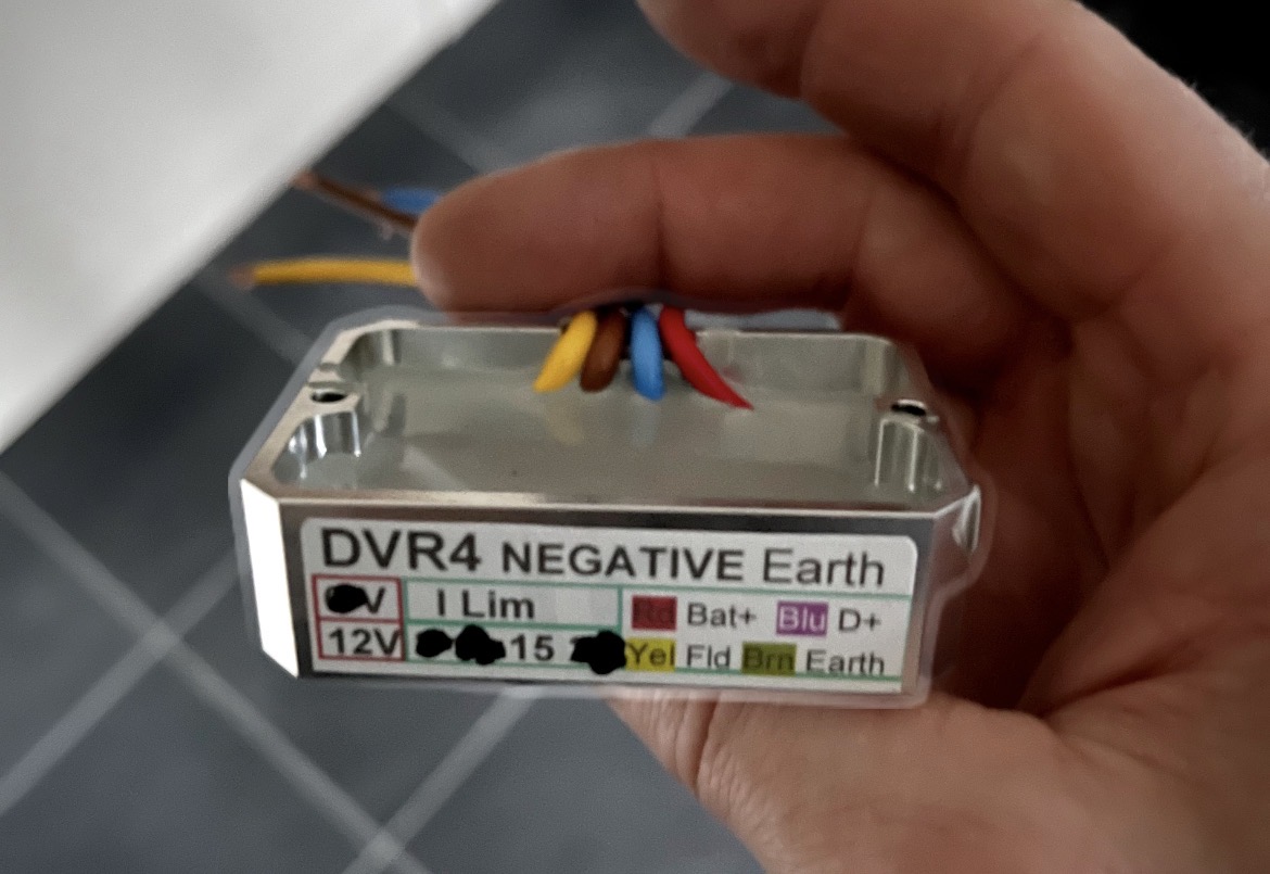

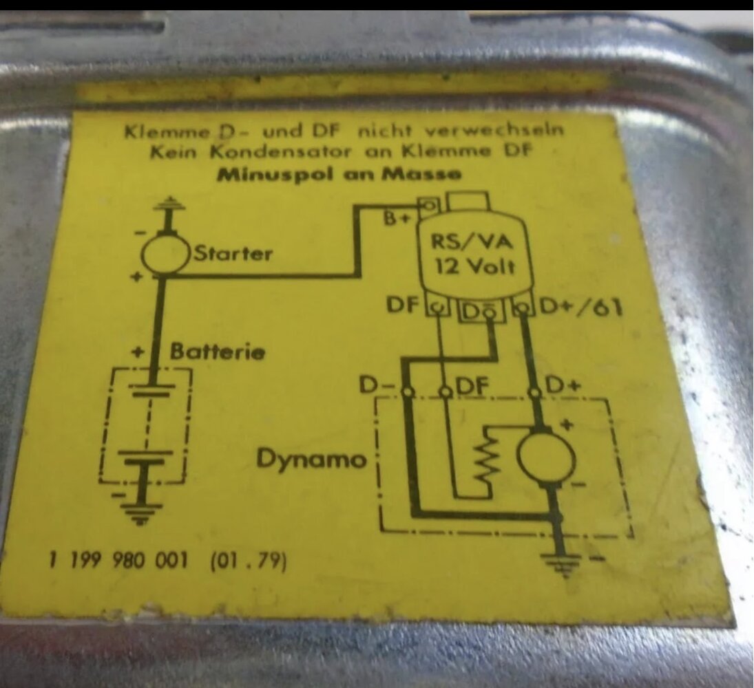

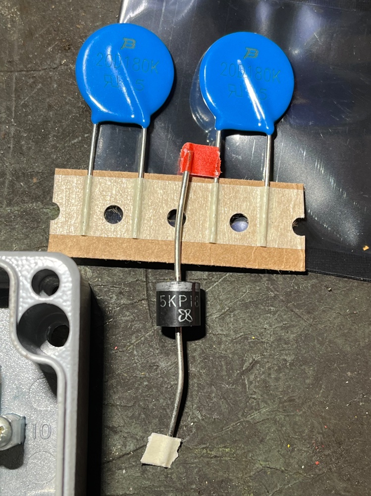

I bought a new DVR4N regulator, from Electrodynamic Solutions here in the UK. The old electromechanical regulator was worn out. As far as I can tell, I have it wired correctly, with good earths but I must be missing something as it still overcharges. Hoping someone may be able to help. Have hopefully attached original wiring diagram and pdf of new regulator information. Thanks.
