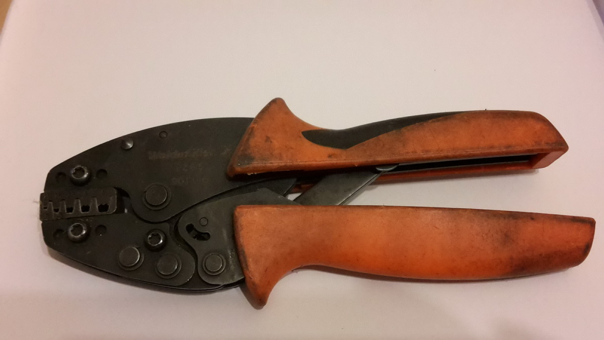

I just crip and then solder all connections.....a bit OCD eh....
planning on rewiring all my machine when they see the light of day again....
It may be OCD or it may he foolishness. Using solder inappropriately in a connection can make a poor connection which is prone to failure due to the 'cold flow' of solder.
