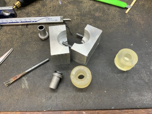

Any suggestion on what to use on steel to get a better bond with PU rubber.
Ive spoken to the suppliers and they have suggested either a Zylene prewash or Shellac.
One thing that will not be helping is I've shotblasted with glass bead and then heat treated leaving the surface of the insert smooth.
I have thought about causing the inserts to rust a little to give a better key.
Suggestions please
