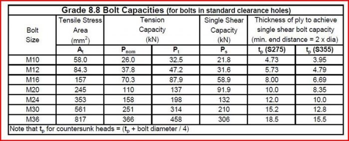

J Jake Member Messages 144 Mar 23, 2011 #1 Helllo all Do any of you megaa ppl know of a chart that shows the shear force. A range of grade 8.8 bolts can take. Thanks jake
Paul. Moderator Messages 7,017 Location Northampton. UK Mar 23, 2011 #2 This any good, bolt capacities are covered by BS5950, structural steelwork BS5950.jpg 61 KB · Views: 1,179
