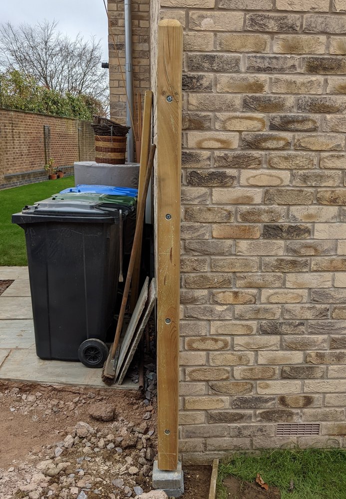

I know there are many posts about masonary fixings. I am seeking a little handhold before I ruin my 6-month-old brickwork.

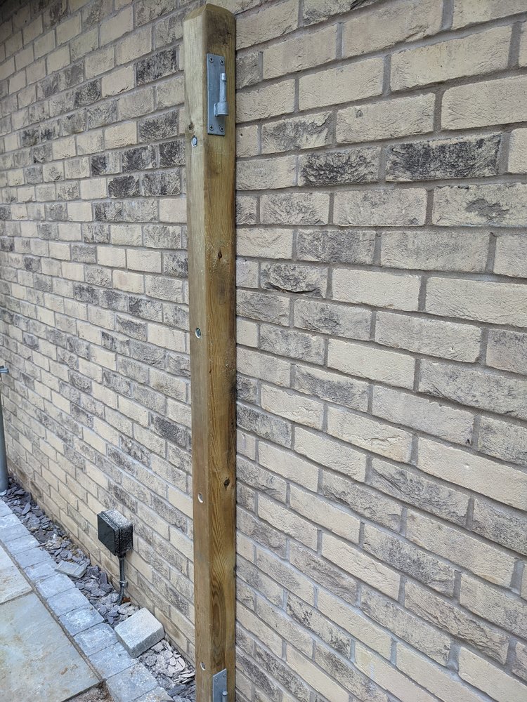

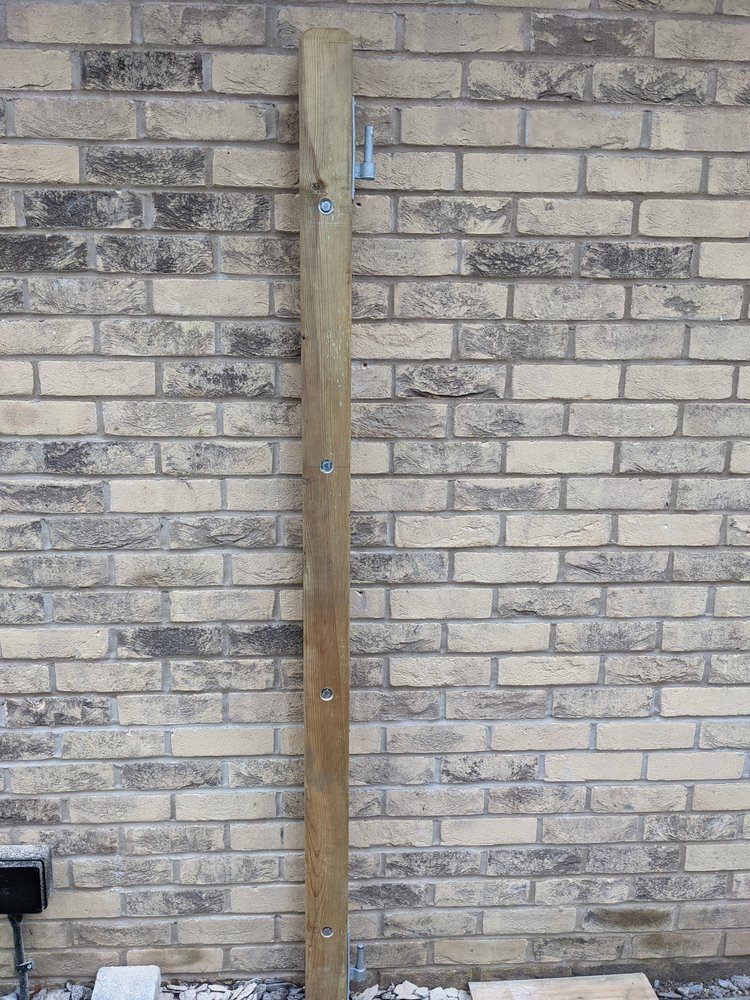

I want to relocate and fix two 90x90 fence posts to brick walls. They were originally attached using these countersunk Concrete Screws.
I want to use these Concrete Bolts as the countersunk screws have small heads and had just mashed their way halfway through the previous posts and still allowed considerable movement. So my thoughts ran to longer fixings and bigger heads to get a firmer hold.

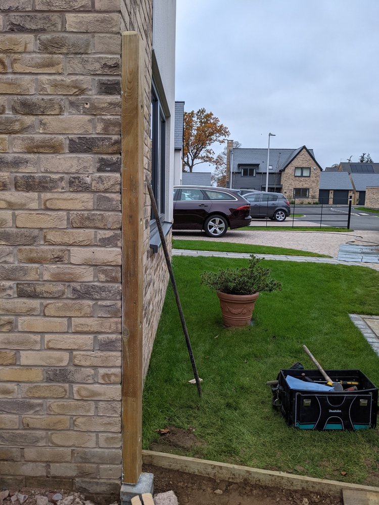

I want one of the posts to be attached to the corner of a wall. The holes will be only 45mm from the outer edge of the brickwork.
Assuming I carefully drill the holes straight and true what is the risk of splitting the brick when tightening the bolts (carefully!)?
