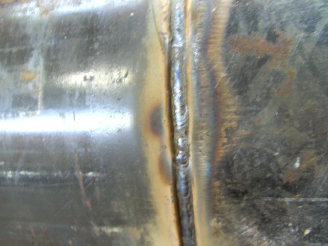

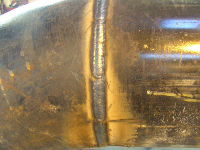

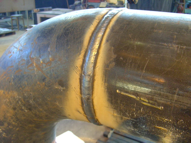

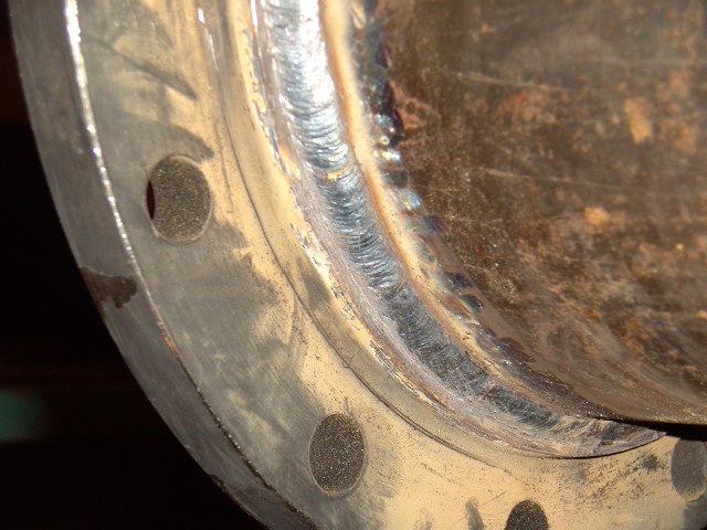

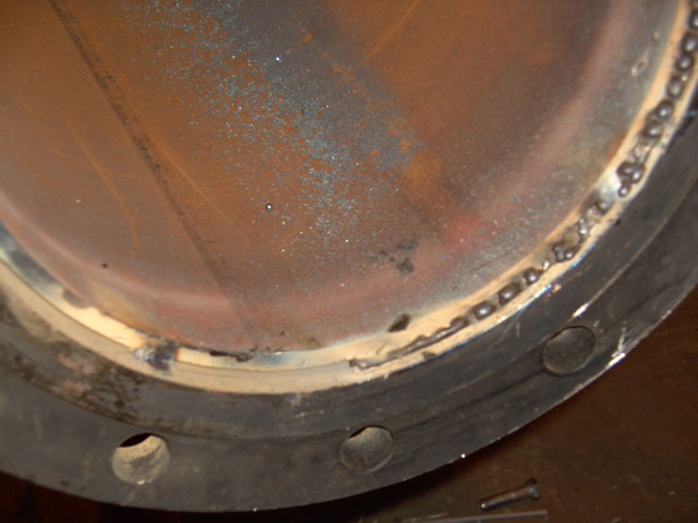

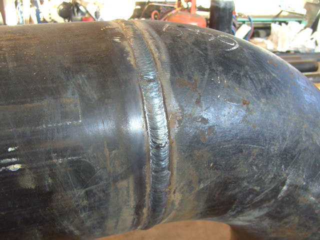

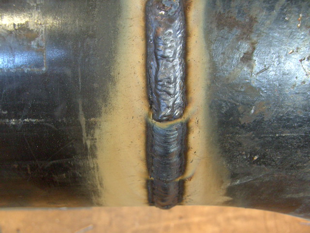

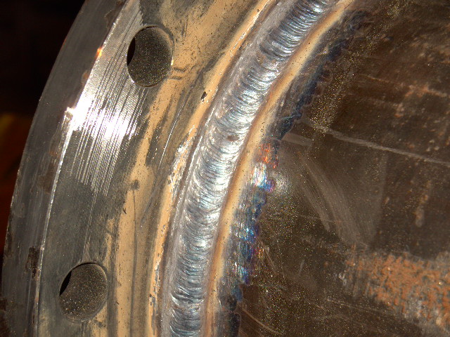

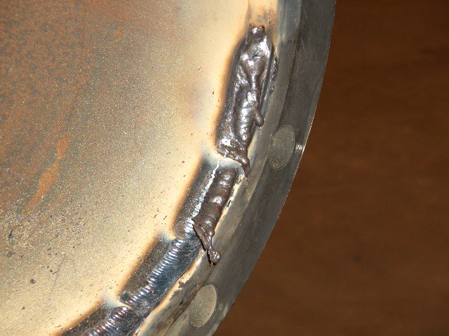

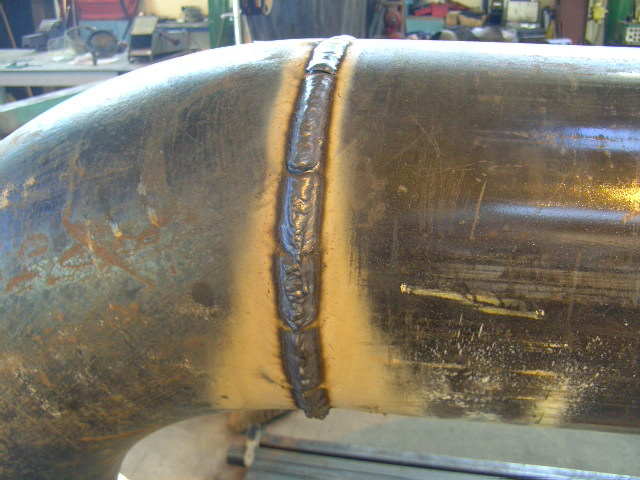

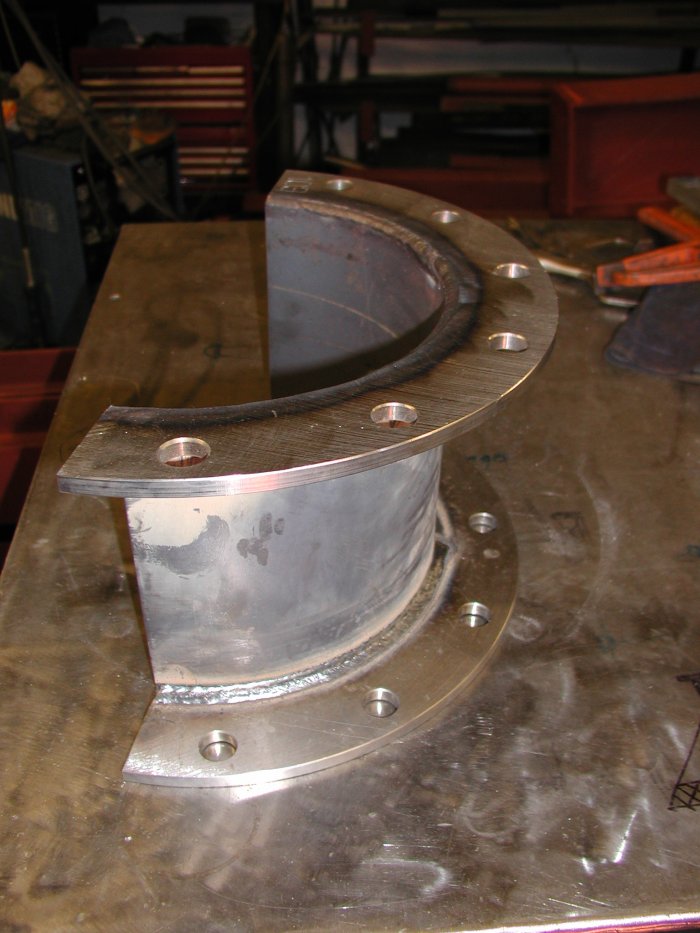

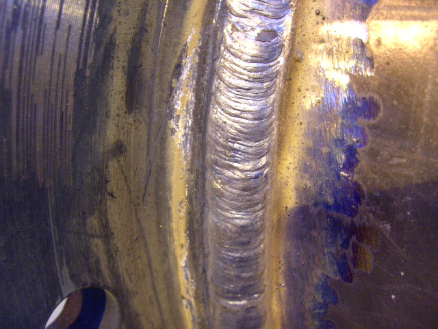

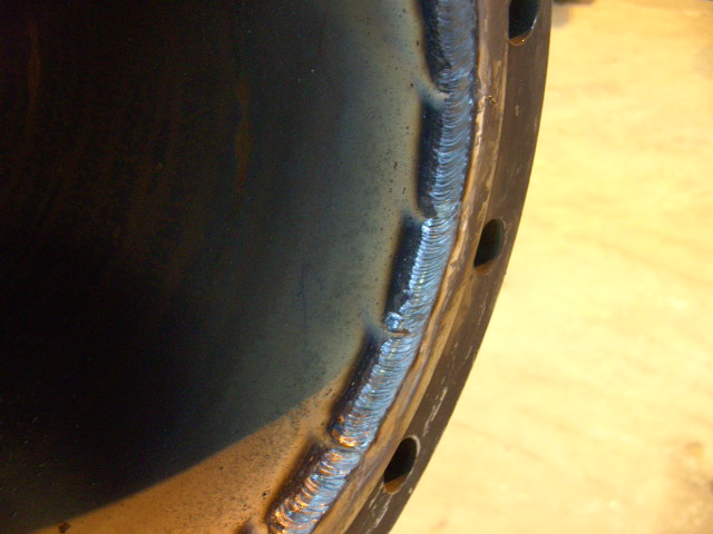

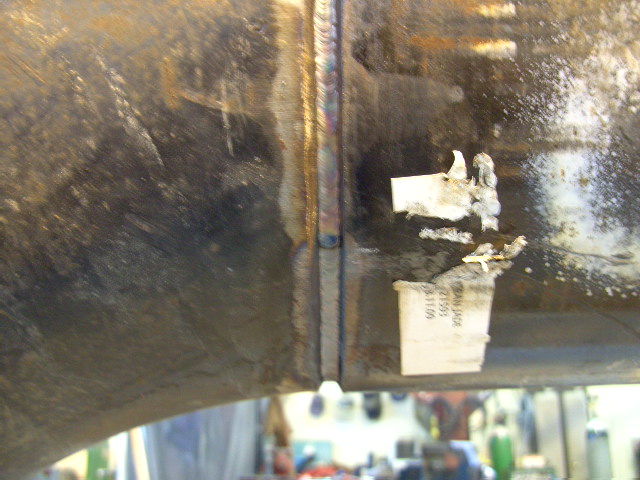

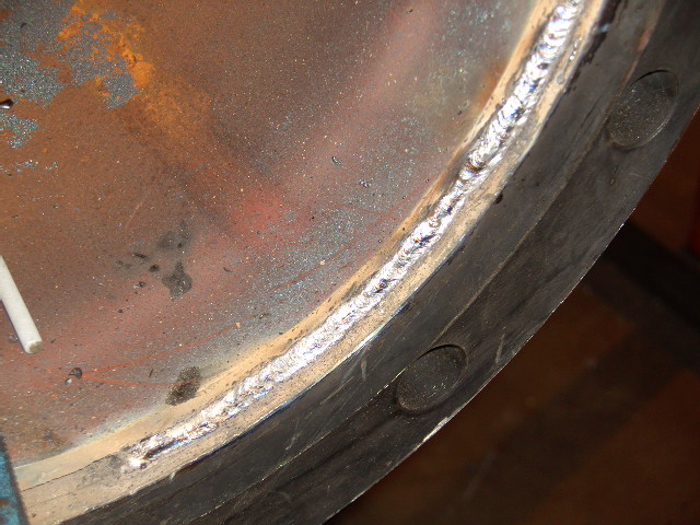

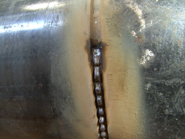

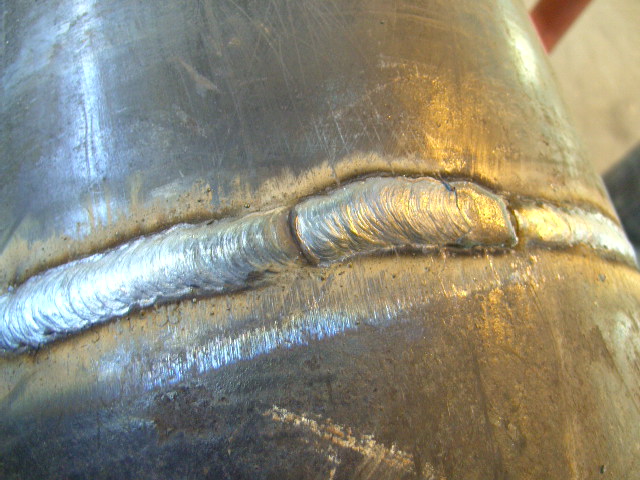

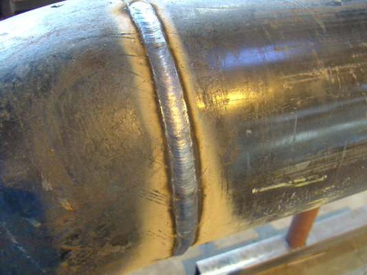

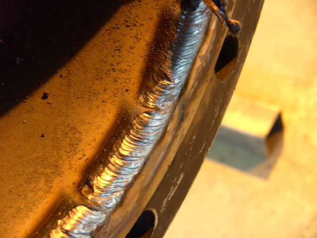

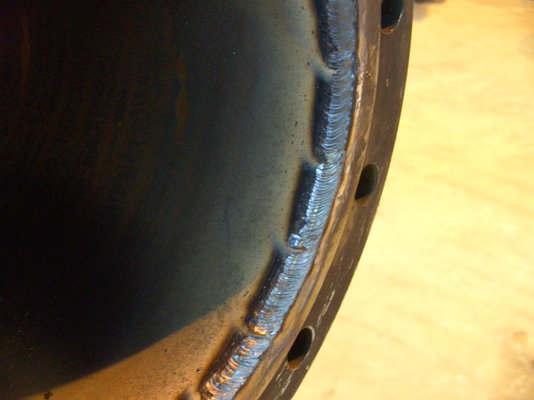

hi guys heres some pics i promised months and months ago
5G 12" pipe to elbow ,tig root 4mm gap feather edge 135amp,hot pas 2.5 ev50 90-100 amp fill/cap 125-130 amp.
12" pn16 flange rolled (welded at 3 oclock position)first pass ,3.2 ev 50 dragged at around 120 amp,second pass 3.2 ev 50 blocked out at around 130 amp.
the shocking stop/start on the top of the pipe is an example of how not to weld when you cant see the prep because your to lazy to put a new lens in your lid
jay
jay
