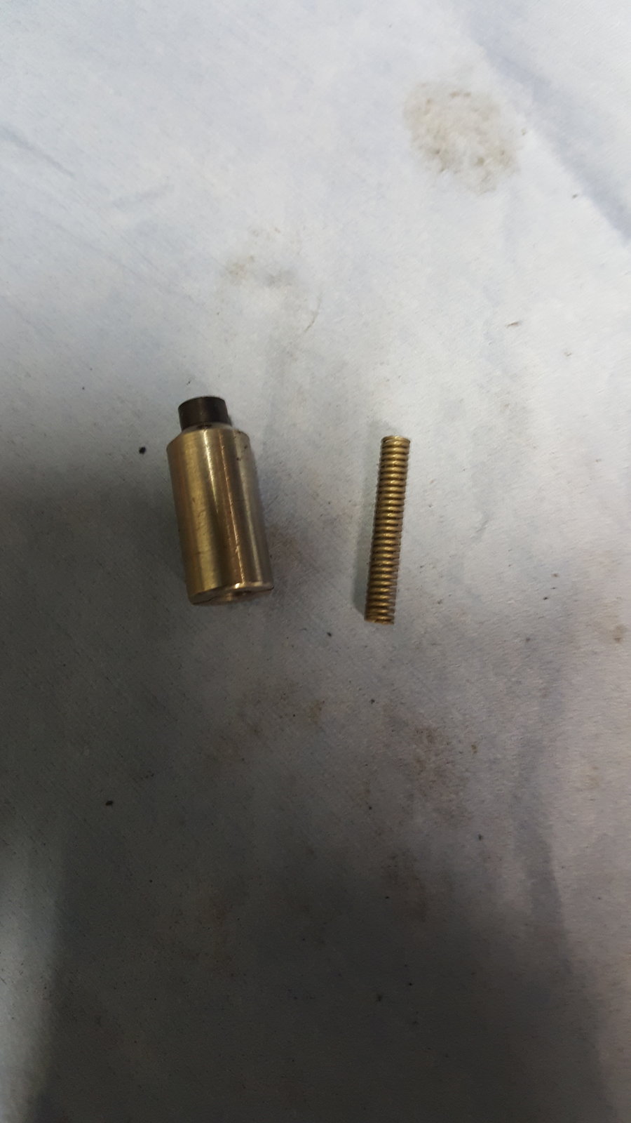

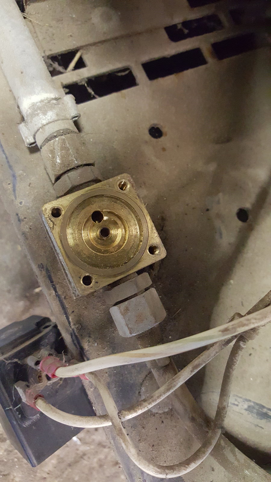

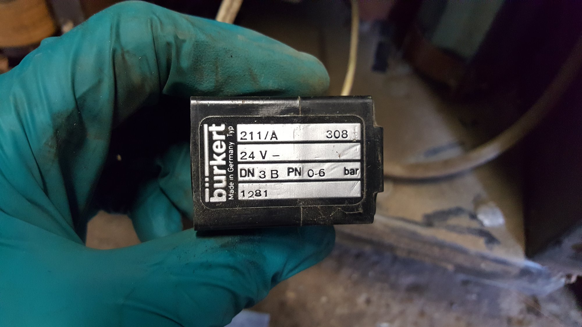

Stick a meter on the power connections of the valve and see if t's getting a "false" power on signal. If not then clean the seat and the rubber tip ,there will be a circular mark on the end that come from it seating on the hole and can fail to seal there ( a circular motion on a bit of wet and dry may freshen up the sealing surface).
