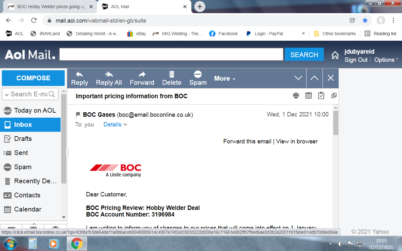

Just had an email from BOC saying the prices are going up again. Pure Argon is now £54.50+VAT=£65.40 rental and £55+charges+VAT=£74.50 (assuming the charges are the same as before).
Compared to Adam's Gas Pure Argon it now looks like this (litres per year assumes a BOC bottle is 4720 litres and an Adam's Gas one is 4000 litres (the table ignores the deposit as you get that back eventually):
I haven't compared with other suppliers like SGS as:
I think I'll be going back to rent free once I've finished the current bottle.
