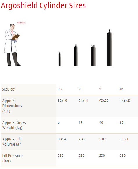

K kingchristo Member Messages 36 Location manchester Apr 28, 2017 #1 Hi I'm looking at getting a boc bottle currently I have a 10l hobby welding 5 what size is similar to this in the y x sizeing
skotl Forum Supporter Messages 10,394 Location Edinburgh, UK Apr 28, 2017 #2 (click pic for link to page) Note that the BOC hobbyweld offer is only for the Y size. You will literally spend more money on the (much smaller) PD or the X than you would with the Y.
