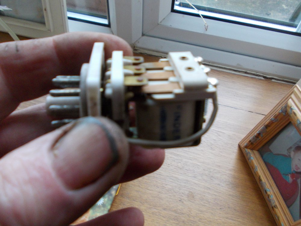

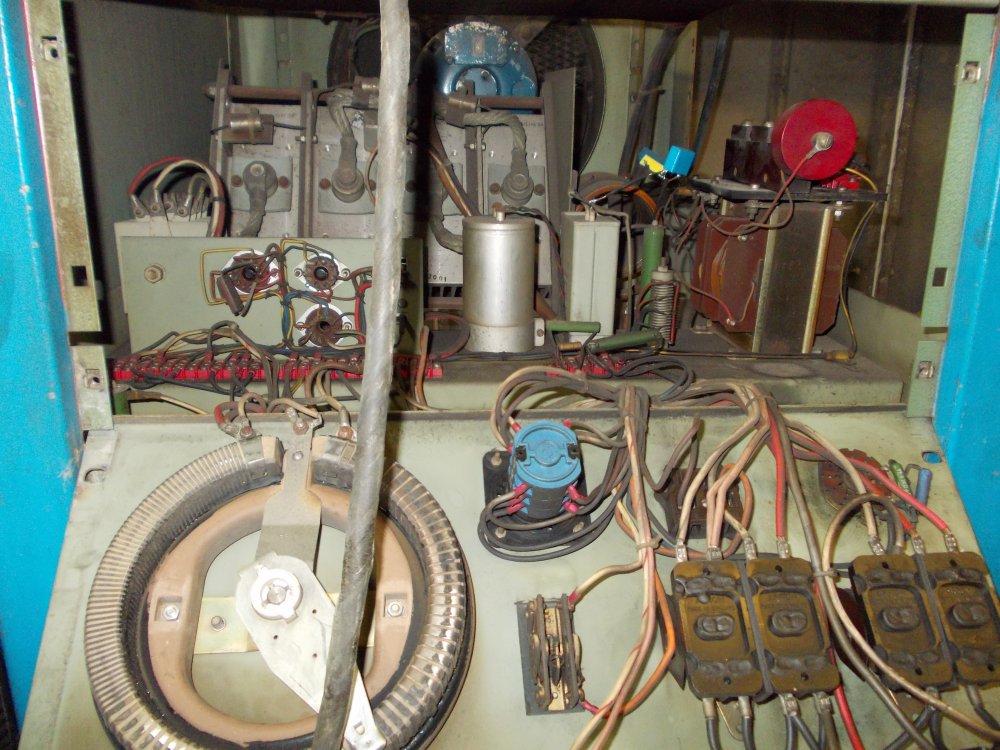

I HAVE BEEN CHASING A FAULT ON THE BIG TIG. THE FAN MOTOR WIRING INSULATION FAILED WITH OLD AGE. AND HAS SHORTED DOWN THE CONTROL CIRCUIT BLOWING THE COIL ON ONE OF THE RELAYS.
MANY THANKS TO DAVE CACKETT OF WOODFIELD WELDING FOR ALL THE EMAILS TRACING THE FAULT.
This machine would not look out of place on the original film of Flash Gordon i must admit i am a sparks by trade although some time ago now i always check twice it is switched of on the isolator before i put my hands in there LOL
New relay on order from RS £12 so pleased with that if it all works naturally.
