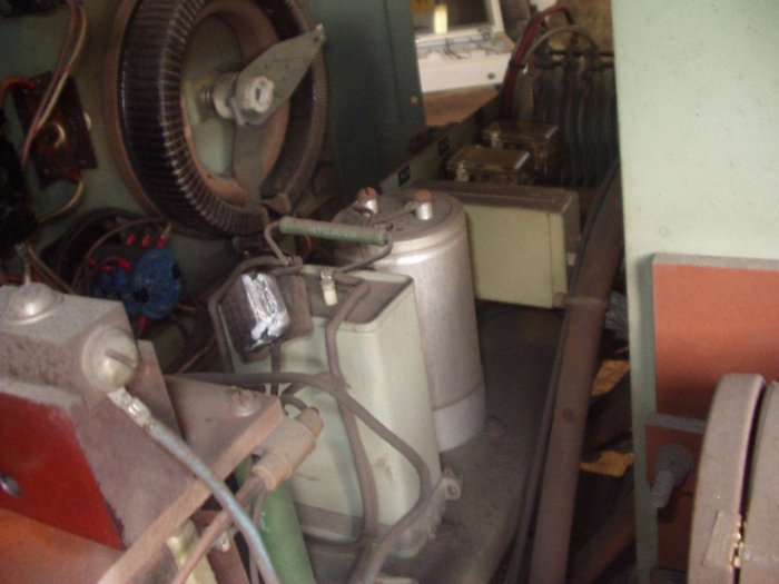

Well i have replaced the filter caps 1500pf and 750volts the old ones were blown as shown in my post with pics, the new ones are tiny and have blown on the first 15mins of welding any one know if there are better quality ones about andy b
I have checked the data sheet and they will do both ac/dc they look way to small for me but i know things have moved on with electronics as the ADR has none. the welder still works fine but i would like to know what is going on. also the water cooling system will turn up in a few days is it ok to use the welder for short periods as i need to practice never done this type of welding before that is tig on aluminium i have gas welded ali in the past. andy b
