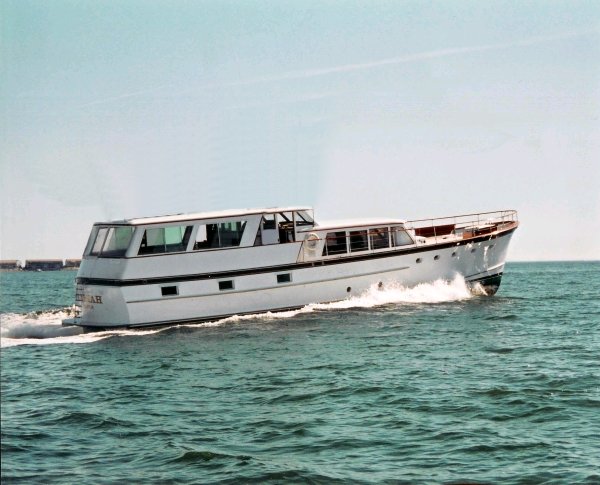

I've read here some very nice threads the last 4 months, so decided to join.
Building a river/canal boat at own design in aluminium 4 by 12,7 m
plates 8 - 5 mm, 5083
profiles T mostly from 40x40x4 - 80x80x7 6060 and 6082
Welder Castolin / Fronius 270 Amps, pulsed, wire 1,2 mm, 5083, Argon
my homepage is written in german only, but if any questions, i would translate.
a page with welding samples the try and error you may find here
a collection of images, roughly in order of building here
I would be interested in hints and experiences in welding the 5083 alloy.
Hello to all, Klaus
